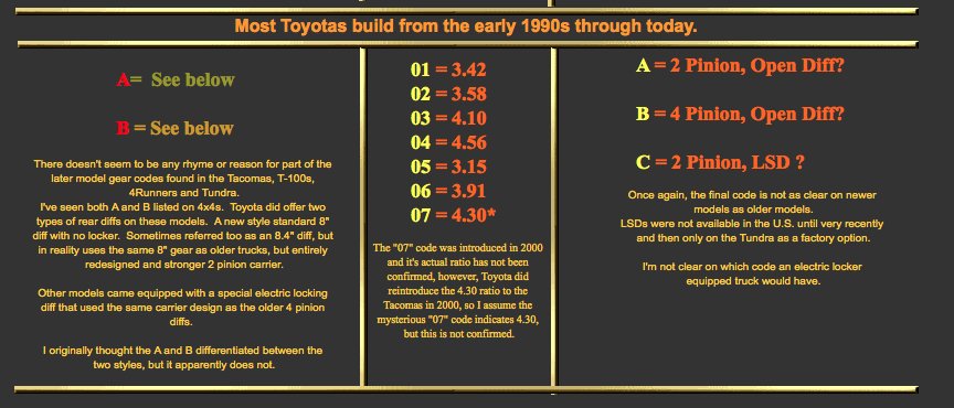

    Oh and my stock gearing is 3.41 iirc. It's 3.4 something lol.

    no way man. no 4wd taco came with that tall a ratio. your most certainly 4.10s.
    the 2.7L slow bangers with the slush box trannies did in fact come with 4.56s. 2.7L slow bangers with manual came with 4.30s.
    4.56 on a V6 with manual tranny and 33s is about stock, 4.10s and 31s. 4.88s will be a bit over geared.
    I love being over geared now.

    I'm calling you on this BS... :luvya: My truck has axle code 01 which according to 4x4wire's image I stole (hosted on my photobucket) indicates I have 3.42 stock gearing. My truck NEVER came stock with 31's. I bought it with 31's when it had 160,XXX miles on it. It isn't a TRD, its a plain manual everything truck.
