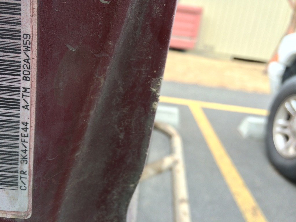

    And I looked at the diff code and it's 3.58, so I was partially wrong.

    Alright. That's better. And also shitty for you haha

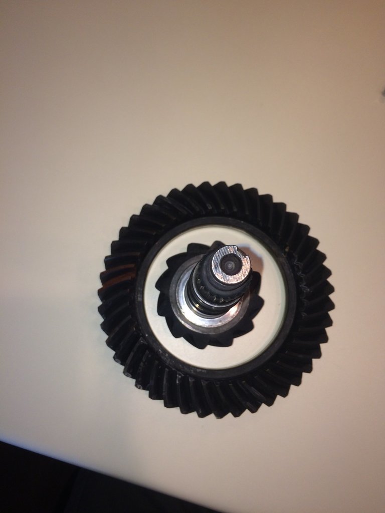

    Not really, 4.56's are getting installed Monday... That should be enough to get it back in line.

    So 4.56 for a manual with 33s and 4.88 for an auto with 33s? Is that what people are recommending?

    Yes it will. Immensely.
    Yes.

    Correct.

    It's less Tacoma and more mod
    B02A is 3.73s.... B01A (what I have) is 3.58s

    Correct sir. Lines up with my sheet anyways.

    The shop is a little behind but they told me about 3 days for rear ARB, nitro 4.56 and new wheel and axle bearings all around in addition to new seals everywhere.

    Just payed the shop. I didn't have them change the front wheel bearings because they were still in good shape upon inspection...
    Rear: New brake shoes, new seals, all new bearings, gears, ARB locker,
    Front: new diff bearings, seals, gears...
    Think that's it, but looks like my transfer case needs help. It seems to be popping the chain. Too much :burnrubber: in 4wd maybe? :laughing:

    Young's Gear install my Nitro 4.56 gears front and rear with my rear ARB airlocker. They also changed the rear wheel and axle bearings, threw on some new brake shoes, but the really messed up the brakes and when I picked the truck up yesterday the e-brake handle wasn't doing anything, even after I fully adjusted the adjuster nuts under the cab and it felt like they hadn't been bled properly. Not so happy with them since they took 4 extra work days and a weekend to do the job.
    Anyways, the gear ratio feels amazing! I'm so glad I went with the 4.56's for my current 33's. I might have to ditch my winter 31's now...

    So the way I do math 43/12=3.583333333. So I was right.
