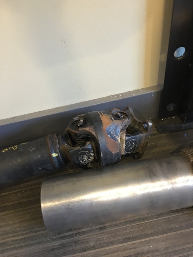

    First part waiting for me. ba124edee9606d5113b32bc34cb5ea32_225f1edae91169f011ae9a27e6085231b7f6e1b0.jpg

    It's less Tacoma and more mod
    Looks like it's gonna be fun!

    So stoked. It's gonna look tiny on 33's for a little bit though!
