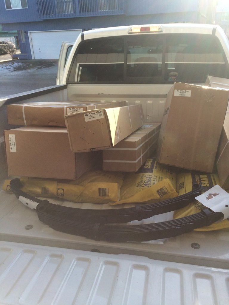

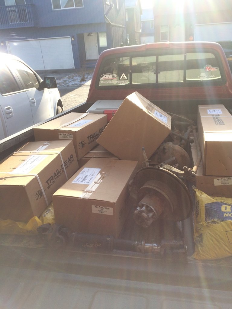

    Parts came in!

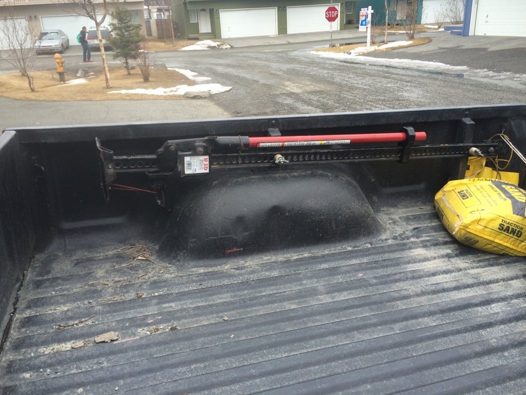

    Unrelated to SAS but cleaned my hi-lift a little and finally got a handle isolater. b81f83d337d7c11a1b14abb4e0810e77_25a27340e247c8cc827ddc2478c4acb247e00131.jpg
