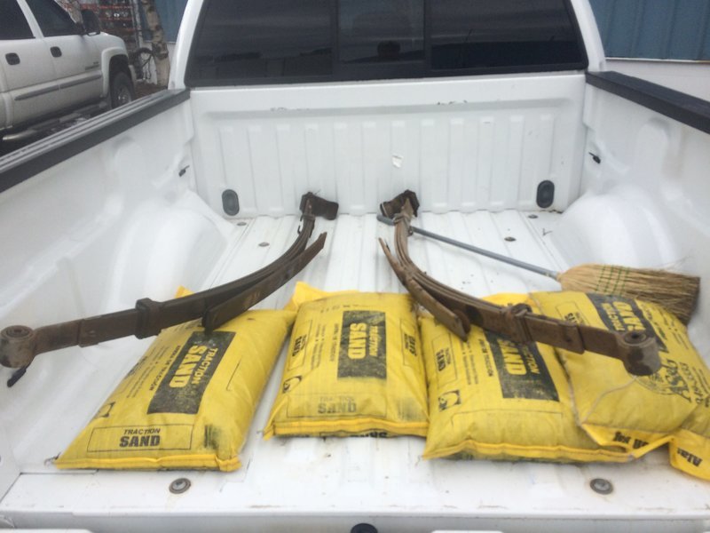

    And picked up some 63" Chevy leaf springs.
    These are going to need some good cleaning and paint before they go on.
    I went to go pull a pair from the yard that looked a little better than these ones and after I got under to unbolt them I realized that one side had a leaf pack like these (3+1) and the other side had a 4+1 leaf pack. It confused the heck out of me for a minute and I swore I couldn't count. Maybe chevy struggles with leaning to one side too? :laughing:

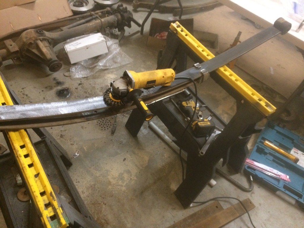

  4. Apr 1, 2016 at 11:03 PM
    #564
    SnowroxKT
    SnowroxKT [OP] Well-Known Member
    Dec 11, 2011
    #68604
    5,319
    Kyle
    Anchorage Alaska
    2008 TRD OR
    Started cleaning up the 63's tonight have a long ways to go, but it's a start. The leaves seem to still have a good arc to them and are cleaning up well.

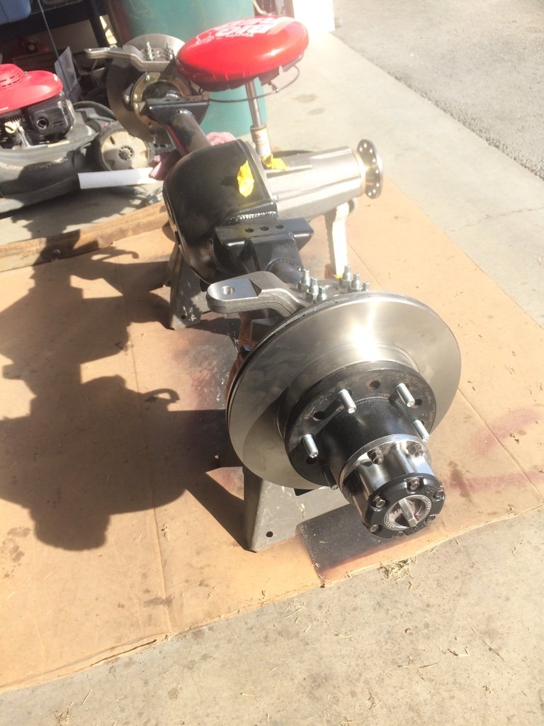

  5. Apr 12, 2016 at 5:58 PM
    #565
    SnowroxKT
    Dec 11, 2011
    #68604
    5,319
    Kyle
    Anchorage Alaska
    2008 TRD OR
    Aaaaaand the axle is getting close to done. Need to adjust steering stops and get the brake calipers on.

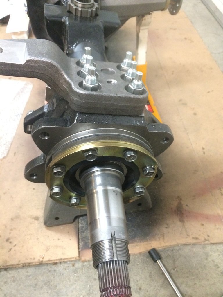

  8. Apr 18, 2016 at 8:50 AM
    #568
    slander
    slander Honorary Crawl Boi
    May 10, 2013
    #103909
    8,964
    Hickory, NC
    02 Tacoma, fixed with curse words.
    Do they fit and spin nice now?
    I like toyota axles, but man are they a PITA to service and inspect as opposed to an open knuckle design.
  9. Apr 18, 2016 at 11:04 AM
    #569
    SnowroxKT
    Dec 11, 2011
    #68604
    5,319
    Kyle
    Anchorage Alaska
    2008 TRD OR
    Yeah they spin really nice now! What a PITA though. Why can't someone design a slightly different setup so not to paint, check, grind 5 times a side (I guess other axles do just that). Before it was spin, clunk, spin when wheels were straight, but when at sharper turning angles I couldn't even spin the rotor on one side.
    Regarding setting steering stops:
    I upgraded to the Trail Safe knuckle ball wiper seals so I just set the steering stops when the seals contact the non curved part of the knuckle ball?

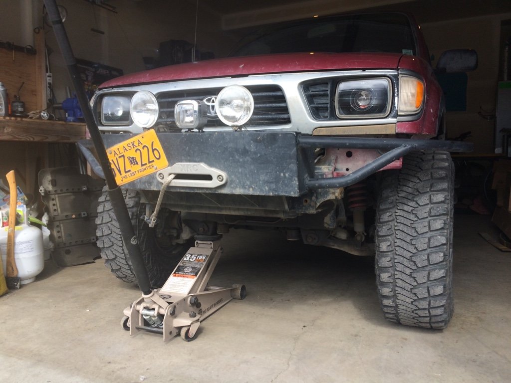

    5,319
    Kyle
    Anchorage Alaska
    2008 TRD OR
    No going back now!b436a8ae025e37a4595b4b1a2bec4f60_639586f84b4b35d7eedb41350f9788fcf10fd657.jpg

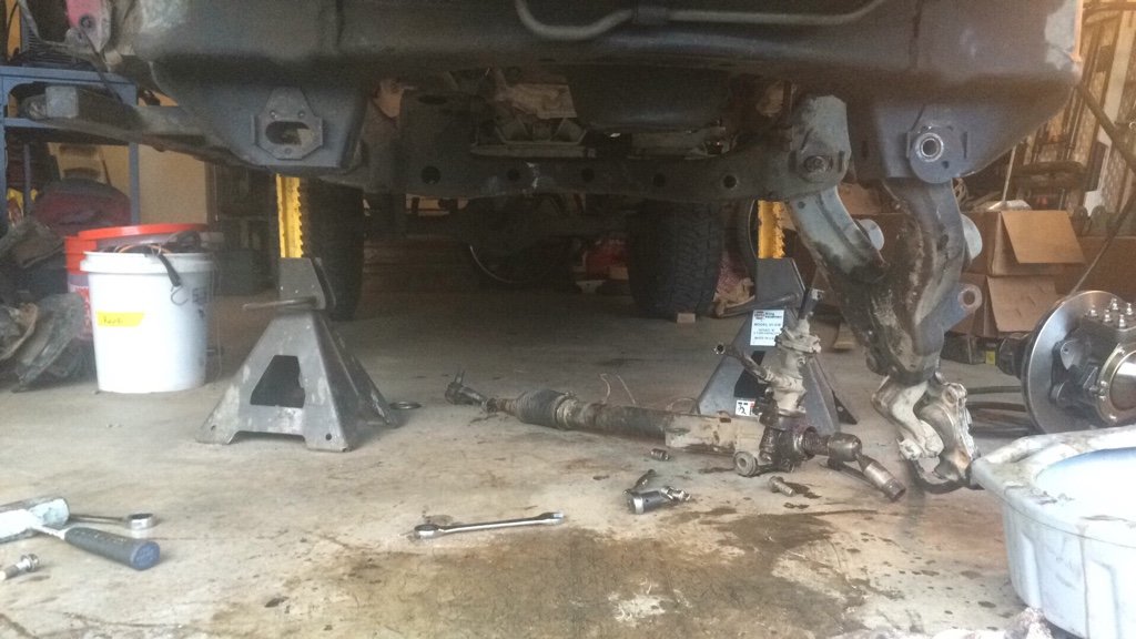

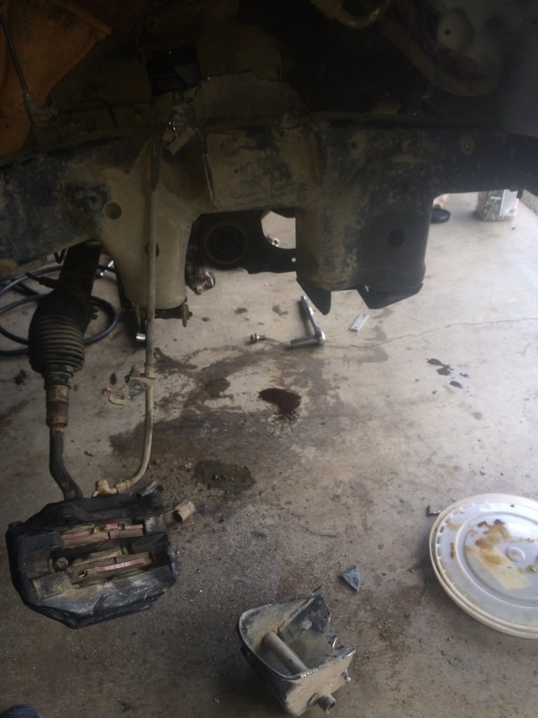

  18. Apr 29, 2016 at 10:56 PM
    #578
    SnowroxKT
    Dec 11, 2011
    #68604
    5,319

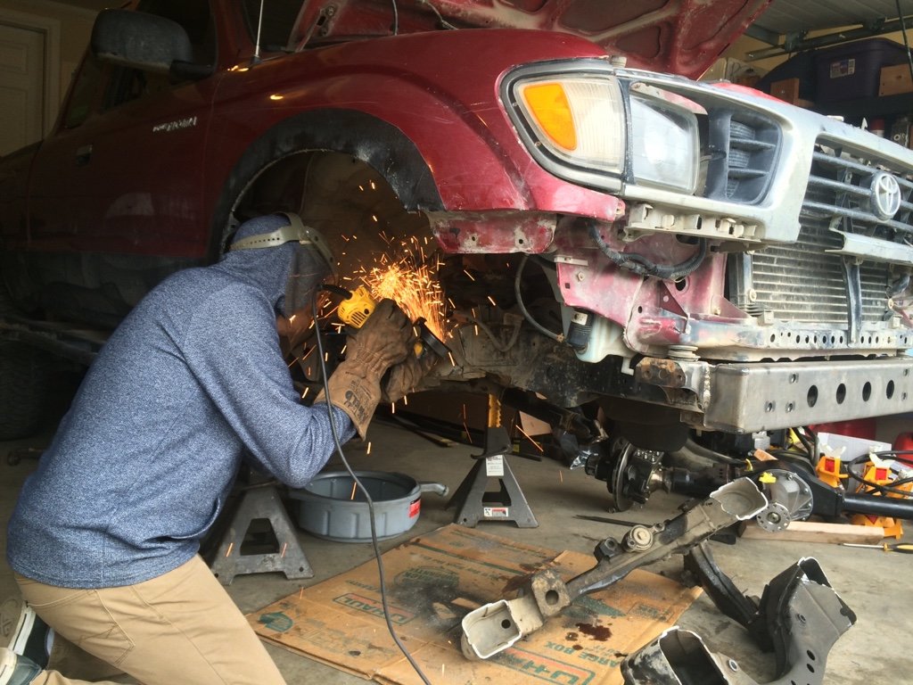

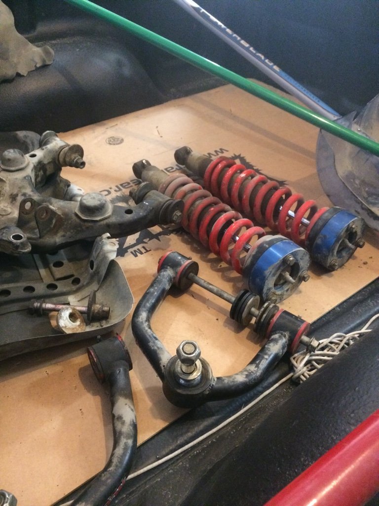

    Kyle
    Anchorage Alaska
    2008 TRD OR
    For tonight I got all IFS out except the driver LCA, but who cares I'll cut the brackets out tomorrow.
    Rack removed and looks pretty good, both inner tie rods were significantly worn though.
    Front Diff removed and the oil was still looking like new. Looking to sell that one, fresh 4.56 gears installed about 15 months ago.
    And some pics I took.

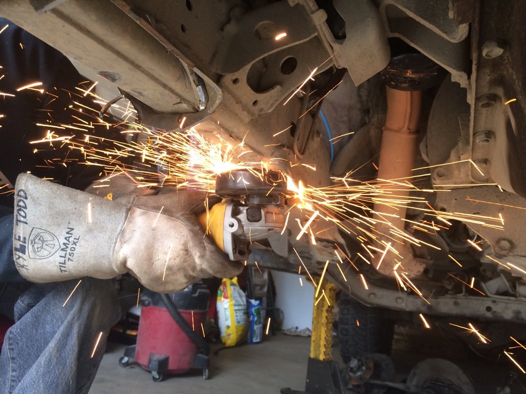

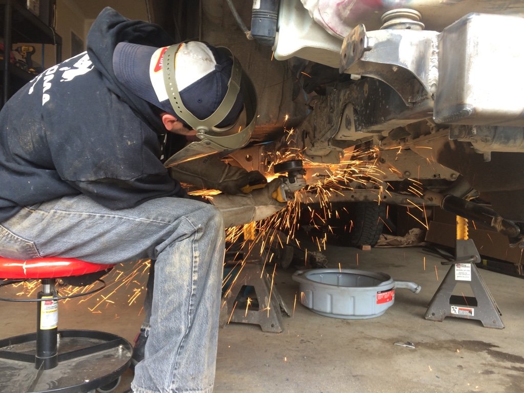

    Kyle
    Anchorage Alaska
    2008 TRD OR
    Made some progress this morning.

    Las Vegas, NV
    2001 Toyota Tacoma TRD
    Your dedicated doing all that with an angle grinder. :bowdown:
