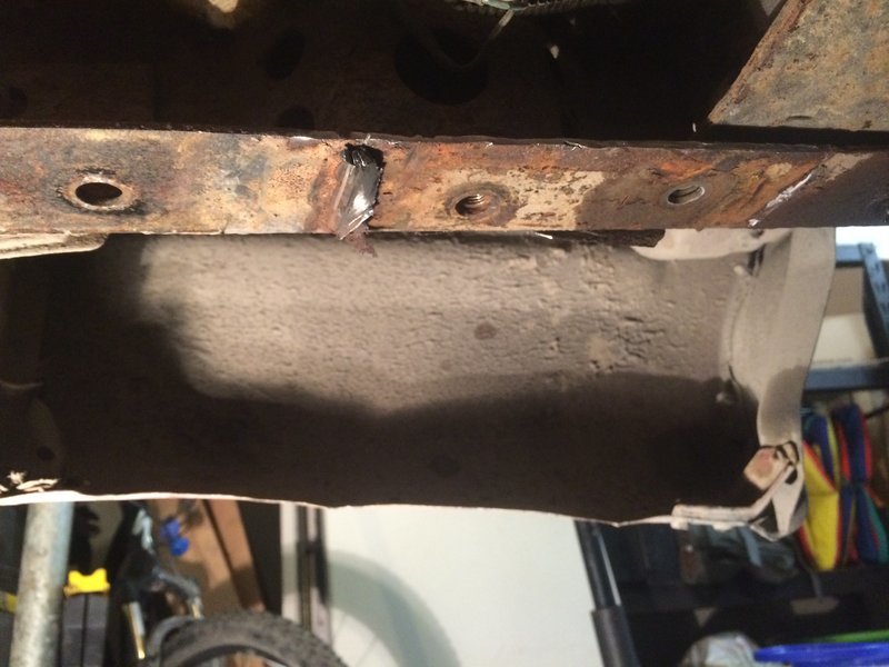

    Shock hoops welded, need to gusset them. Stripped a power steering part so I'll have to get a new one, hopefully that'll be cheap.

    Leaf Spring SAS? You mean the lazy SAS :p
    jk looks good!

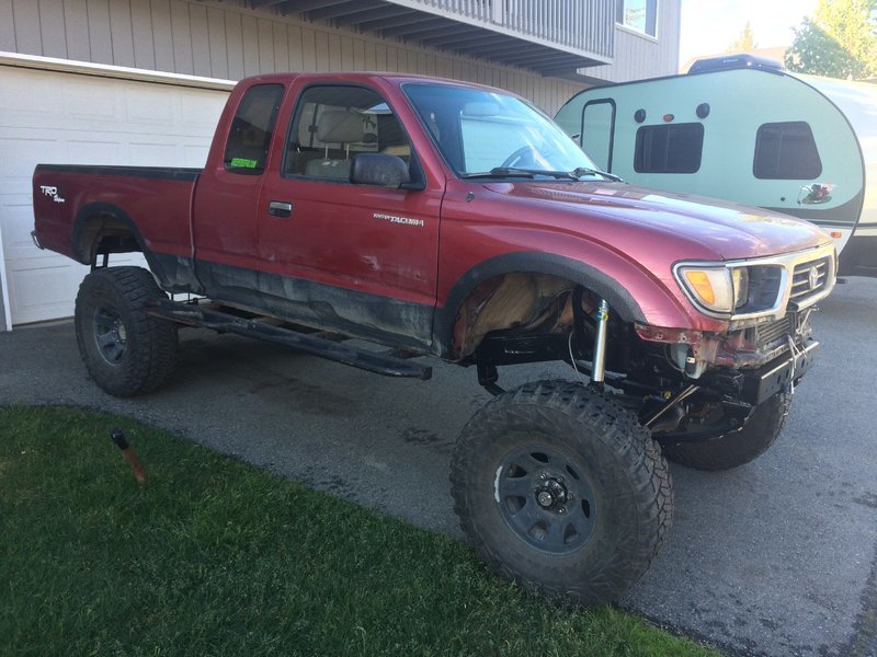

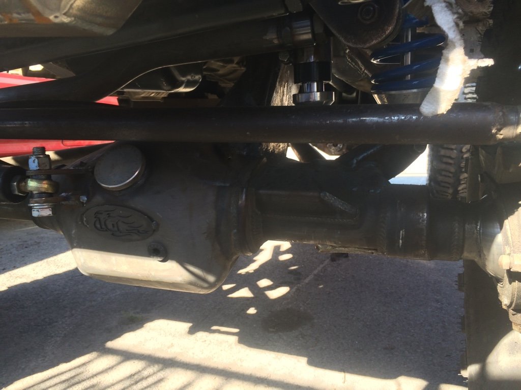

    Here's some pics of the truck I mentioned the other day.

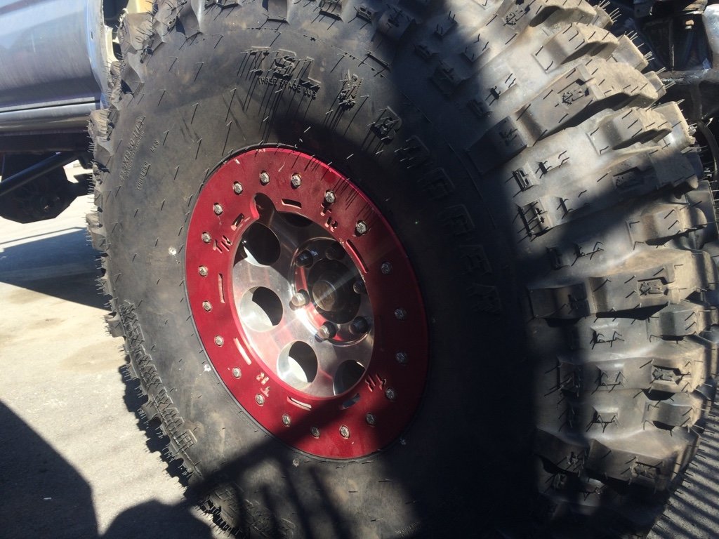

    Never gonna finish this trash pile...
    Any hints on how to get the transfer case front shaft out to replace a leaking seal? Ain't having any luck yet.
    Some pics of work tonight.
    It's horribly swuating right now but these 63's should give me some decent lift.

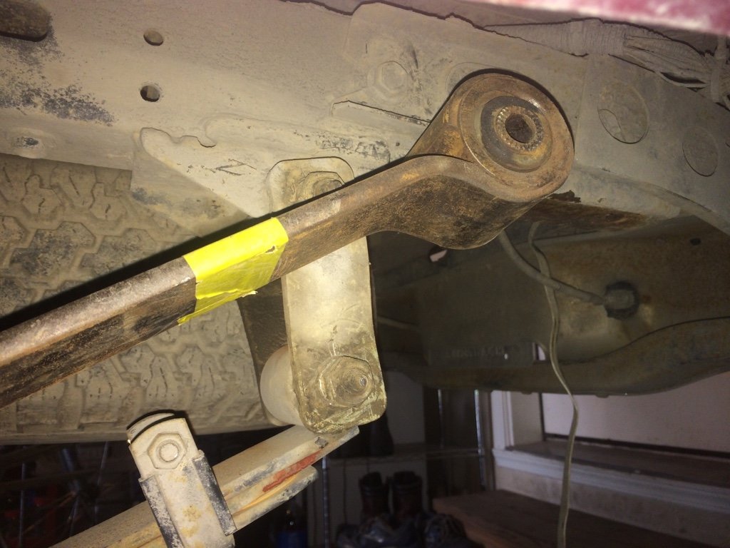

    Last night I cleaned up the Chevy 63's and painted them. Tonight I am hoping to tack the spring hangers in and check for lift, shackle angle and the lot. Getting the old Chevy bushing out of the spring eyes was a chore, once I found the perfectly sized drill bit those came right out though.

    Did this for the rear shackle hangers. I will clean it up tomorrow and *MAYBE* even tack the rear suspension in.

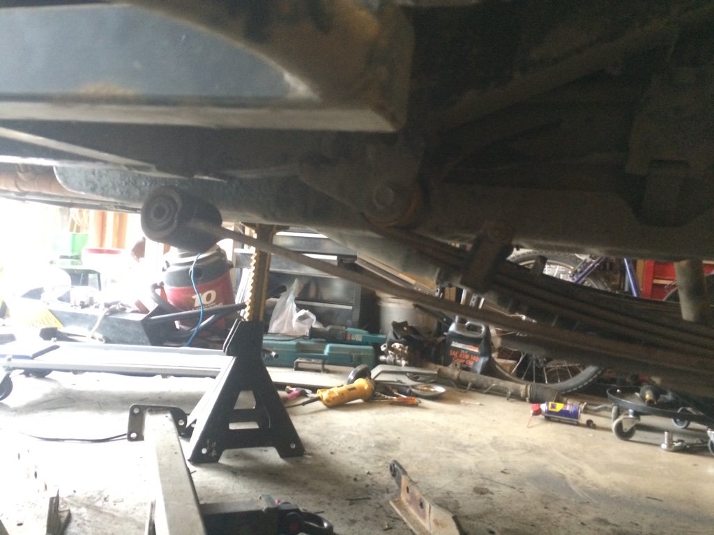

    Boring update, the front suspension is done, rear springs are done (need paint), gotta fill the T-Case with oil, then remove stock transmission T-Case and replace with Trail Gear one so I can install my front driveline. Then throw some bump stops in. Then I can wheel her!

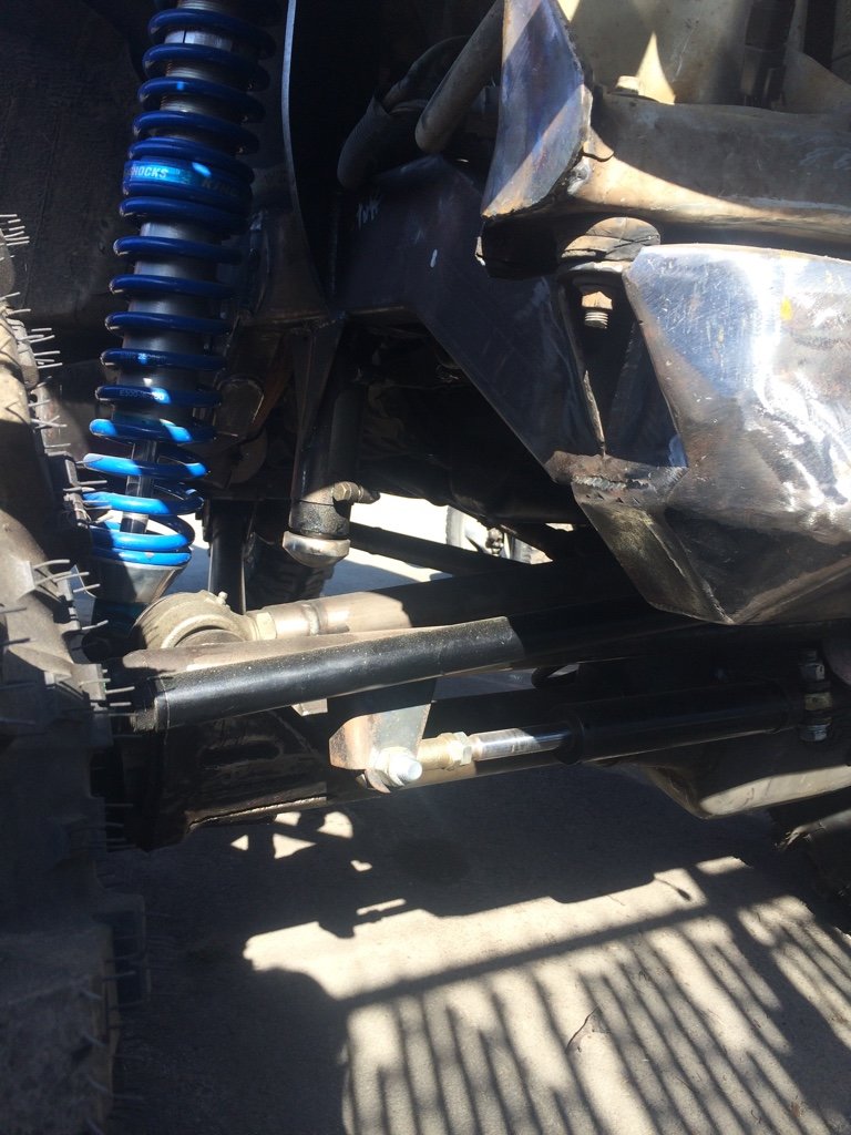

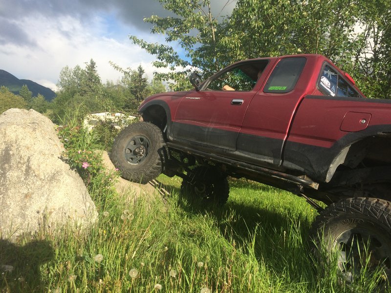

    Got her up and driving! Still need to swap out the front crossmember and install front driveline and rear shocks are the big ones. image.jpg image.jpg

    Nice job! Looks real good.

    Sickkkk!
