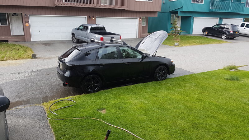

    This build sucks!

    Why it no run?

    A mechanic friend with a $500 scan tool came over and we got this thing running, turned out to be a bad MAF, the readings were jumping ALL around, reading about .6 V at idle, then when I held the throttle at 1200 RPM or so the readings were going from 2.2 V to 3.9 V! So that is why she no run!
    Going to pick up a reman MAF at Napa this week and report back!

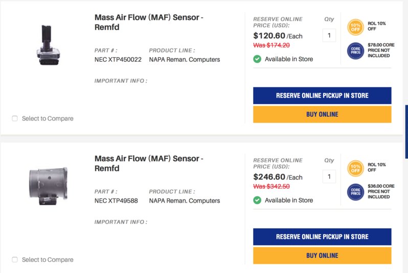

    Nice, how hard was it to find a decent MAF, we have a weird older MAF on out trucks that's hard to buy locally for me

    Haven't replaced it yet... The Napa website shows the second one as the only one that will fit my truck, although the top one looks closer. I'll have to take mine in and compare.

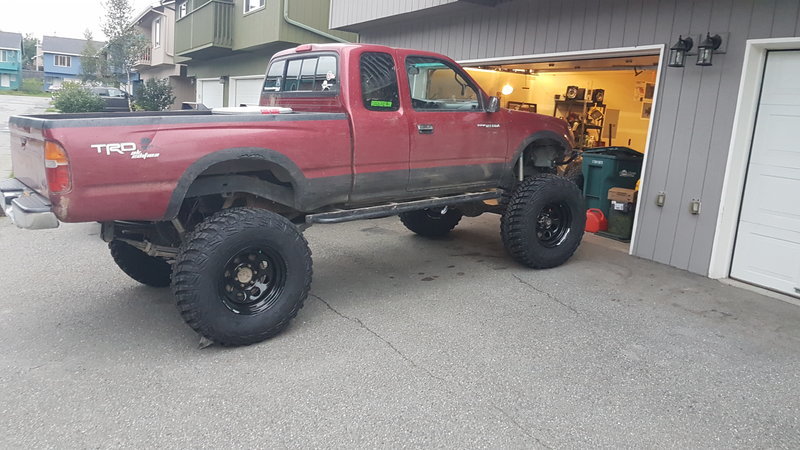

    Finally getting around to posting these... I'm getting worried this thing will roll now.
