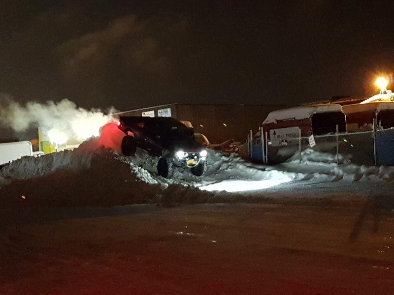

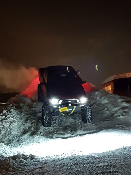

    She lives!!!!!

    So here's what was wrong:
    -Engine Coolant Temp sensor on the back of the block, replaced with new
    -Corroded connectors on 3 sensors on the engine that I had missed.
    -possibly distributor as well, mine was changed for a known good (used) one but didn't see any immediate change.
    -potentially still a wiring harness issue, but I'm hoping that it's good already.
    All sensors except ECT checked out.
