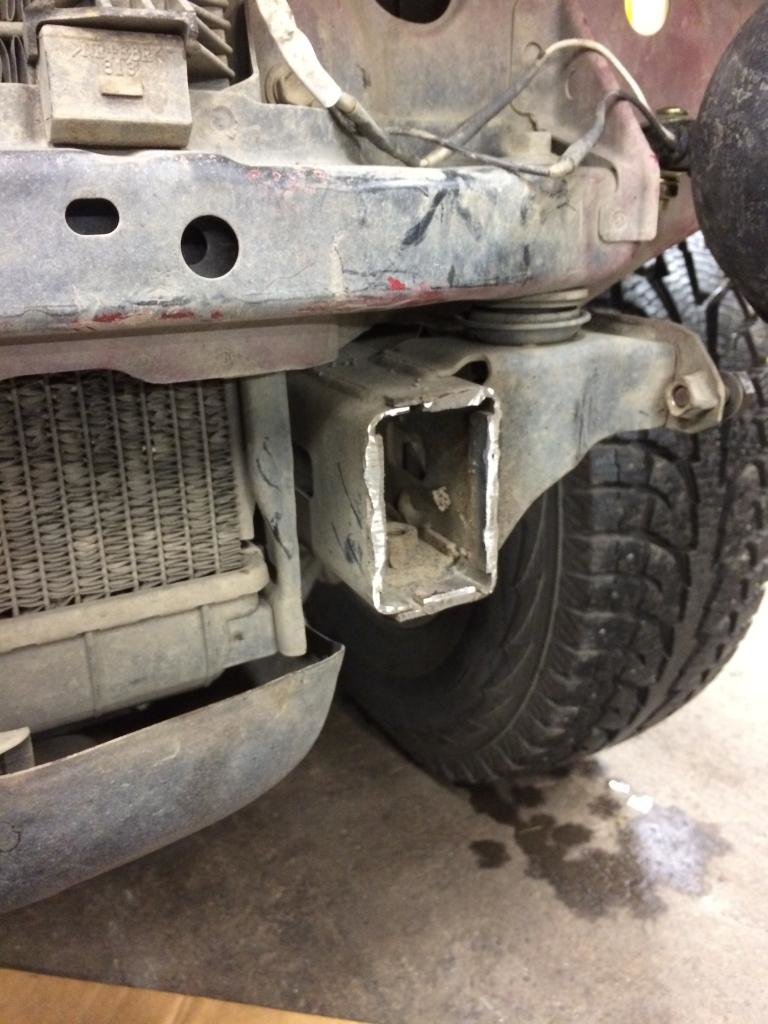

  12. Nov 25, 2014 at 10:29 PM
    #172
    SnowroxKT
    SnowroxKT [OP] Well-Known Member
    Dec 11, 2011
    #68604
    5,319
    Kyle
    Anchorage Alaska
    2008 TRD OR
    Sure was! :D
    And tonight I took off my stock bumper and cut apart my frame endcaps so I can weld some 1/4" plate endcaps on. Didn't get around to welding them tonight though, that will wait until Tuesday.

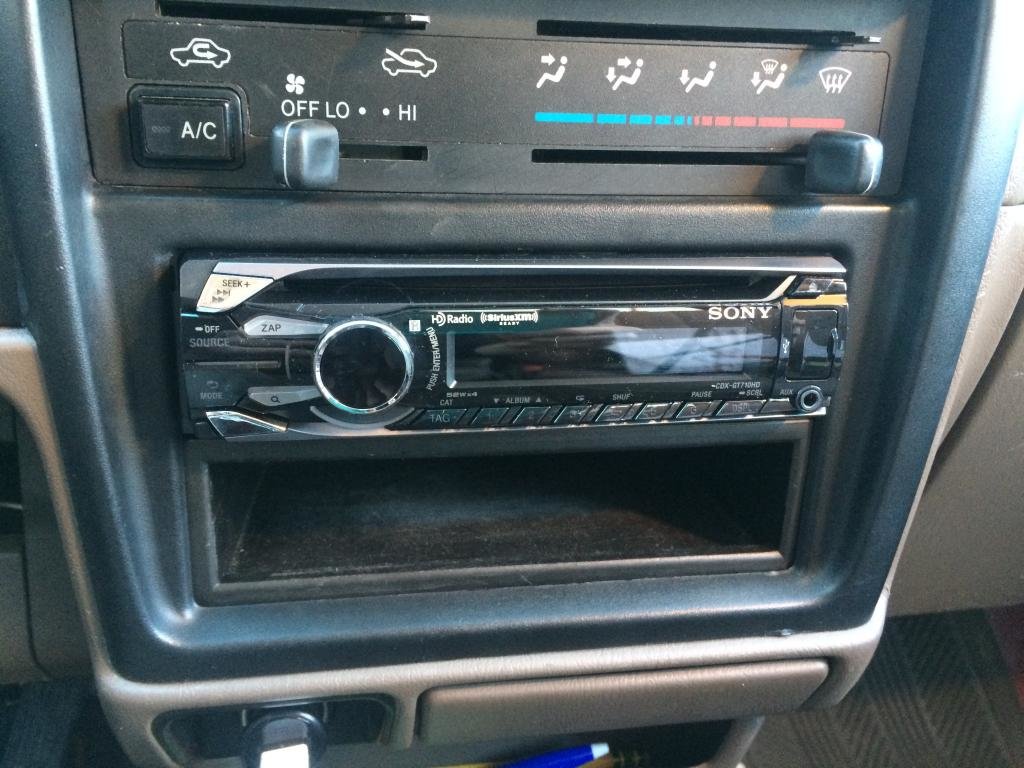

    4,137
    Troy
    Chandler AZ
    2002 Toyota Tacoma 4WD
    Check Build
    Awesome stereo! Is it color changing? The only regret I have with my stereo is not getting the Bluetooth and stuff like that. Sweet gift!
  16. Nov 26, 2014 at 2:01 PM
    #176
    SnowroxKT
    Dec 11, 2011
    #68604
    5,319
    Kyle
    Anchorage Alaska
    2008 TRD OR
    Yep, color changing! I will have to play with it on my drive down to the cabin this afternoon.
    Just installed it too.
  17. Nov 26, 2014 at 8:14 PM
    #177
    Delta00
    Delta00 ᕕ( ᐛ )ᕗ
    Sep 16, 2013
    #112633
    4,137
    Troy
    Chandler AZ
    Check Build
    Looks great! Awesome radio

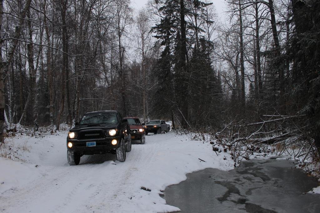

  19. Nov 30, 2014 at 10:19 AM
    #179
    SnowroxKT
    Dec 11, 2011
    #68604
    5,319
    Kyle
    Anchorage Alaska
    2008 TRD OR
    From our trail run.
    Anyone recognize this? hint: Topgear
  20. Nov 30, 2014 at 11:05 AM
    #180
    ffirg
    ffirg Well-Known Member
    Jun 9, 2011
    #57975
    4,876
    mike
    Anchorage, Alaska
    2002 Tacoma SR5 TRD 4X4
    How was the trail? Where'd you guys go? I forgot what the plan was.
