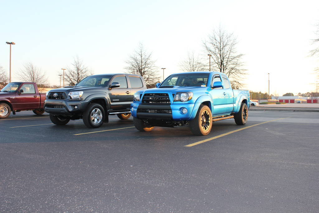

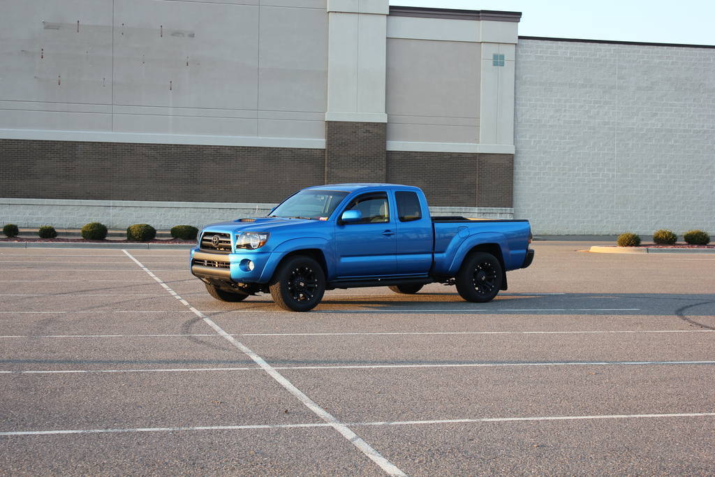

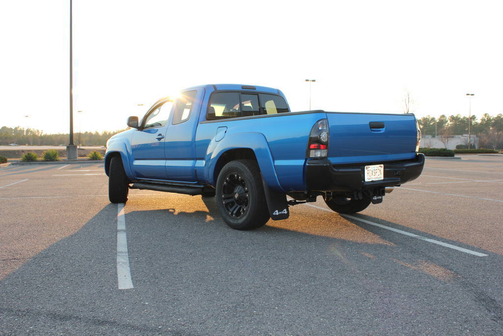

    Before TR 2" Lowering Kit, 5100's set to stock zero setting and Eibachs 1.75" Lift springs up front with TSB 4 Leaf pack pulling up the rear, riding on 285/60/18 Cooper Zeons 32" ish (Note: all previous parts SOLD):[​IMG]
    After TR Lowering kit & other external mods, riding on Khumo 275/55/18's 29" ish:
    Height Comparison with a stock 2012 Taco:

    I will takes som pics to help illustrate, tomorrow.
    First, I called and spoke with Caltrac. Told them what I had.
    We came up with the fact that they needed to be sure that I still had the 4x4 leaves.
    Then, I assured them that I needed the XR lower plate that holds the axle to the springs.
    They have multiple mounting brakets that attach to the from spring perches. Mine came with the "1 Hole" bracket. After install, I learned that I really neaded the "2Hole" bracket. What that bracket does, is drop the link a lower from the spring perch. It is necessary because with the "1 Hole", the Heim joint will be resting on a part of the 2nd leaf.
    A picture will better explain.
    Also during install, of the Tundra Racing rear portion of the kit, I am sure that you noticed the plates, that bolt the axle and leaves together, had two holes.
    Due to the way the those plates fit, one way on driver side, and opposite on passenger side, the plates that you receive from Caltrac have to have a hole cut to match that of the Tundra Racing plate.
    The XR plate has a hole in the center, and not offset. That is why you must cut a hole to match. They will then be side specific.
    All that done, and bars setup per the instructions, and I promise that you will have no wheel hop.
