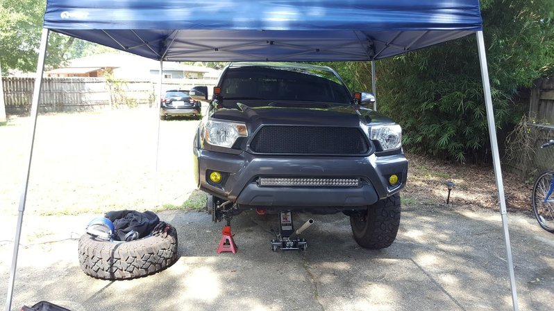

    20170429_175817.jpg Got mine installed no issue. Holes turned out fine. I did not use a regular cobalt bit

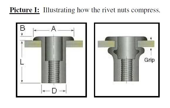

    This is what a rivnut looks installed.
    The rivnut they supplied for a drilled hole of 25/64 (.39) is a 10-32 rivnut. They make a slightly larger body rivnut that still has the 10-32 threads that uses a .43 drill. This way you can still use the hardware they supplied.
    https://www.mcmaster.com/#93669a130/=17og5fb
    I have used washers and bolts to install rivnuts but I would would recommend a good rivnut tool.
    https://www.mcmaster.com/#95585a600/=17og6ej
