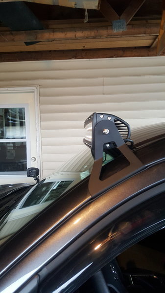

    I grabbed some 3/8 wide black weather stripping tape from home depot and placed across the front of the light bar where the little bolt faces are. I then grabbed some 1/4" plastic humidifier tubing and placed between the fins of the bar, and the bar is barely noticeable now. I have the 4d i believe.

    Since i didnt technically fill the fins in and used tubing i dont think heat/cooling is an issue. Ive had the bar on for about an hour with the truck not even moving and nothing felt hotter than warm... rough country seems to have a no noise no vibration lightbar. I beleive @perpetualenigma3 had it on his rig.

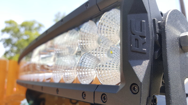

    Damn, I'm very jealous honestly... have you experienced noise through the door at all?
