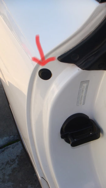

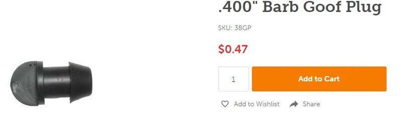

    Go to a paintless dent removal place in the area, have one the techs tap the higher areas down, then touch it up with primer paint in the holes, then use one of their plugs.
    https://www.dentcrafttools.com/plugs.html
    It will look something like above on the white car but less noticeable on your dark color, after a few weeks you won't even notice it and since they will be placed in the same location on both sides equal distances apart, most others won't either.
