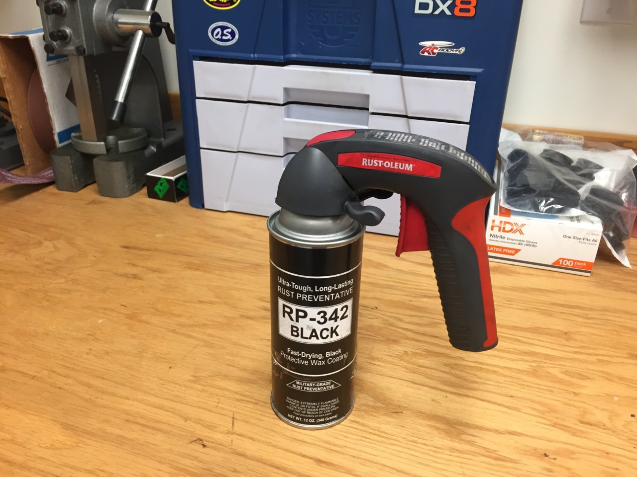

    Be sure to get cha one of these handles.
    It sure saves the finger tip!

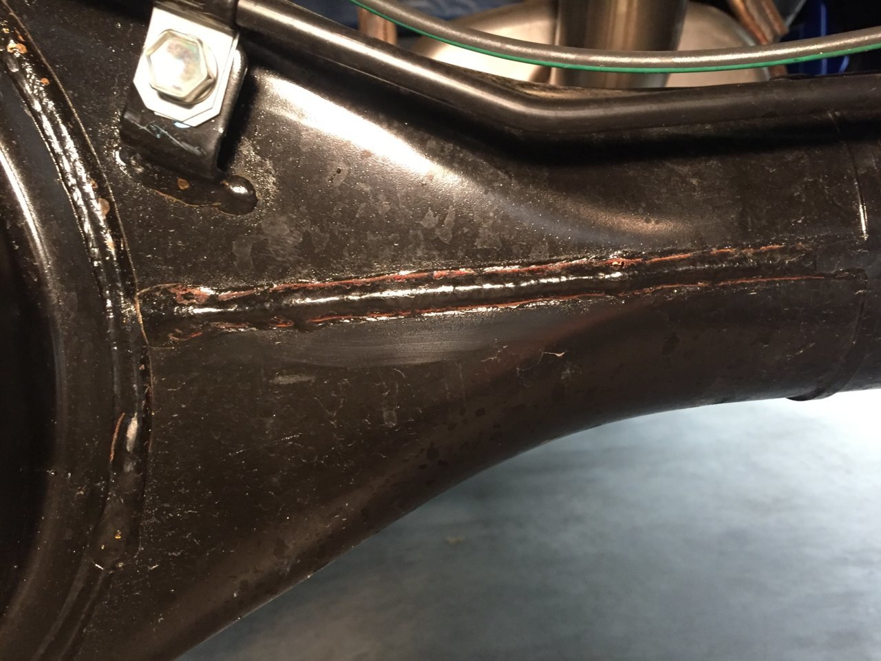

    This is 100% a surface prep issue. Silicon deposits usually collect at the toes of a GMAW weld (where the rust seems to be starting). Those deposits can be a litttle bit of effort to remove by hand (easy with abrasives though), but it’s essentially glass so it’s not bonded to the steel. If you paint over it, that’s going to be the failure point. Sloppy prep procedure.

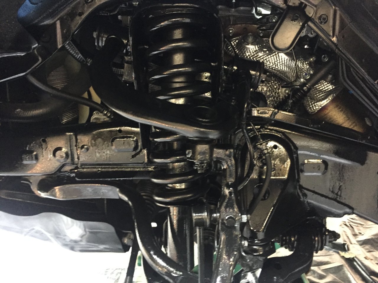

    Used CRC HD and it is good. Wished I've done this brand new. But I recommend doing this outside and wearing a painter's respirator. You get this stuff on your paint it will be tacky at first and dry on the paint. Cannot imagine the black cans you guys are using overspray like a mother.

    18 cement
    Doesnt look like it in pic 1 otherwise you did a good job. I got overspray all over mine underneath the trucks paint. Had to make sure it went all the way up the seams. You cant see it but once you look under you could totally tell.

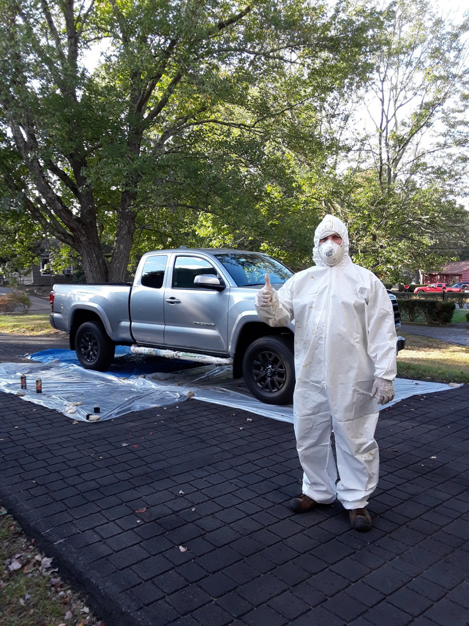

    37 years working in a nuclear plant taught me the value of wearing protective clothing for these types of jobs.
    The application actually wasn't as bad as I feared...and we had a beautiful day here in SE Connecticut. I warmed up the cans using hot water from the tap (114°F), masked my step bars using newspaper and masking tape, and masked the exhaust system using aluminum foil.
    @Kruuuzn - Thanks for the advice on the handle, it worked great and I was able to clean it up pretty easily.
