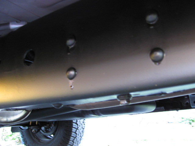

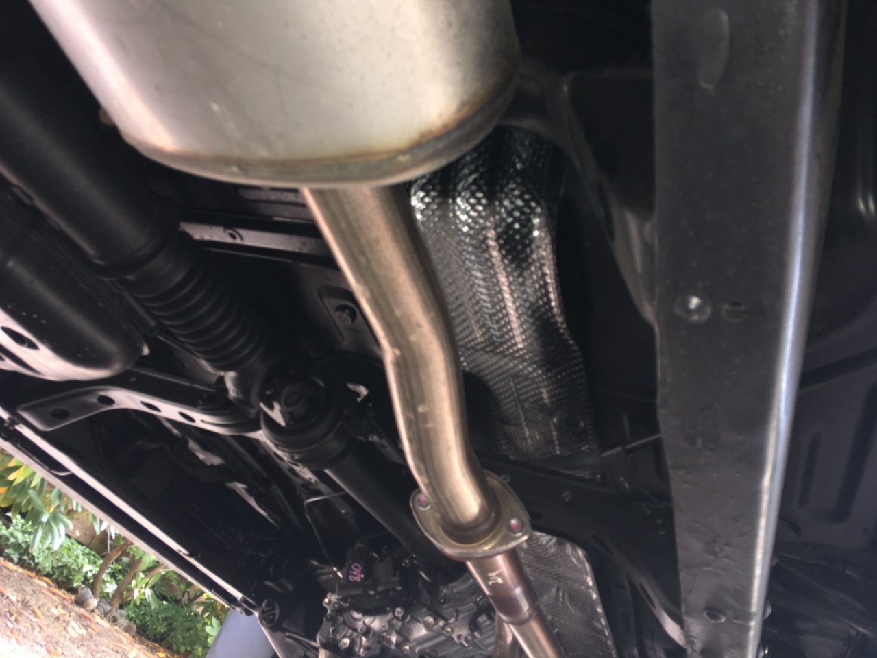

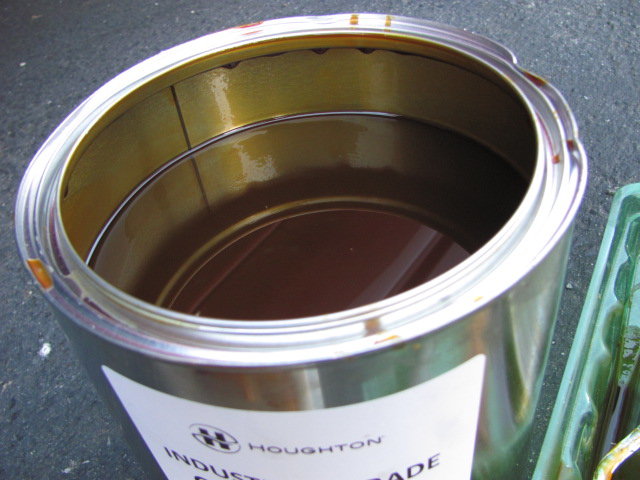

    My gallon of Cosmoline arrived today, and I applied it by hand to my new Tacoma.2020-10-14 012.jpg 2020-10-14 014.jpg 2020-10-14 022.jpg
    RCrumb, Canadian Caber and boston23 like this.

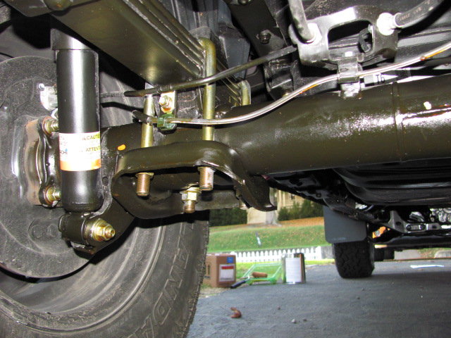

    BarryWestVirginia Member
    Sep 22, 2020
    #341583
    12
    Barry
    2020 Tacoma base

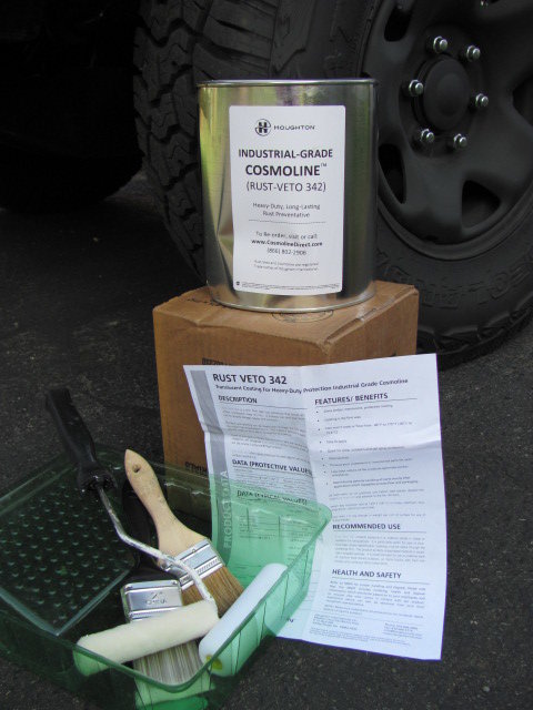

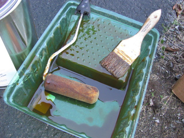

    Canadian Caber likes this.

    This is all I used on the frame, crossmembers, axle, shackles, shock-mounts, differential, drive shafts, etc. 2020-10-14 011.jpg

    Problem doing it with a brush it doesn't get forced into critical areas like spraying. You want to get inside those cross members and parts of the frame. Make sure you remove the engine skid plate and spare tire to get all those areas....imo, you can't get them with just using a brush.

    Brother Zoo,
    I don't have access to a sprayer. Bummer. I'll get back under the truck and reapply after I lower the spare and skidplate. Pray for me.
