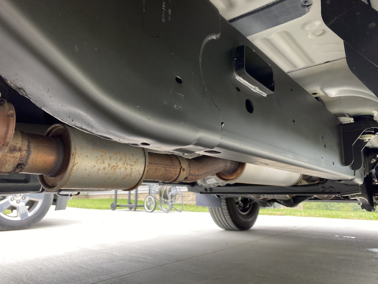

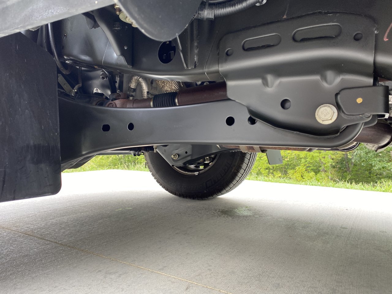

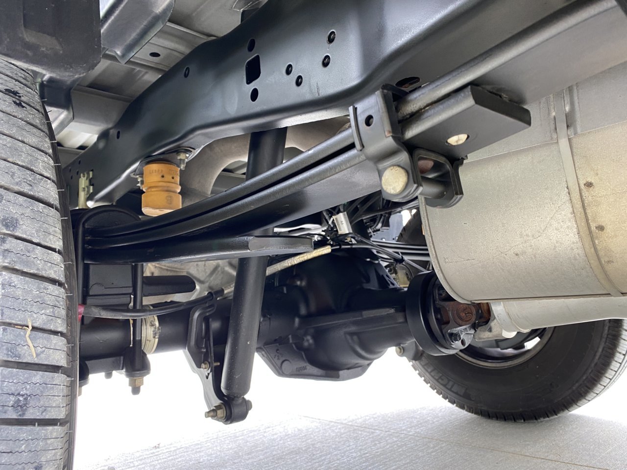

    This looks great! What kind of prep work did you do (masking)?

    Just sprayed Simple Green with a pump sprayer on the undercarrige and pressure washing it off to clean (laying on my side, getting soaked). Let it dry overnight, then sprayed the CRC next day. Didn't do any masking, just was careful with spraying.
