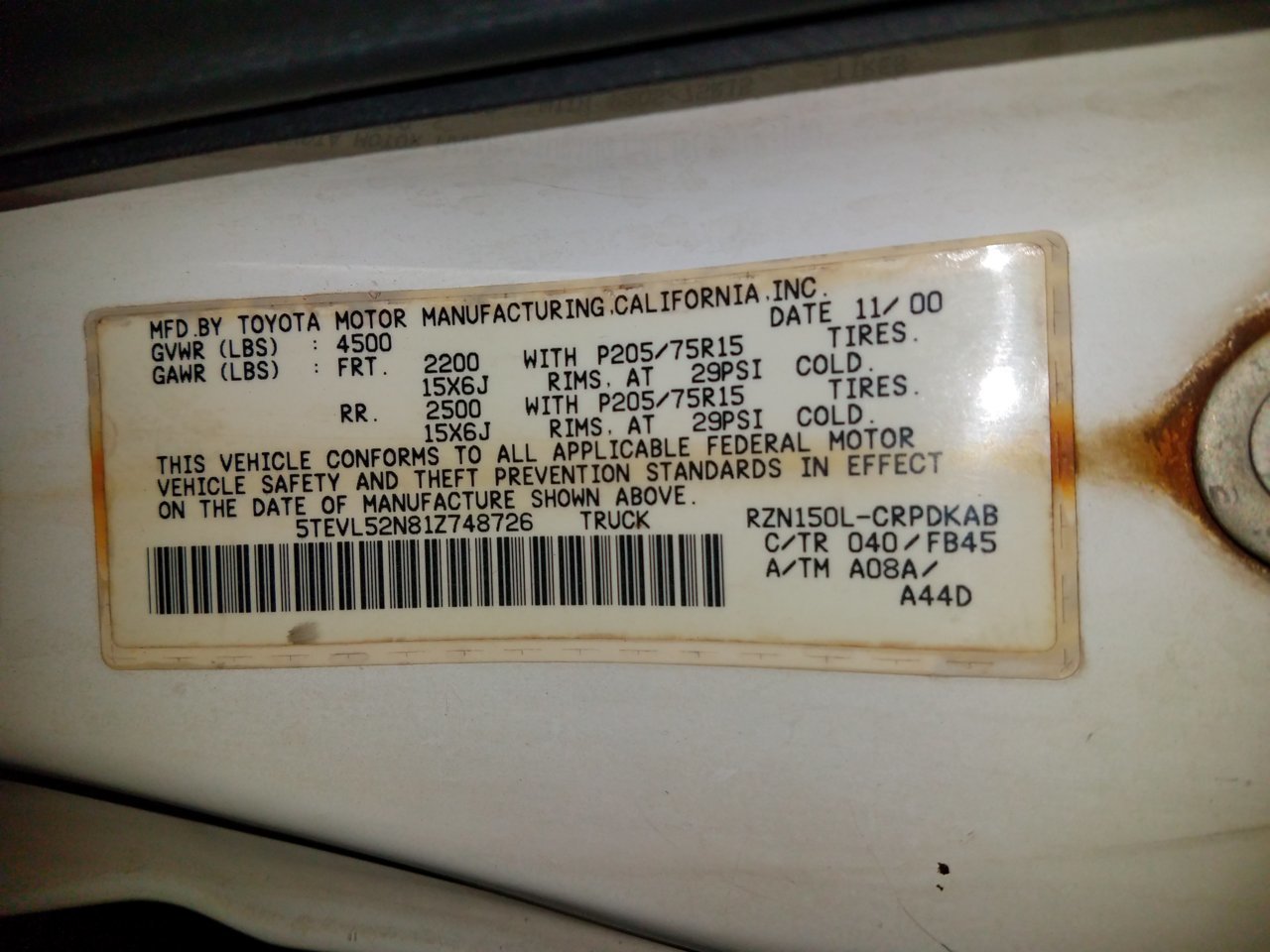

    2001 Tacoma xtracab 2.4L AT
    Hi everyone
    I have a 2001 tacoma xtracab 2.4L with automatic transmission ( A44D )
