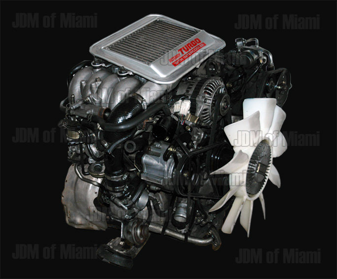

    Step one: remove engine.
    Step two: install this engine
    Redline for days.
