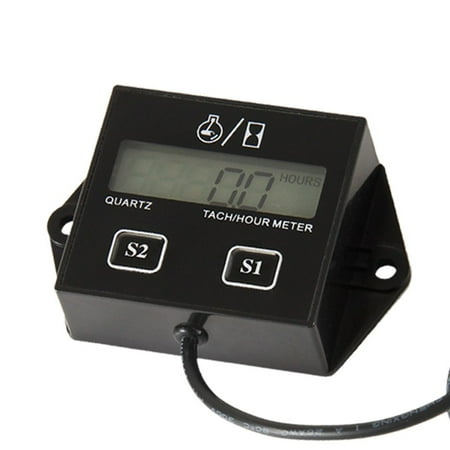

    Or you can get a cheaper $10 inductive tachometer that you ought to be able to run off a spark plug wire :cool:

    Ak, can you elaborate? An induction reader does not need to splice just be strapped.
