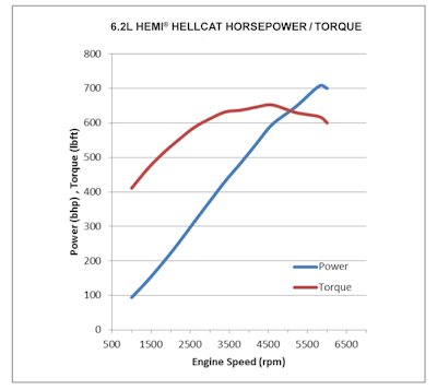

    True, the measure of an engine's performance on a dynamometer is given as its torque
    Not to be a smart ass but Horsepower is related to Torque and engine RPMs.
    Here is the pertinent equation:
    Horsepower = (Torque x RPMs) / 5252
    or
    Torque = (HPx5252)/RPM
    A little complicated LOL! (any mechanical engineers willing to chime in?)
    Here is a chart comparing the two on the Dodge "Hellcat" V-8
    So Torque and Horsepower both increase with RPMs but not proportionately equal.
    I see this with my Tacoma.
    My ScanGaugeII shows the horsepower increasing as RPMs increase.
