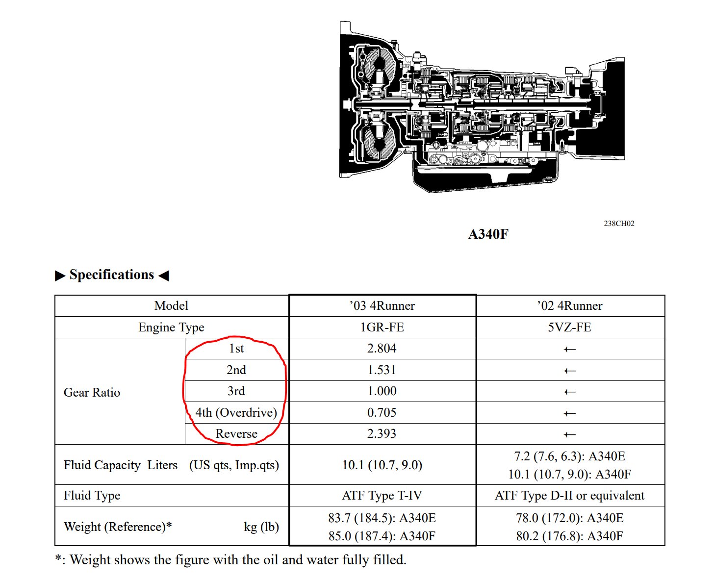

    Except it's 3+OD on the AT
    4th is overdrive
    Here's an example
    They call an A340 a 4 speed trans. The only way it's 4 speed is if you include the overdrive. It's actually a 3 speed with an overdrive. A long time ago a bunch of people wanted to argue about that with me. It's probably Po-tay-toe vs Po-tah-toe... but there is a difference.
