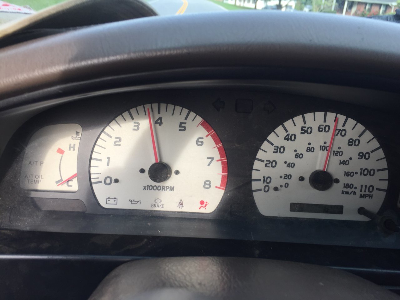

    i have a 99 Tacoma 5 speed 4.10 gearing pushing 265/75/16 and at 70mph I’ll be at 4K rpms I was wondering if that was normal or do I have something wrong?? What rpms do y’all do at 70?

    I’ll be in 5th gear at 4K rpms doing 70

    Yeah I switched out the gauge cluster it’s an original 5 speed manual I got the gauge out of an auto

    damn...I don't know what my stock gear ratio is exactly (2004 v6 5speed) but I have the same size tires as you and I'm at 2800 RPMs at 70mph. 4k sounds awful high...

    I know right I have a buddy with a 98 and same gearing and tires and he does like 70 at 25 or 3k i mean it’s just screaming I try not to go that fast bc I don’t want to strain the motor

    Wonder if your e-brake cable is stuck on, or the rear drums are partially engaged...something that might be forcing the truck to have to work a lot harder to maintain speed..?

    My 02 DC Pre Runner with a 2.7 4cyl with 4.56 gears and running 265/70 16's at 70 mph I'm at 2800rpm

    Maybe a bad torque converter

    I have a 5 speed with the v6 and I'm looking at 2500 rpm I think when I am cruising at 70 mph. Are you sure of the gear ratio?

    Can you verify the speed independently with GPS?
    4000 RPM is around the torque peak for that engine IIRC. It shouldn’t be spinning that fast at 70 mph.
