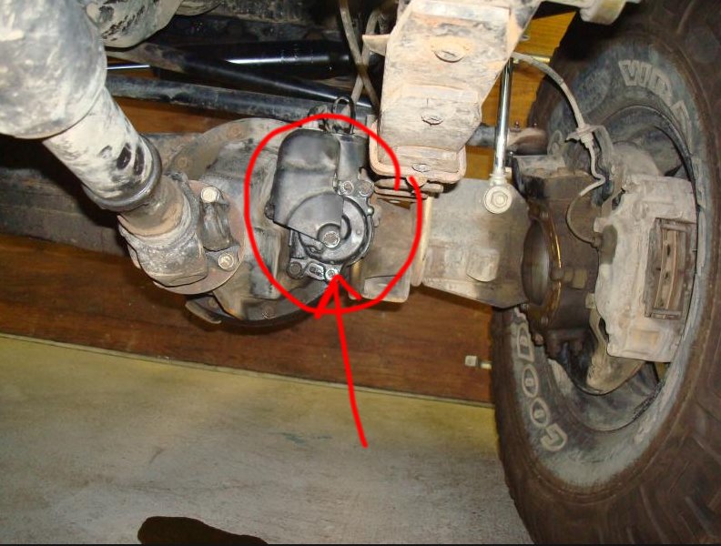

    Strange thing is that I've been googling '1996 Tacoma TRD e-locker' and I keep seeing links and sites saying that the e-locker didn't come as an option until 97 or 98...then there are a few guys saying that there's have it. Have you owned your truck since it was new? I'm wondering if maybe the previous owner had to put a new dashboard on it and used one from a later model TRD Tacoma and that's why nothing is happening when you press the button...
    Not saying that's the case but it's just weird that I can't find any official confirmation one way or the other that the 96's came with one...do you have a pic of your differential? It looks like this:

    Well shit. Definitely don't have that...

    I guess that solves my problem then haha thanks for the help man.

    haha no worries dude, it happens. I don't know why it finally dawned on me to ask, I should've mentioned it earlier lol.
    On the bright side if you ever want to install one, you already have the switch for it :D You'd have to swap in the whole axle though as the e-locker is exclusive to the TRD axles.
