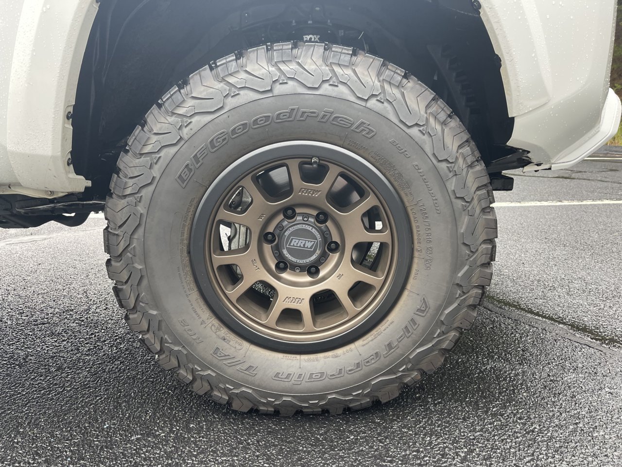

    The pictures show a "protection" ring offered by RRW, used in a beadlock application. I don't have enough experience with these wheels to be sure, but from all the media I've browsed the bead lock ring looks very different from the smooth rings shown here. They may have ordered and installed the wrong rings for the wrong purpose. Never seen or heard of anyone else having this issue, including the people that actually use them as true beadlocks wheelin'.

    So those are not true beadlocks, those are what RRW calls protection rings and they protect when off roading from rocks and such. I have these same protection rings. The beadlocks are in the image in post #28. They are a hybrid rim and RRW does offer the aluminum true bead lock. We’re you running these as a bead lock though? If so, that is what happened and in the pic it looks like they are set on the rim for a bead lock. This would explain the low tire pressure too.

    Yeah these guys used the protection ring as a beadlock and it isn't surprising that it failed miserably. Funny part is one of them does nuclear work and is supposedly "patient and exacting" in all applications of everything. Small oversight but you'd think nuke kids would know better.
