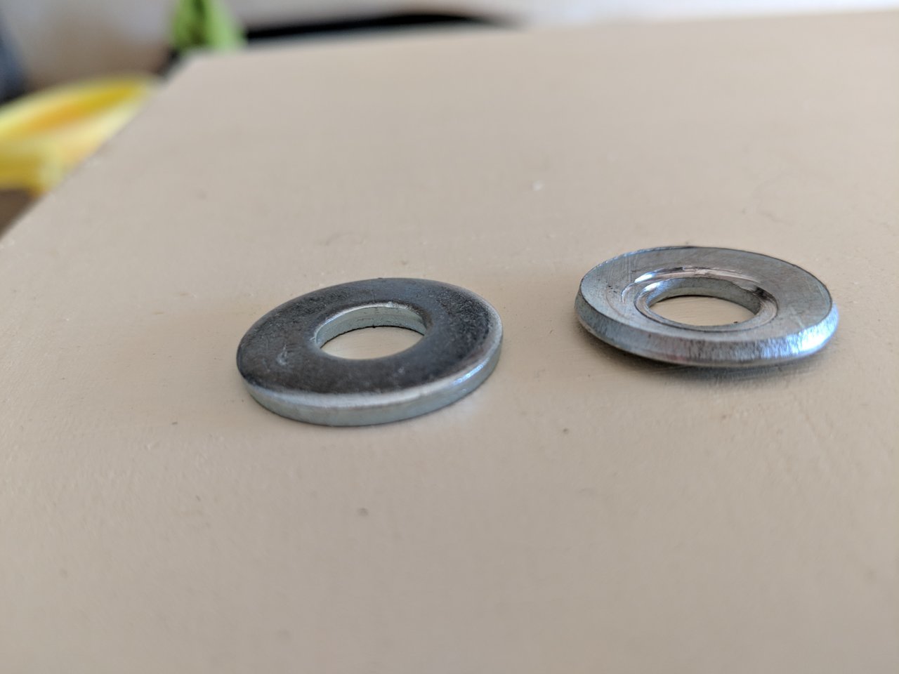

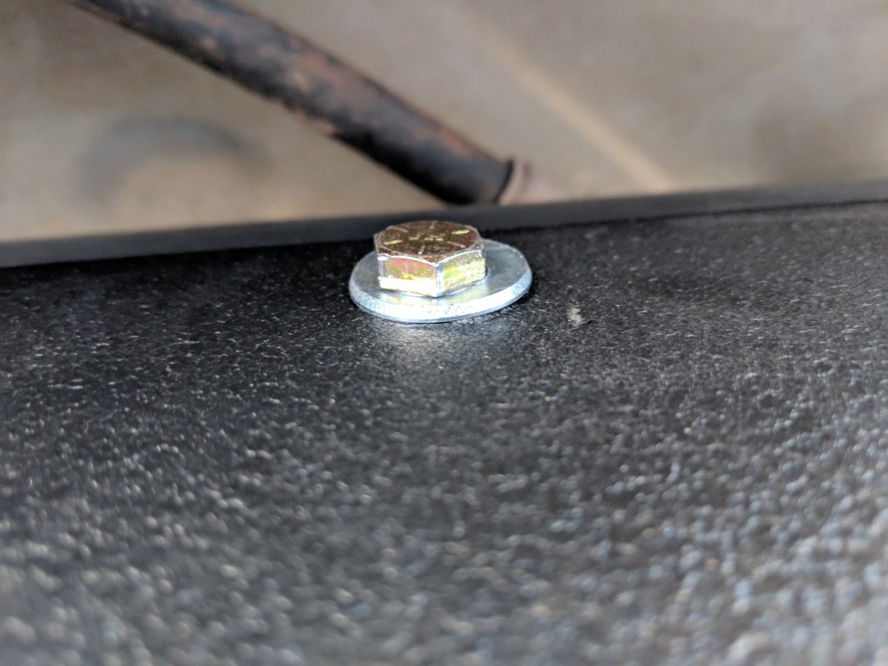

    Finally got around to putting mine on. Mine were done with the gussets, came with grade 8 hardware (more on that in a minute), but we're powder coated by the original company they were using I believe. Overall, I'm satisfied with them but part of me wishes I went with a different brand.

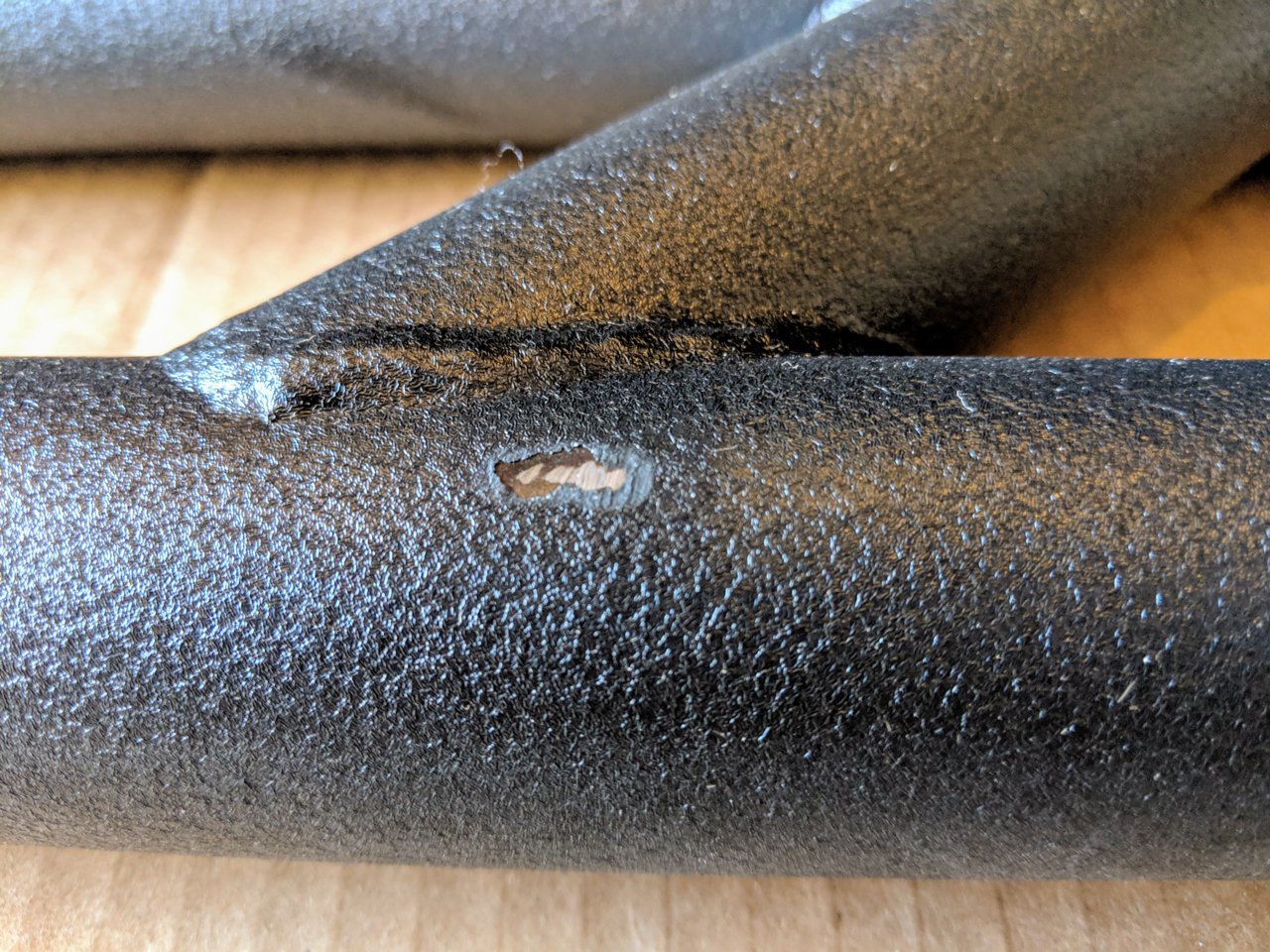

    Boxes arrived in great shape. No damage during shipping, which is nice, especially when it's free! However, when I opened them up they had several nicks in the powder coating. IMG_20181115_155829.jpgNot a huge deal but disappointing for sure. I proceeded to mount them up, starting with the passenger side. I balanced it on a jack and just lined up the holes. When I started to tighten them down I noticed the washers were beginning to deform. It finally dawned on me that the washers provided didn't look like grade 8 hardware. IMG_20181116_114130.jpg IMG_20181116_131355.jpg I was using a 1/4 inch ratchet that's got like a 6 inch handle on it so it wasn't like I was applying a whole lot of torque but those washers definitely weren't up to the task. I ran to home Depot and picked up some new washers as well as a smaller set of nuts and bolts for the very front hole. There is a hole there that lines up but the included hardware doesn't fit in the hole. I think it was 1/4 inch that I ended up buying. Just bring the original for reference and buy the next size down and it will fit. Also, more of the powder coating flaked off as I tightened the bolts down. I think im going to grab a rattle can bed liner and just recoat the entire thing.
    The driver side was a little trickier. The brake line brackets take up most of the holes that line up. I decided I didn't want to bother with drilling and that the rigid brake lines aren't going to go anywhere without the cheap little plastic brackets that we're in the way. I removed the 2 towards the back and they immediately broke anyways. I didn't take step by step pictures but it's really not hard. I had my hands full trying to balance the sliders on the jack and trying to line up the holes with my 1 year old running around trying to help. All said and done it took me like 3 hours including a home depot run.

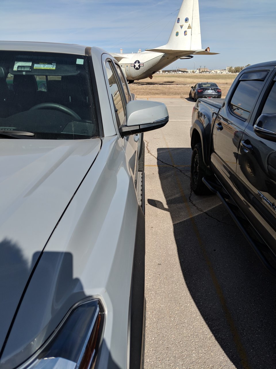

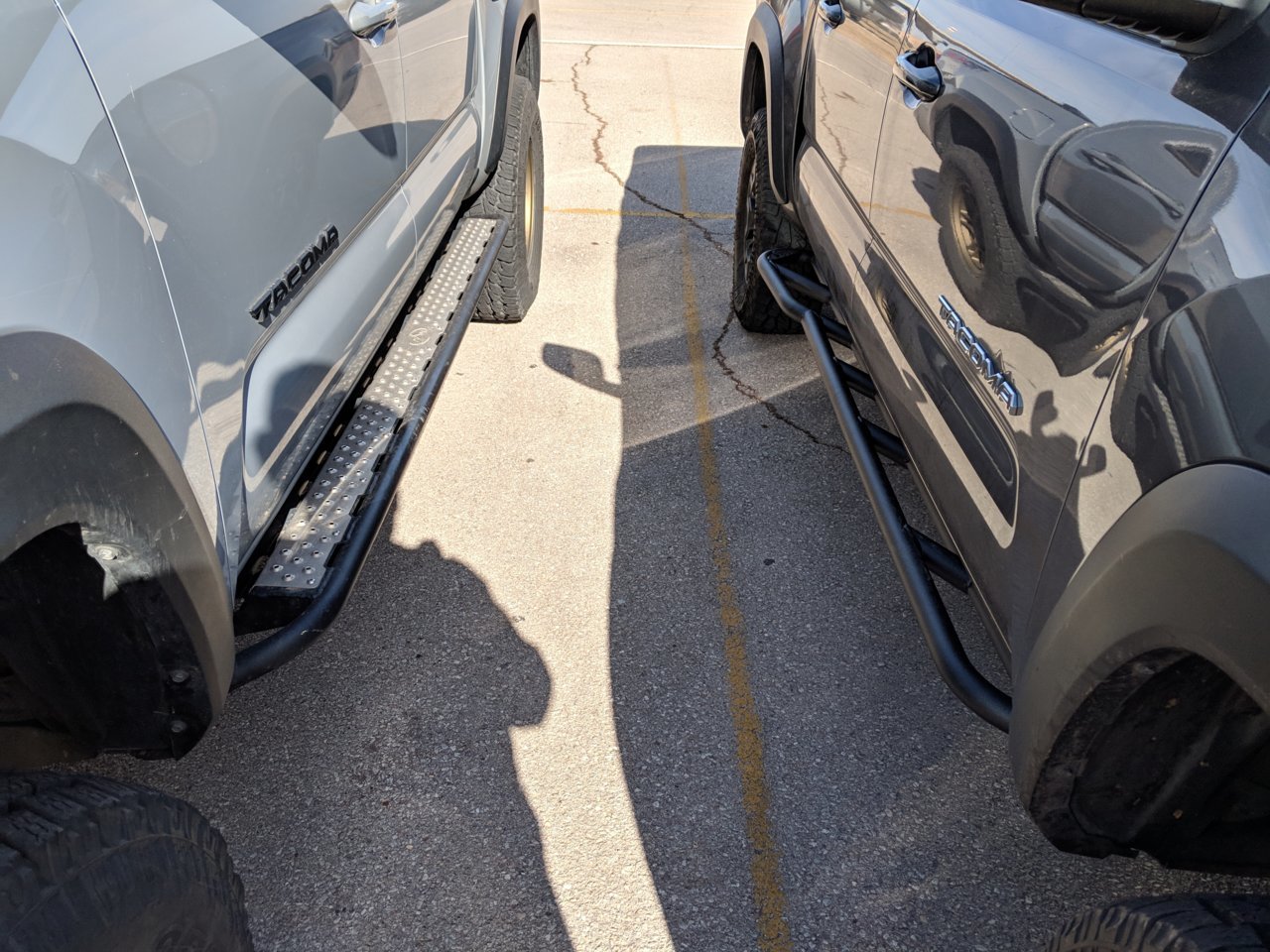

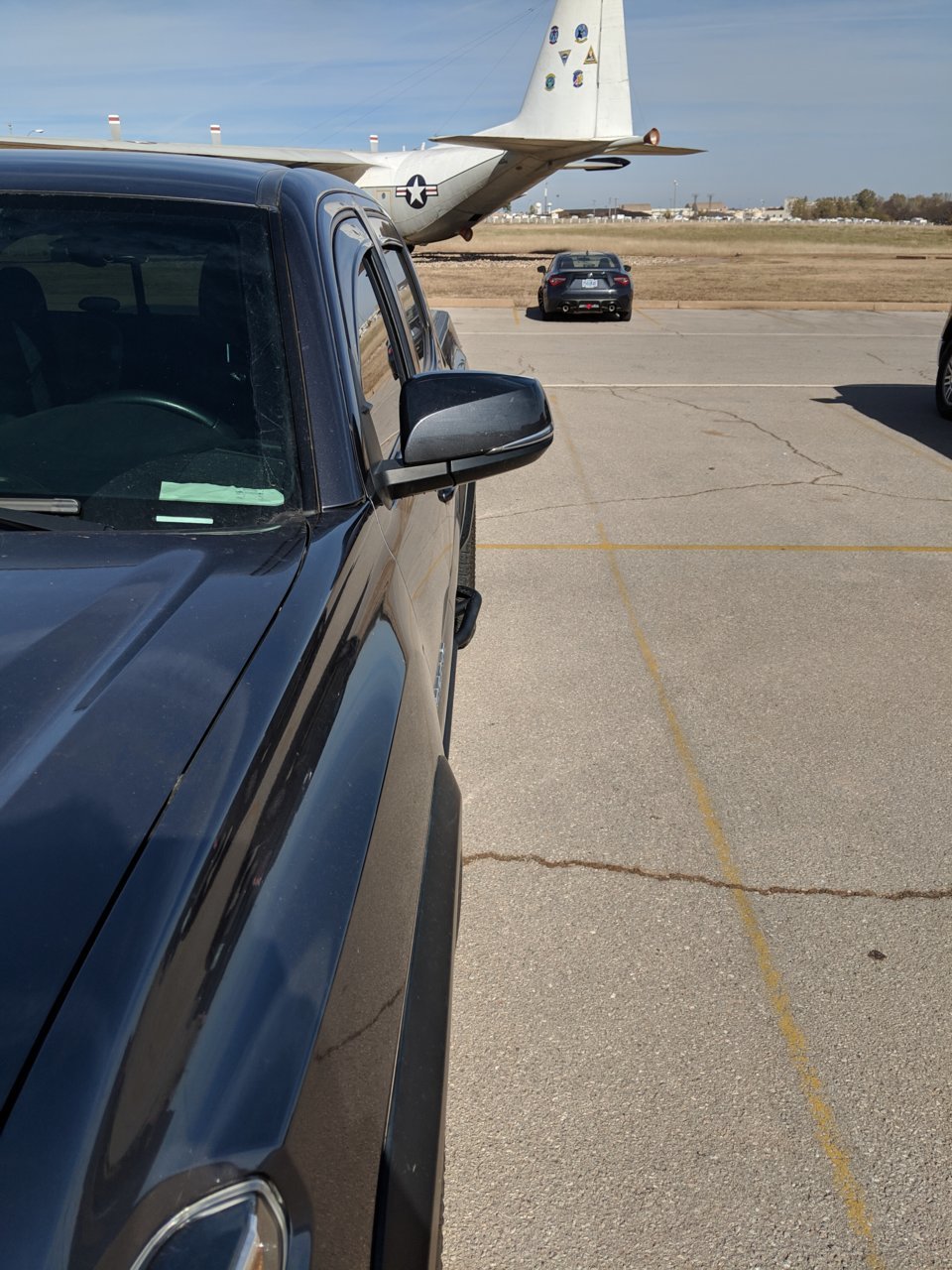

    Now that they're on, they don't stick out quite as much as I would like. I thought I would prefer the tucked under look but my buddy's stick out and his are definitely more functional both as steps and mall armor. His may actually save some body damage too if you were to get close to some tall rocks. IMG_20181117_111344.jpgIMG_20181117_111330.jpg IMG_20181117_111319.jpg
    Considering the price difference (his were close to double mine after the inserts and the powder coating and shipping) I'm pretty happy with mine. I don't remember what he got.. I don't do anything crazy off road and when I do sketchy stuff I go slow so hopefully I never slam these down and really put them to the test. For my needs, they should be good enough. They look better than the old steps too in my opinion.
