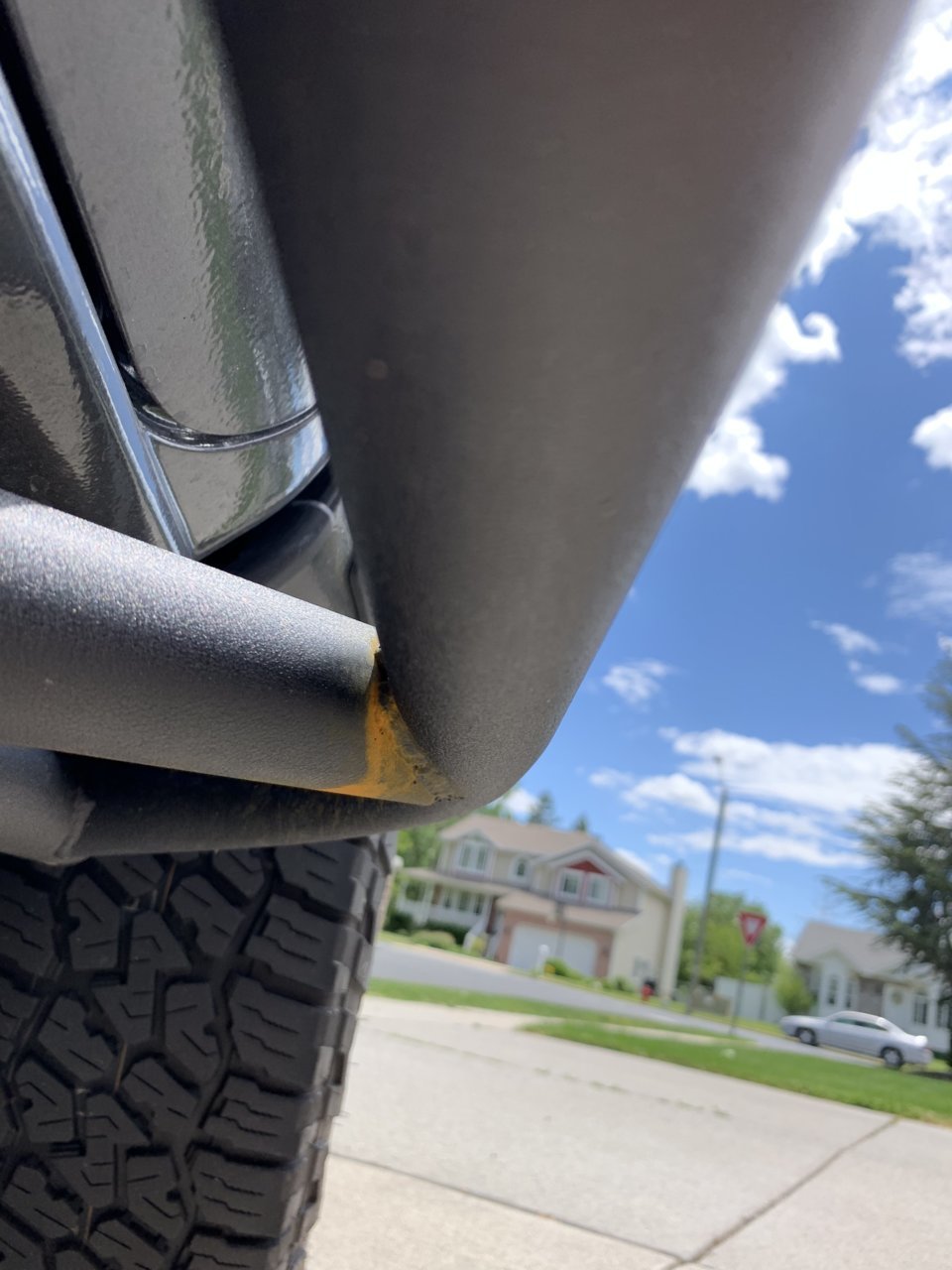

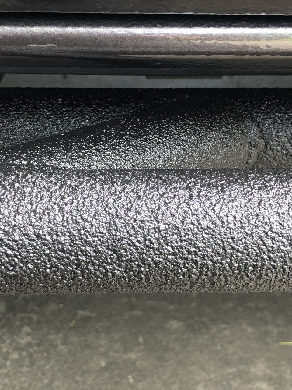

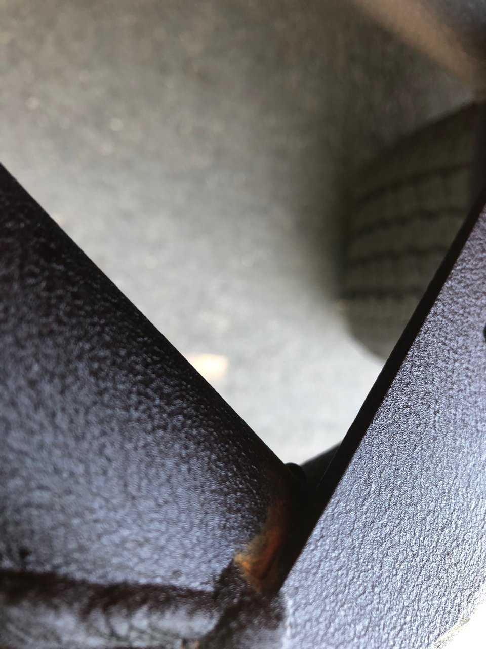

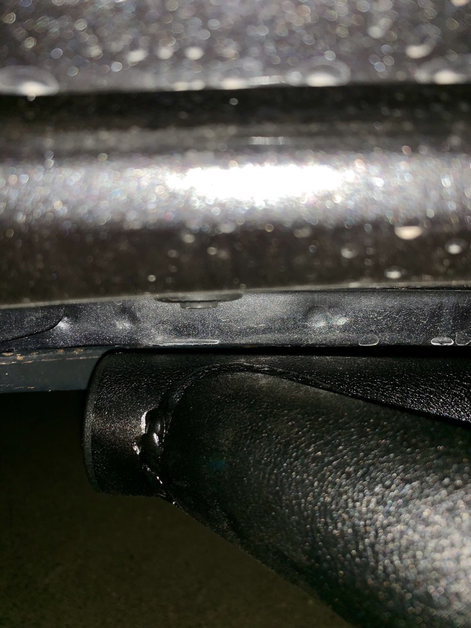

    I have to admit I’m pretty disappointed. I have a spot where the weld has a hole and it’s rusting. I get contact on the passenger side when I hit decent sized bumps. I tried repositioning them and it helped. I loosened the bolts and used a jack to put light pressure on the side opposite of where it was contacting and retightened the bolts and I got a little more clearance.
    From the Drivers side.
    The photo sucks for the passenger side but it’s very close to the pinch weld. When I hit bumps this is the part that sounds like it is contacting the most.
    Mine aren’t as bad as some of the others but still frustrating.

    Yup, I have the rust issue as well. Just from the recent rain here in Central California. Also, passenger side rear is pretty close to the pinch weld.

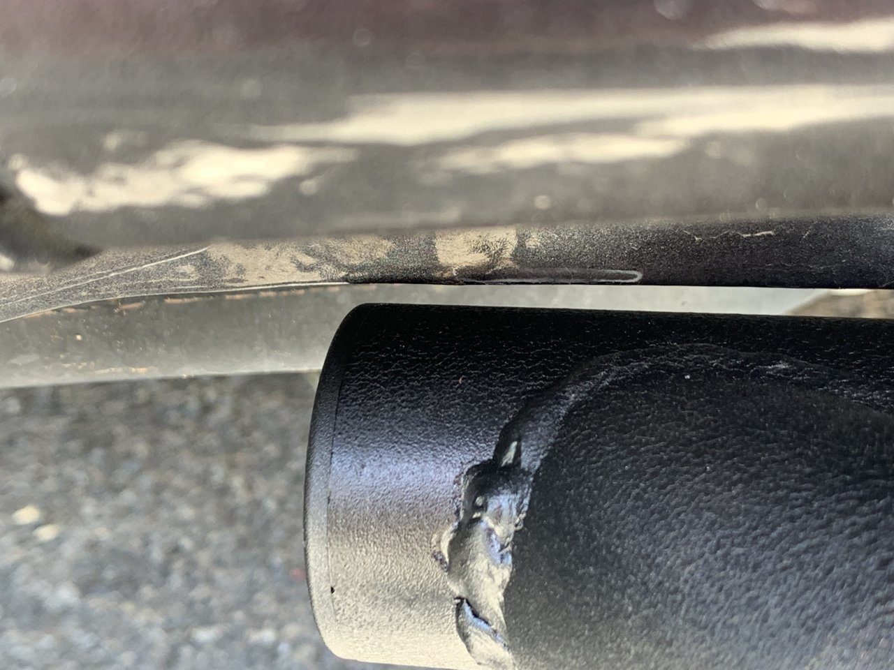

    5F2BE203-78C9-4CBB-BEDE-B089D9C67D81.jpg Alright been driving a few days now , don’t see any where thats hitting, even where I had to shim. Im going to keep driving with them on till I hear or see anything . These have been outside for a month and line xed for a week with all kinds of rain. Seem ok so far
    Another thing I did pick up all grade 8 hardware washers/lock nuts
