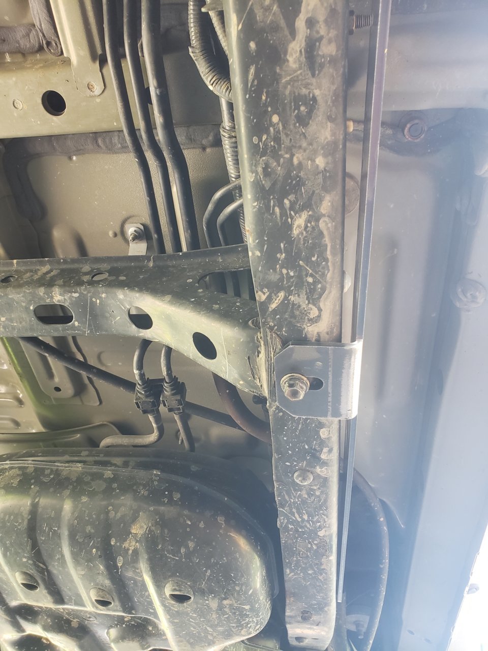

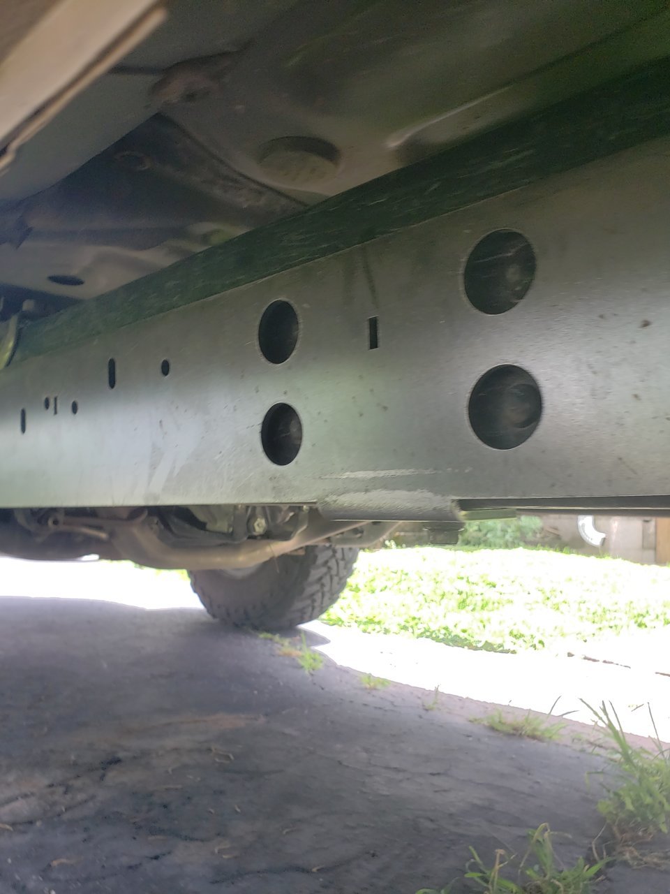

    Has anybody installed race relation wheels diy slider kit. I'm having trouble getting the frame plates to line up correctly.20200716_122043.jpg
    I have these 4 large holes lined up over the rivets
    And this bolt on the bottom installed
    But the front by the cross member doesnt line up and seems to be bent at the wrong angle and even if it did line up there is nothing on the crossmember to bolt to. Am I doing something wrong? Any pictures of these installed would be appreciated.

    From what I gather that front plate is supposed to mount inside that rectangular hole in the frame. They use a nut welded to a piece of flat strap. I think they redesigned their mounting plate, they might have to ship u a new one lol
    Pretty sure they messed up my hardware order. A week after my main shipment I got those welded tabs in the mail. I think the bolts are too small too.
    ETA my plates did fit well and everything seemed fine in that aspect.

    That would make sense. But that hole is nowhere near the right place. Did you test fit the plates before you assembled

    I did. I edited my previous post. I think they're wrong

    Shouldn't there also be a joggle in the frame plate to account for the thicker frame forward of the transmission crossmember?

    That does not exist on mine as well. "form in place" with the bolts is my guess :facepalm:
