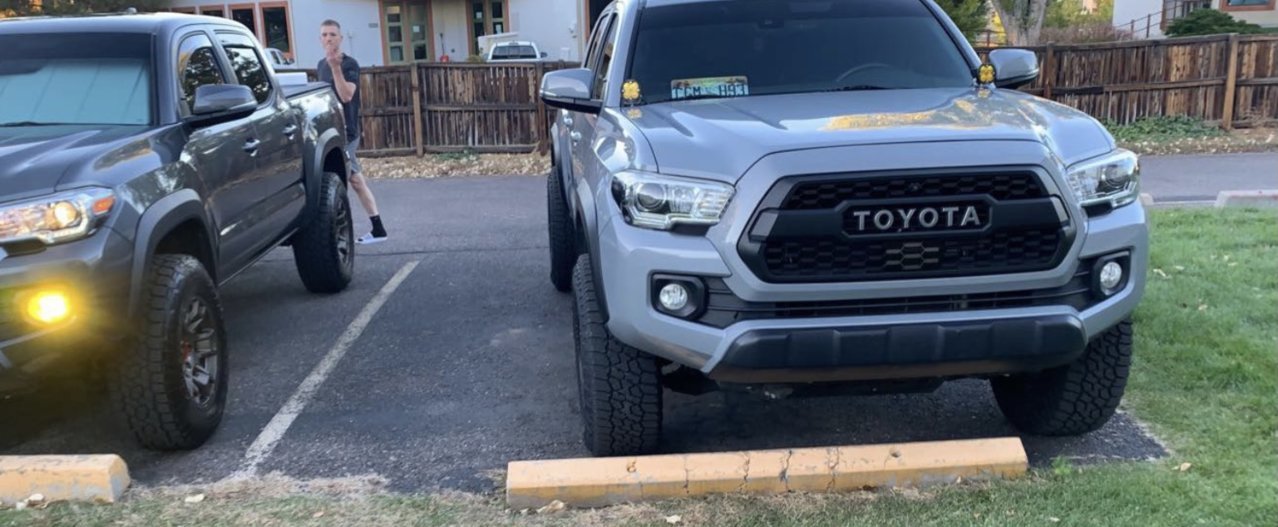

    I have a stock Tacoma with 17x9 265/70/17 -12 looks good

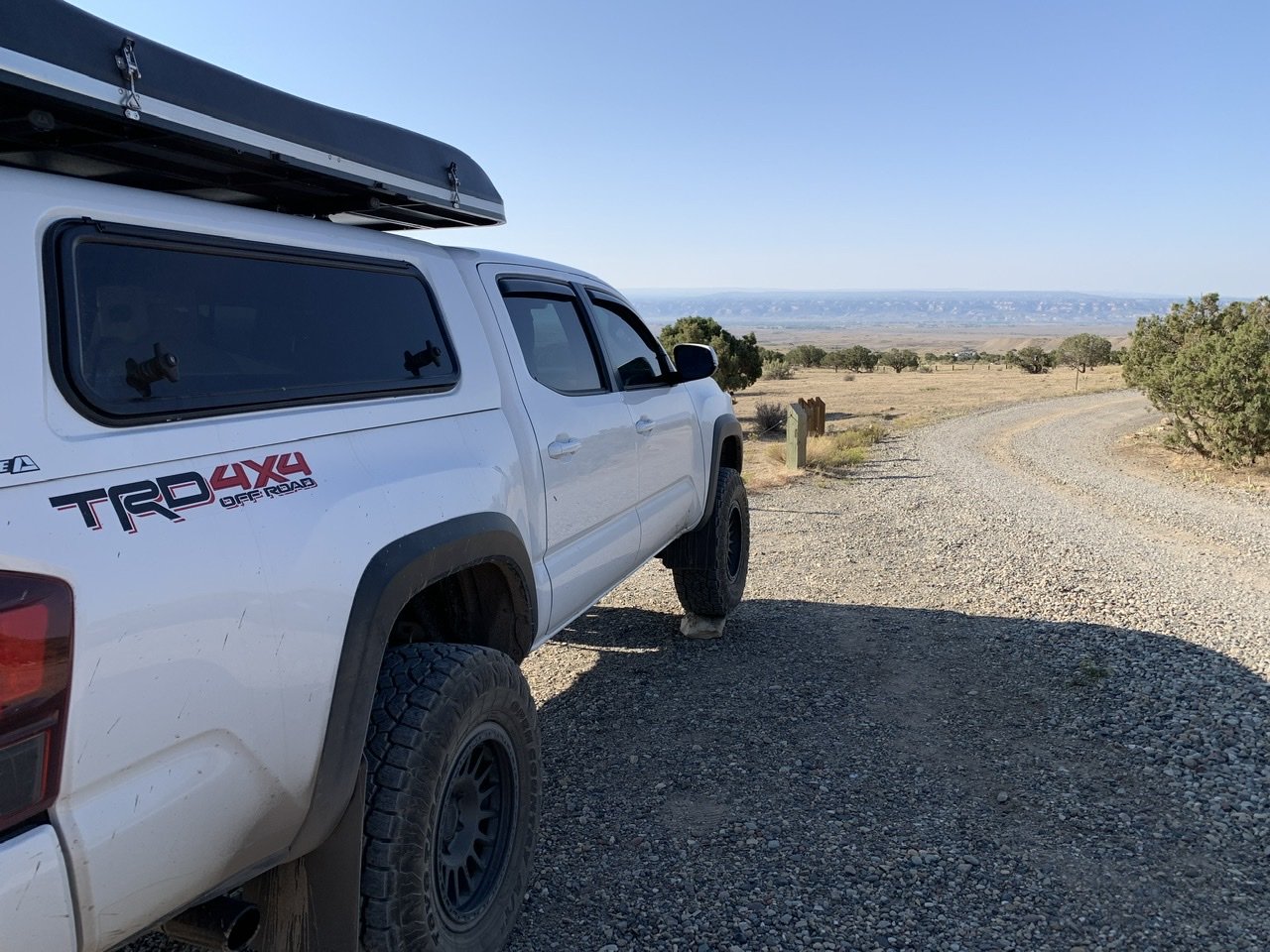

    These are RR6-H’s at 17x8.5 -25 and they rubbed a good amount with my 6112/5160 setup. I drove it for a few months and dealt with the rubbing but ended up doing a CMC from a local 4x4 shop for a couple hundred dollars. -12 might be good but you’re cutting it close. If you definitely want to stay away from a CMC i’d go with 0 offset for no headaches. Negative offset looks great though!

    If you do 265/70/17 you will be good with -12 offset I have it and had to trim a little plastic doesn’t touch the cmc at all I went off-roading b

    Wow, thats poking more than I thought it would be. Cant imagine how much it might be when I go these specs plus 285/70/17
