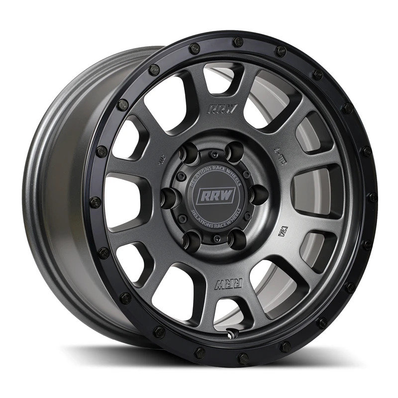

    I just wanted to know if any one is running the RR5-v on a first gen Tacoma? 16x8(6x5.5|6x139.7) -12mm or the -25mm and how different it looks. Thanks!

    That neg offset might rub at stock height. What tires are you running? Any lift?

    2.5 lift, I was planning 285s

    285s will rub. That’s a good looking wheel. I assume you want to run a 285/75/16?

    Yea wheels look sick, I knew they would rub I just want to see a first gen with those wheels. I was mostly concerned about the negative offset.

    I've ran a decent amount of wheel/tire combos on first gens and I think that You should be good with either offset and 285's if you're ok with needing to trim up/smash down your pinch weld. IMO, the -12 offset would be the way to go. It'll give an aggressive stance that's not too far out.
