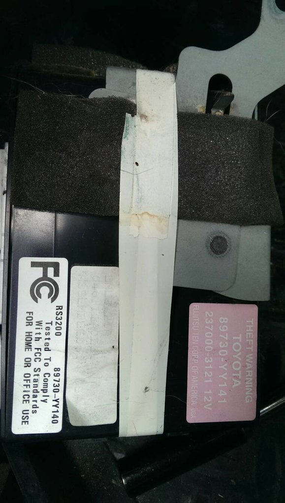

    Found this under the kick panel:
    Where is the white wire mod write up?

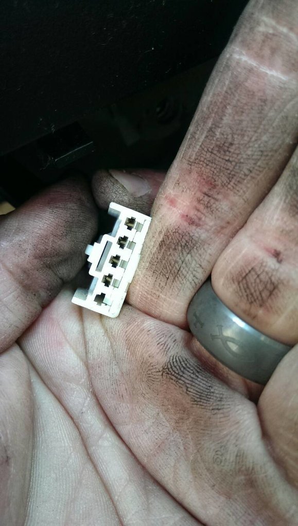

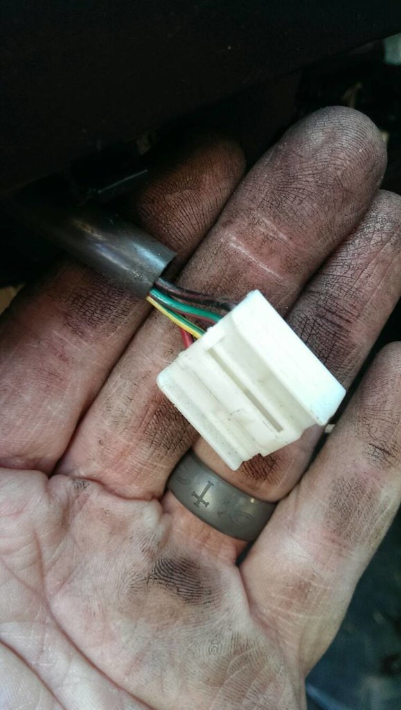

    Is this the plug for the gb/led?
    It is located right next to the dimmer know behind the knockout for the difference lock.

    Directly under the column, two wire looms, it was taped between them.
    I don't think the plug I pictured is the GB/Led harness.

    I dont think thats it. From what I remember it was closer to the center hvac stack if I THINK. Under the ashtray are the knockouts which is where I placed my LED / glass sensor so it would have to be long enough to reach those knockouts

    I found it, it was behind the lower panel with the power outlets, took the one out of the 4Runner and wired it in.
    I also robbed the light ring and harness for the ignition switch.
