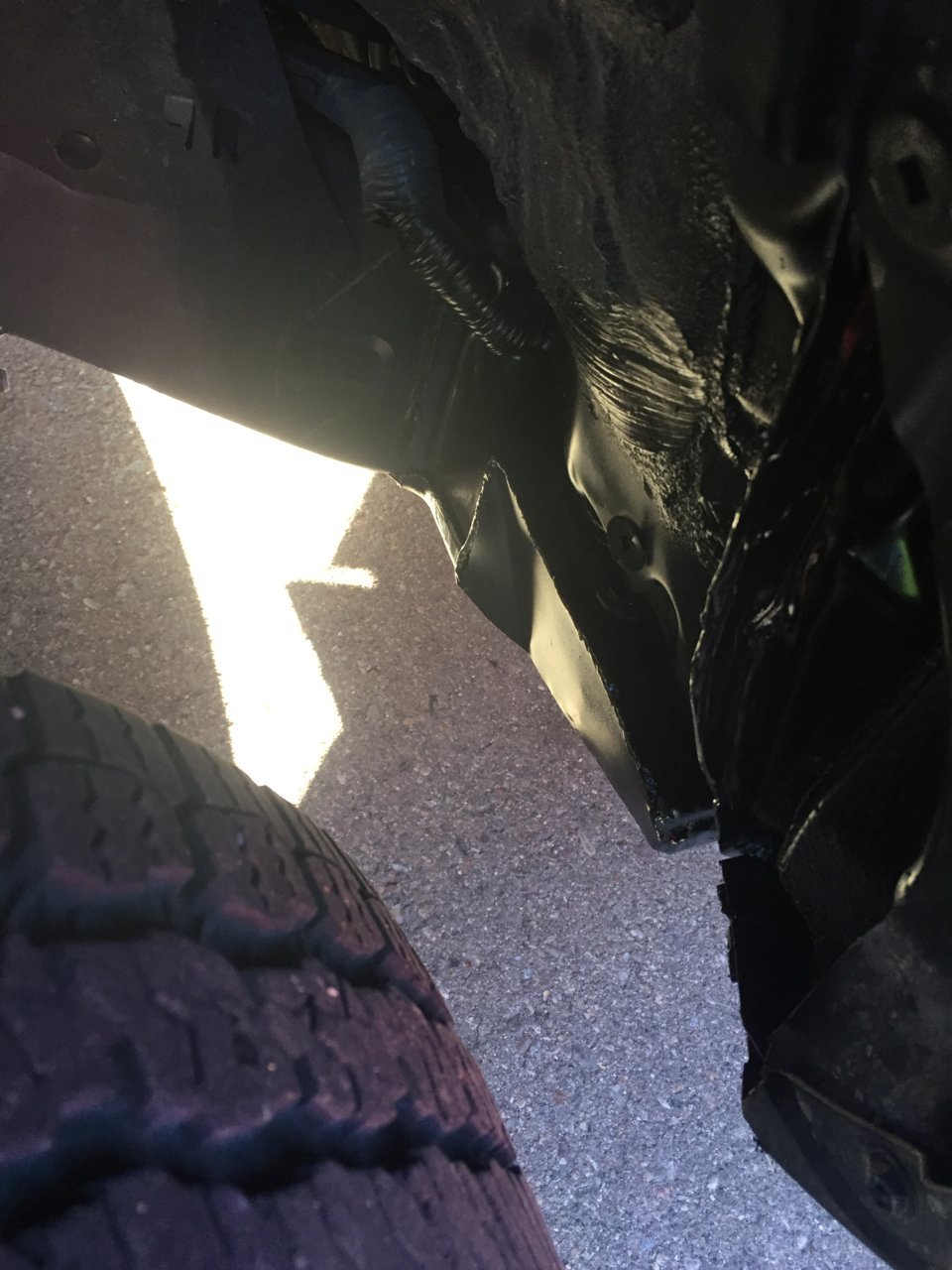

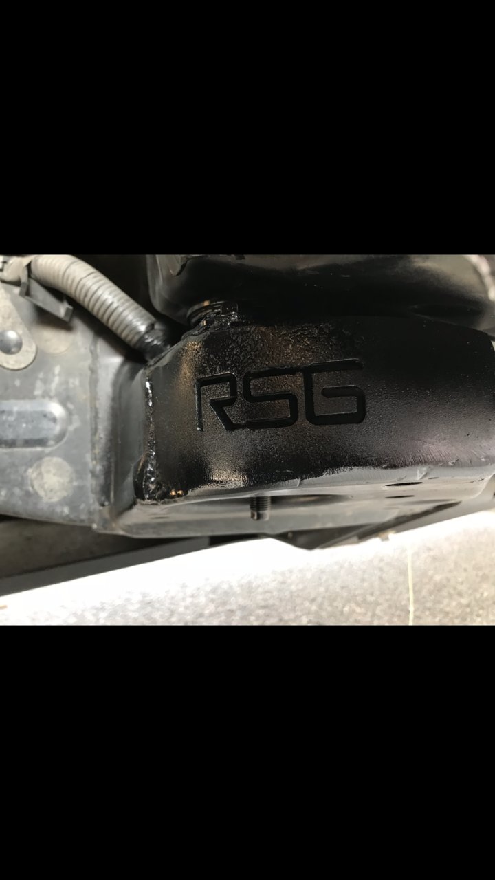

    just got my CMC done in AZ today by SDHQ, picking up the truck after work will post pics

    Man that does not look good at all and for $300 bucks they could of did a better job then that.

    If that’s what you get for 3 bills, I’m gonna start doing these out of my house :rofl:

    I was thinking it looks like I welded it with my stick welder... which means 'It ain't pretty, but it'll hold.'
    Looks like they took a grinder to the welds, and nicked up the face of the welded-in plate in the process.

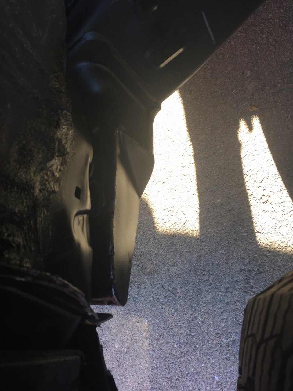

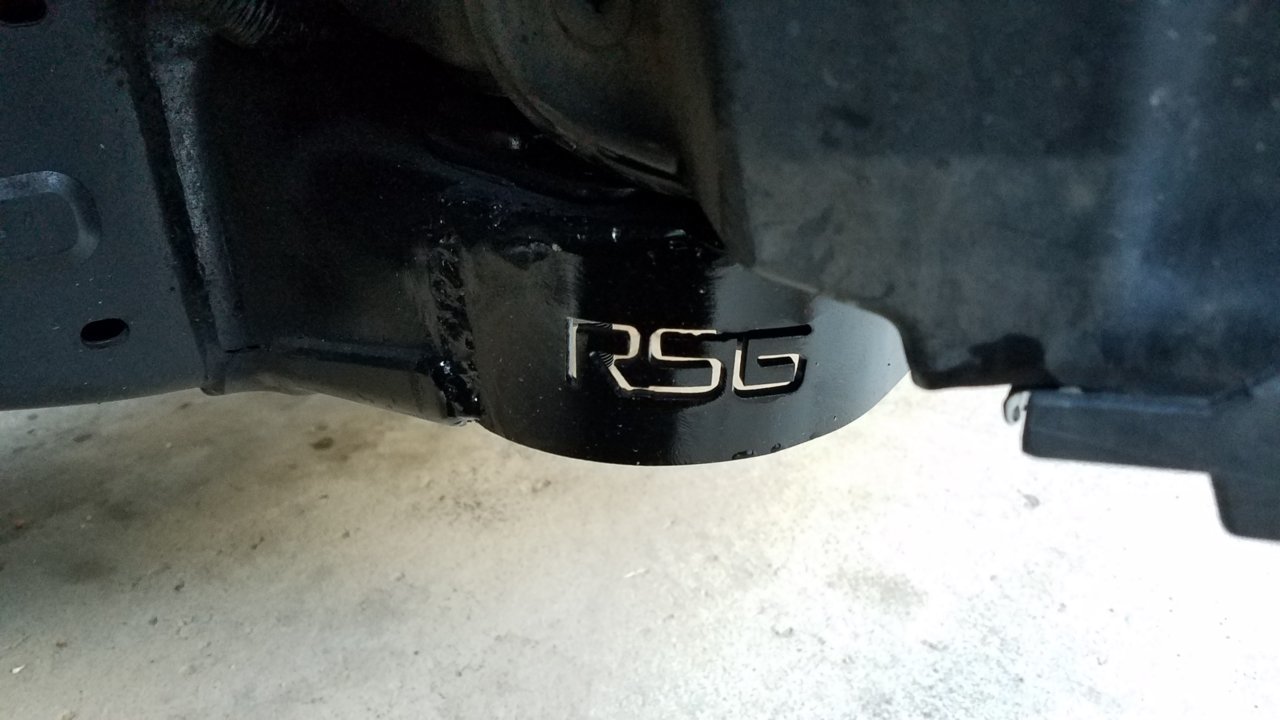

    How’s this look

    Looks right.

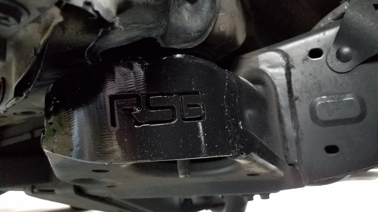

    They did mine a few weeks ago in anticipation of a lift that unfortunately hasn’t happened yet. Soon. Very soon.

    This doesn’t look as bad.

    Its pretty clean. They didnt do anything with the inner fender like Corey shows on his youtube video, but the chop is clean. I will go in and clean up the plastic when the time comes.

    Yeah, yours looks better. It looks like the plate is tilted on mine

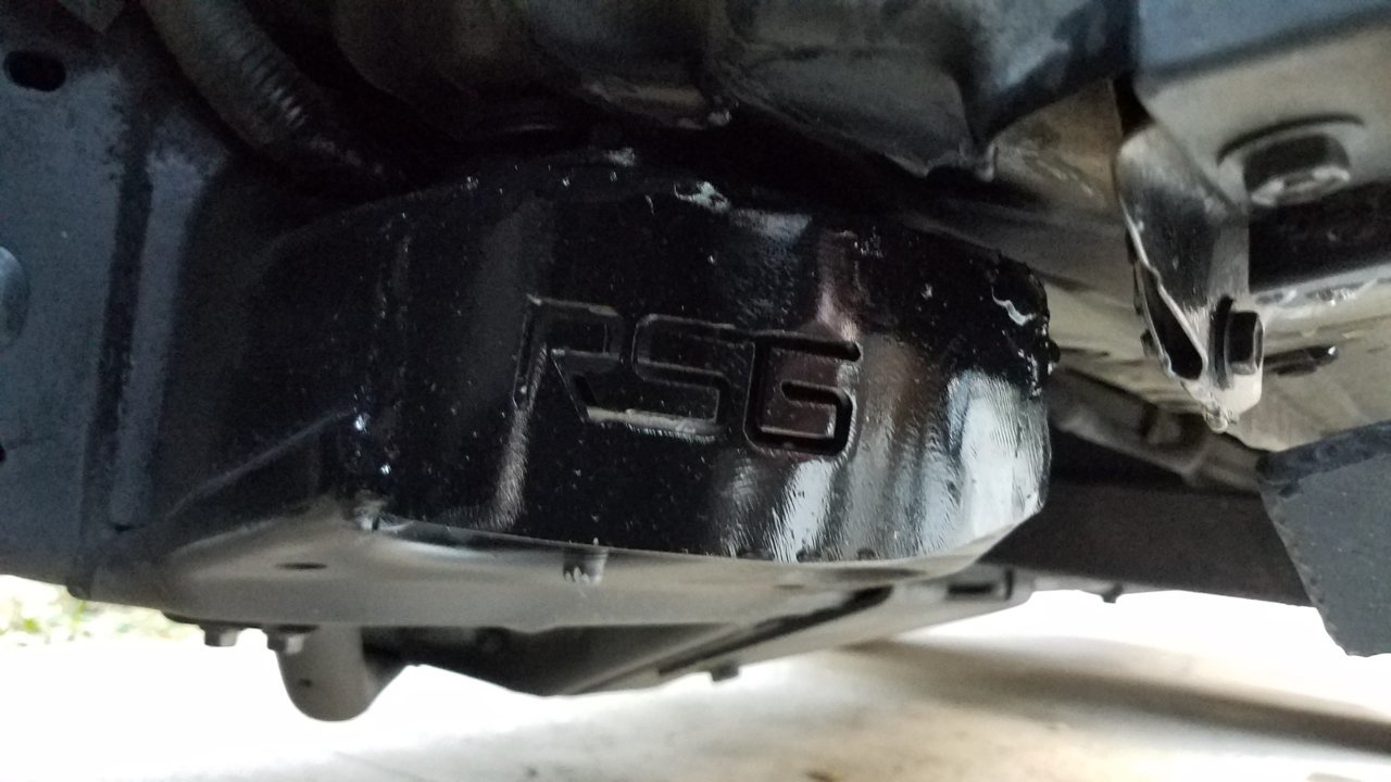

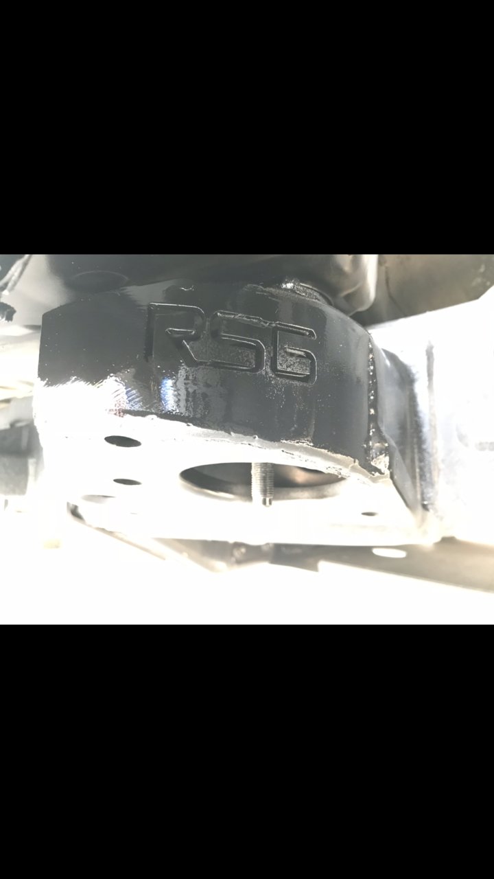

    Here's the bottom of mine... it's bad.. they took to much off looking at the other RSG Offroad CMC.
    I think I'm going to have to bring this up to them.
  13. Sep 18, 2018 at 8:40 PM
    #33
    Martyinco
    Martyinco Well-Known Member
    Aug 28, 2014
    #137132
    5,661
    Wow, that’s shit, complete shit

    I don't think it will resolve anything.... there's alot wrong here. It should have came out looking like johntoyota's.
    ... this shit is keeping me up tonight.

    Ya I would see if they could correct it somehow. The body mount is structural and while a CMC changes it, it should be done to keep its strength. Right now you have a weak point on the body mount.

    Well that’s not looking too good is it boys?! You can bet your ass this will be discussed today with whoever installed it
    I think what needs to happen now is our head fabricator Justin needs to step in and correct this. I’m truly sorry something like that left the Shop, I wish I could oversee every car that’s in / out but sometimes that’s not possible. Again, extremely sorry that turned out the way it did and were happy to correct it.

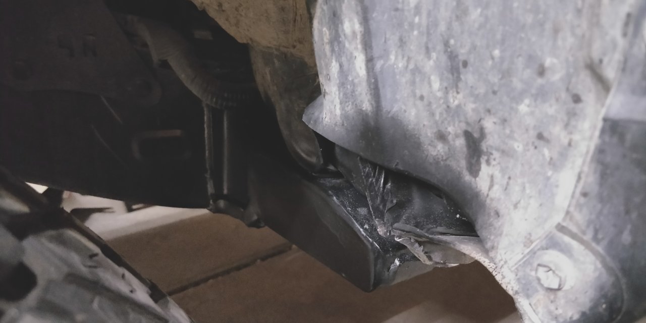

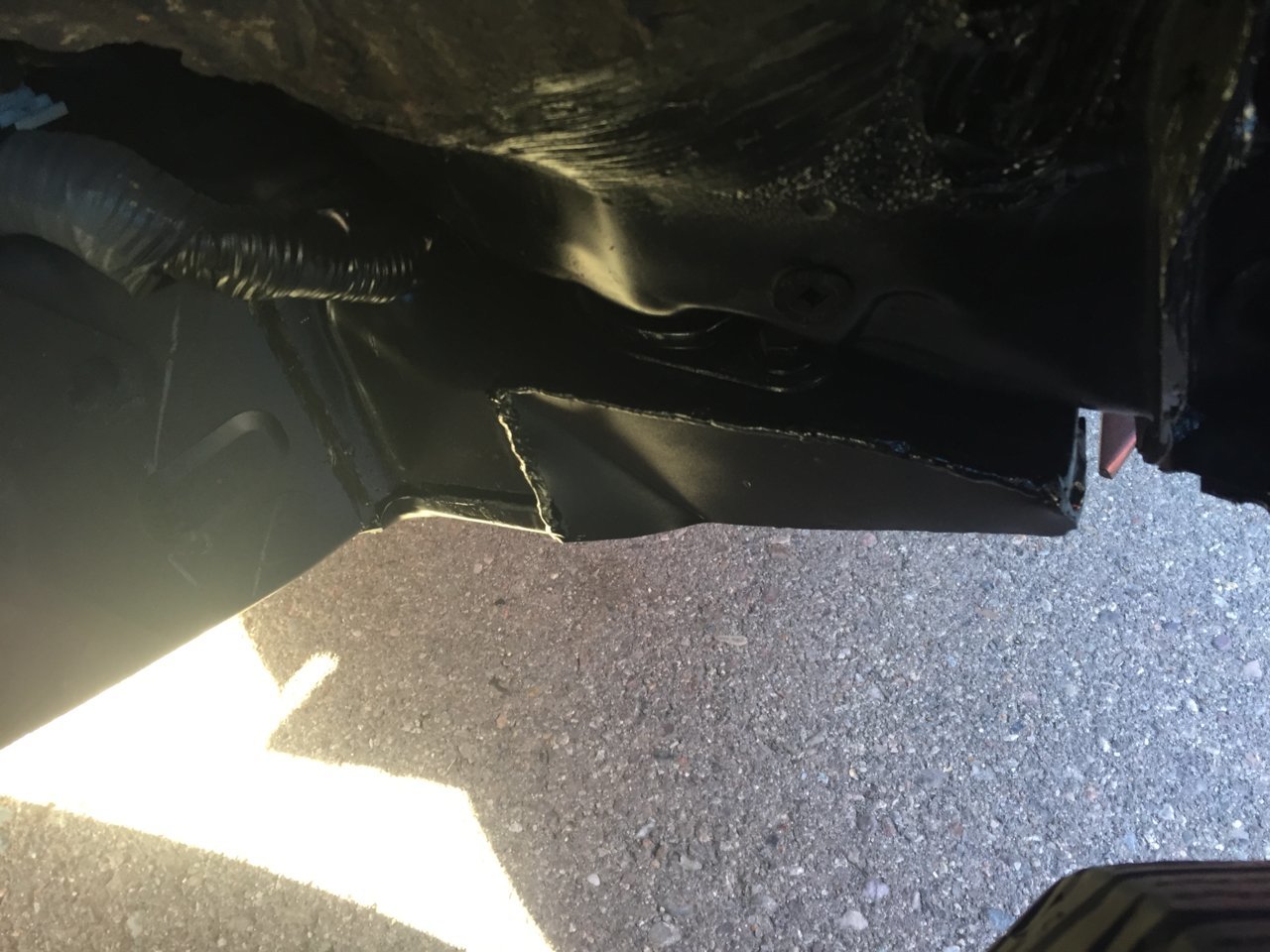

    Not enough material removed. Plate should be much closer to the body bushing. This plate is on a 3rd gen. Guy got the plates from eBay, and were not a very good fit. Large gaps to fill, but still came out looking good. I tell everyone for 3rd gen Tacoma's to either get Relentless Fab plates of BAMF plates as they are both the best fit. Looking at RSG's plates, I don't think they remove enough material from the front of the mount, or the installer isn't cutting in the right spot.

    Seriously WTH I taught myself how to weld and could weld 10x cleaner than that lol.

    The plate looks like it would almost rub worse. That will never clear 35s

    Lol it’s really not that big of a deal. It certainly is structurally fine. Mine is a cut a ton and never even plated it back in. Zero issues.
