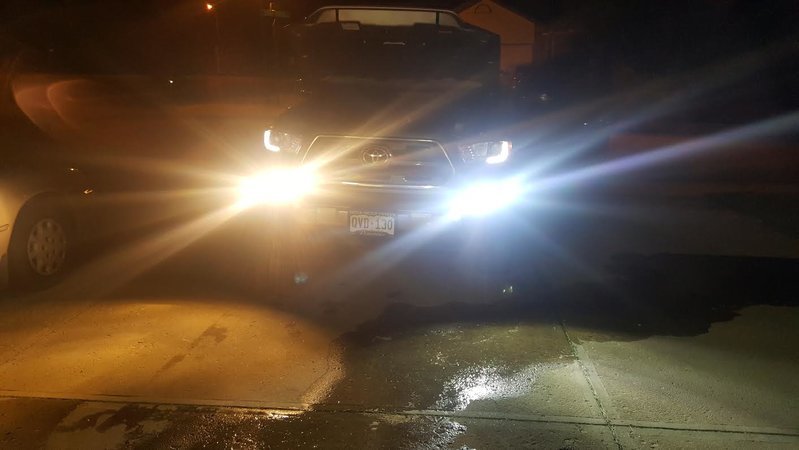

    LovelandTaco
    LovelandTaco [OP] Well-Known Member
    May 8, 2016
    #186430
    123
    Loveland Colorado
    2016 Silver Tacoma Limited
    RSI LED Low Beam, High Beam, Fog Lights
    Since I didn't have the 3000k yellow LED Kits at the time, I finally put one in so people could see the color on them.

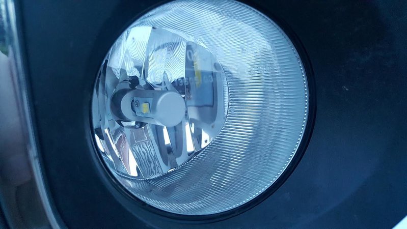

  13. Jun 25, 2016 at 10:57 PM
    #213
    LovelandTaco
    May 8, 2016
    #186430
    123
    Loveland Colorado
    You can adjust the beam pattern a little bit by using the allen key that came in the package to turn bulb. typically you want the led's to be on the left and right though. aiming your headlights will help a lot too.

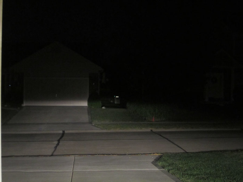

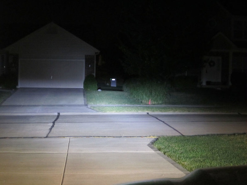

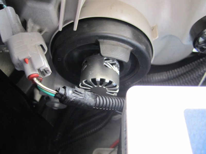

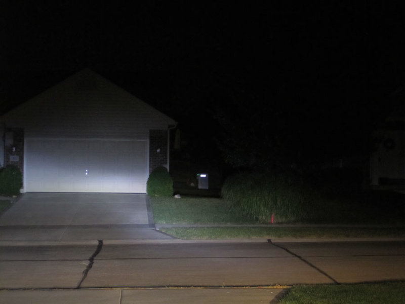

    I received my kit on Saturday and waited until dark to install them. Here are my notes:
    1. If your light is going all over the place, rotate the bulb's base (the silver round end of the bulb). It has ball detents that will somewhat keep it in place. See the pic with the red arrow for bulb base. I had to adjust one of the bulbs.
    2. I had to aim my headlights way down compared to stock. The bulbs do throw a lot more light but the scattered beam up top was much higher than it should have been. You can see the differences once I aimed the headlights. To aim the headlights, you will see an 8mm bolt on the headlight. For the driver headlight, it will be to the right and slightly lower of the bulb if you are standing looking towards the rear of the truck. It will be the opposite side for the passenger side. Turn clockwise, like you're tightening a bolt, to lower the headlight beam.
    3. To modify the dust boot, you will want to cut the portion where the square rubber blocks lead to the bulb grip. It's hard to explain. See the pic for details. I used wire snips. They cut the rubber much easier than a knife. You should be able to stretch the rubber around the base and rectangular box of the bulb. Push the rubber over the base so the boot sits naturally.
    4. The ignitor boxes get super hot. Make sure that when you zip tie them in, they're not touching other wires or hoses that might melt.
    5. The bulb base has a cooling fan I guess cuz it sounds like mini turbines in my engine bay now. haha.
    The only downside so far is that I now may need to upgrade my fogs to match :p. Then again, I don't normally check out my truck from the outside while the lights are on, so I may just for get about it.
    There was torrential rain here today and I drove through it with my lights on. No problems with the lights at all.:bananadance:
    Excellent product and customer service. Thanks again Ryan!

  20. Jun 26, 2016 at 5:10 PM
    #220
    Revelations
    Revelations Well-Known Member
    Apr 17, 2014
    #127895
    1,125
    2014 MGM DCSB
    I haven't driven at night. Just make sure you take note of your stock beam cutoff against a wall (I used my neighbor's house) and align the LED beam to that.
