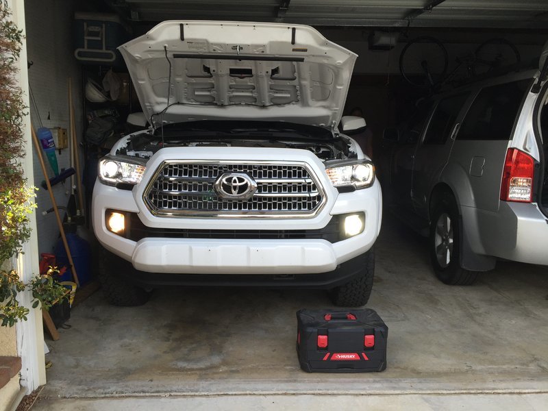

    image.jpg I installed the fogs today. Drivers side is the new one and passenger side is stock. The picture doesn't really do it justice how bright it is.
