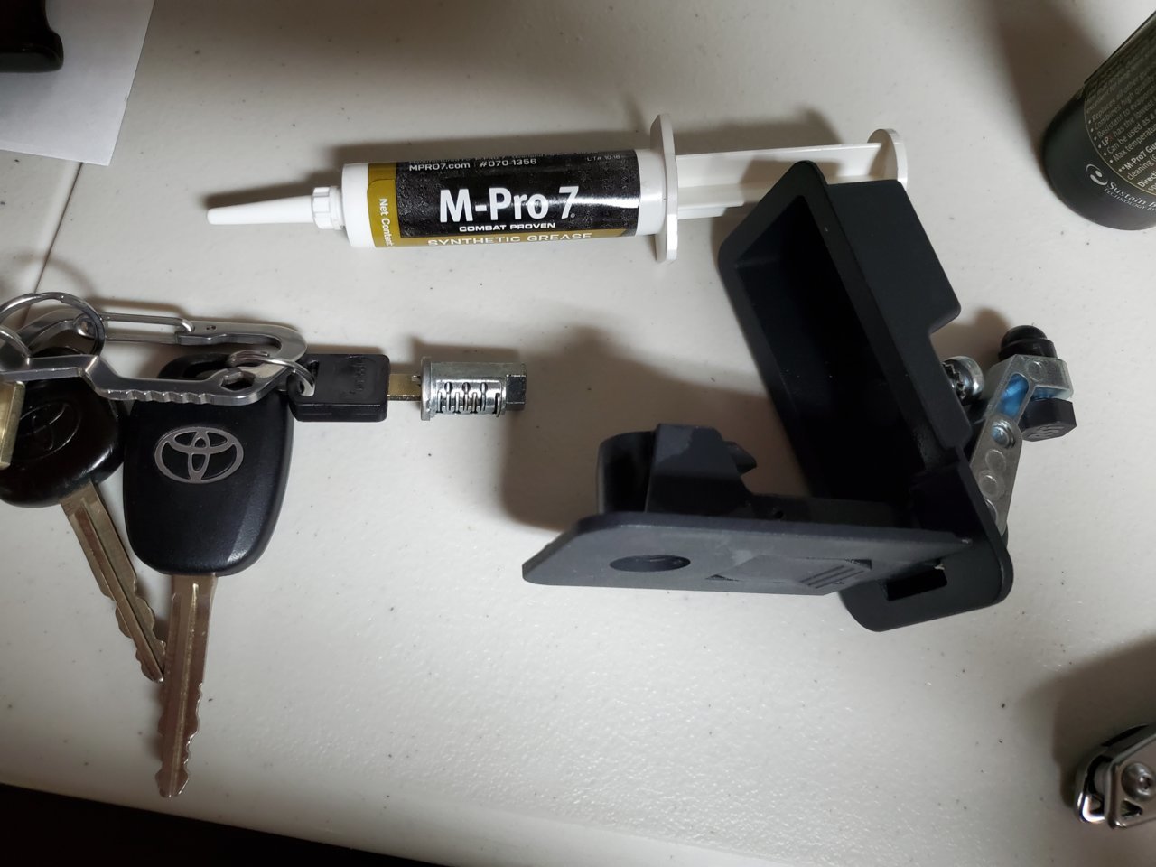

    Snow will end up packed into them just from brushing them off. Above about 20 the sun can melt snow and it can get into them.
    The lock core can freeze. The little lever you push can get ice behind it and get stuck (or snow packed in), and water can end up in the back and freeze.
    Does not happen to all of them. Working grease in did not solve it. However, when I pulled the locks to install covers I made sure to dry them out well, pulled the cylinders and packed with synthetic grease. Below -50 the grease will freeze the locks, but being in temperate Anchorage I don't really see that kind of cold unless traveling.
    So far the covers are working well.

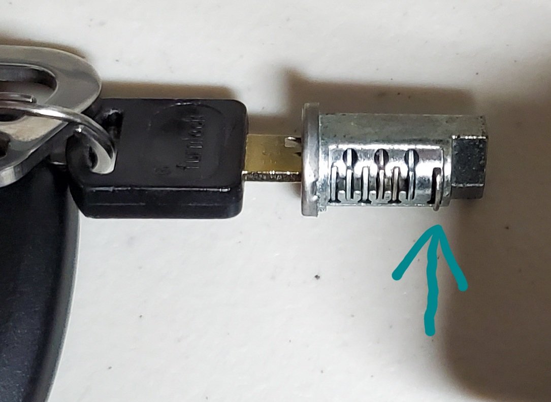

    I bought my cap from Top Notch Accessories, so got the covers through them. From the pictures they look to be the same as Mike's. I would give Mike's or Top Notch a call, both have websites that list their numbers.
    There is a small, spring loaded tab on the inside of the core. PSX_20211220_064333.jpg
    -Put your key in the lock, rotate it about 1/4 turn to give beter access to the tab.
    -Use a small flathead to push the tab in.
    -Slide the core out.
    -Keep the key in the core so as not to loose any wafers or springs.
    -Pack with synthetic grease (use something designed not to attract dirt, weapons grease like M-Pro 7 or XF-7 should work well and both have very broad temperature ranges).
    -Depress tab and reinsert the core.
