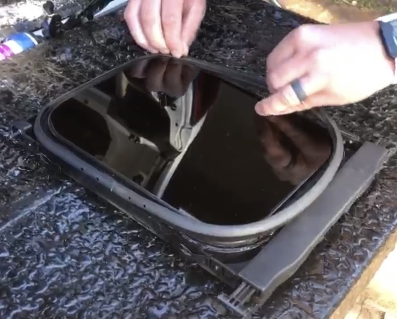

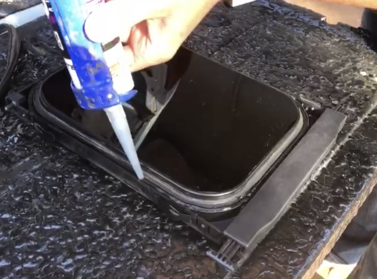

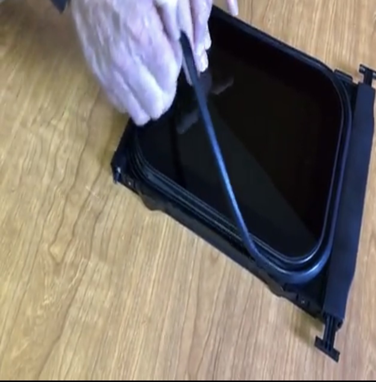

    The how to RSI sent me is a short video but I don’t know how to post vids in here. Basically they just remove the window than remove the gasket from the window apply a bead of black sealant around it than re install the gasket.
    I haven’t had a chance to do it yet but will try it in the next couple days. Hopefully it fixes the leak.
