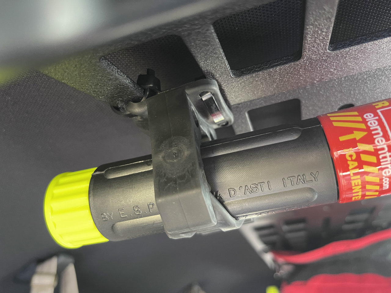

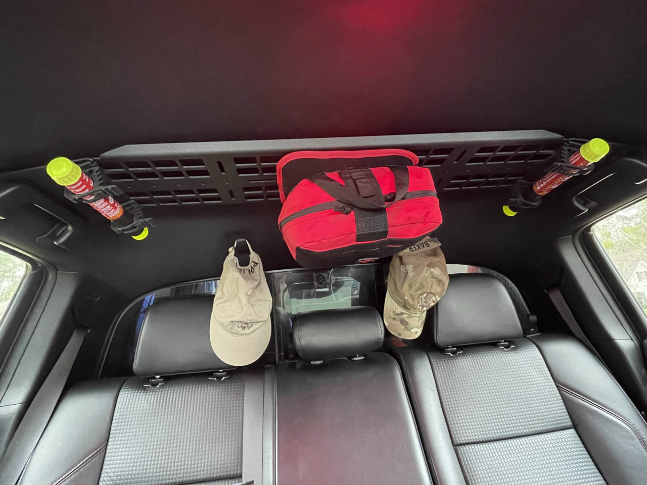

    I used zip-ties to mount my fire extinguishers with quick fists. The ones I got had holes in each corner.IMG_6278.HEIC.jpg

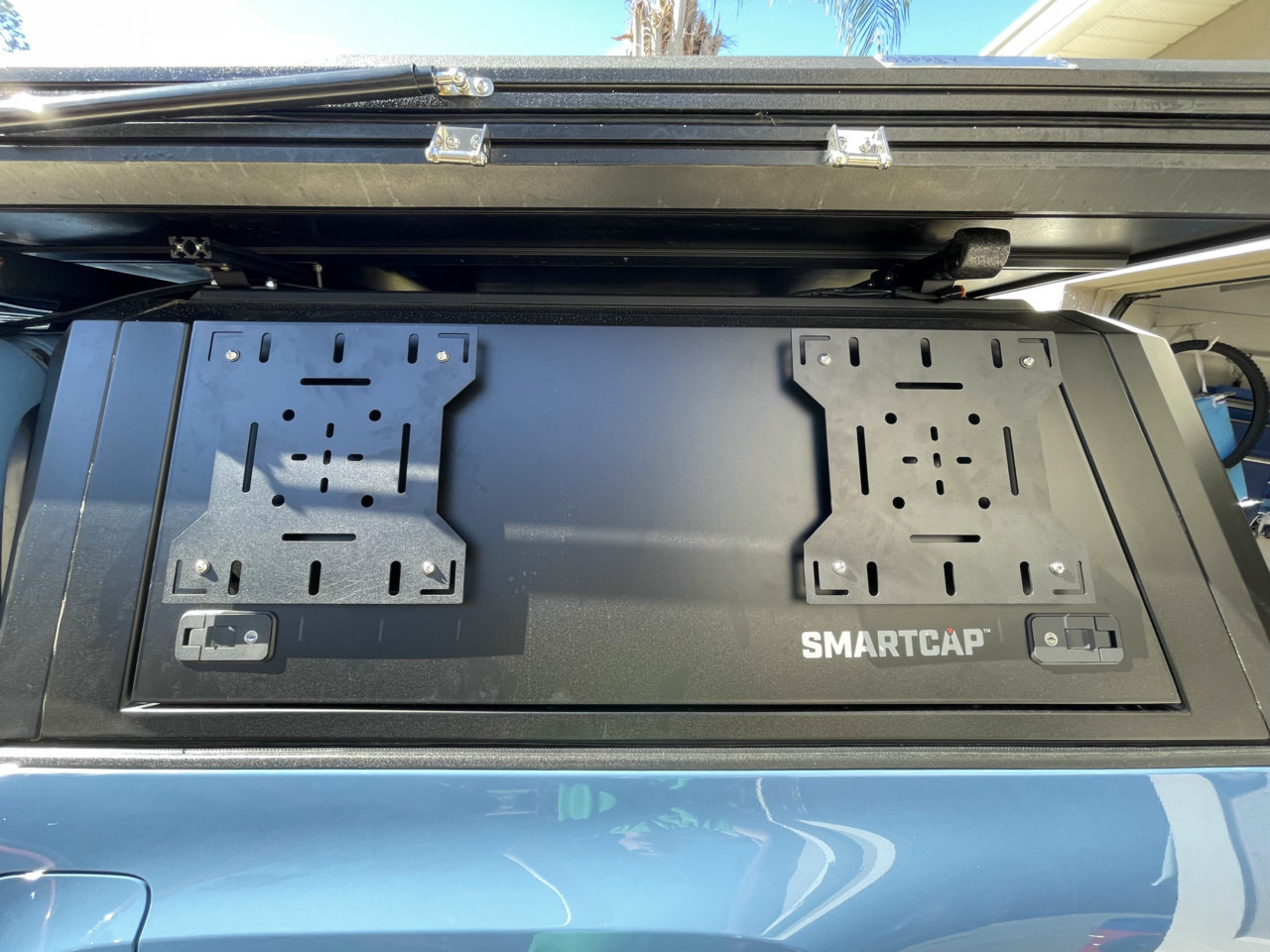

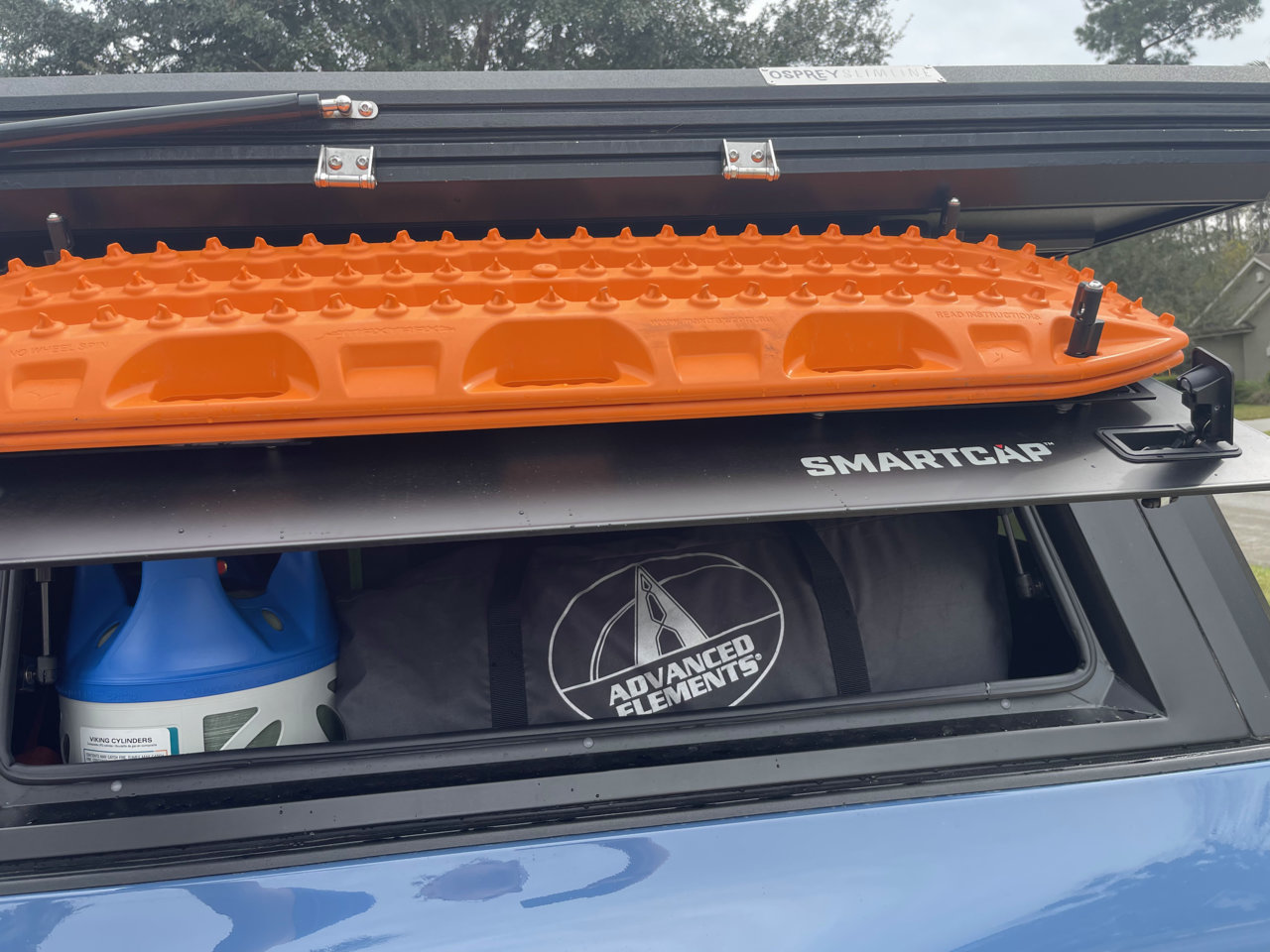

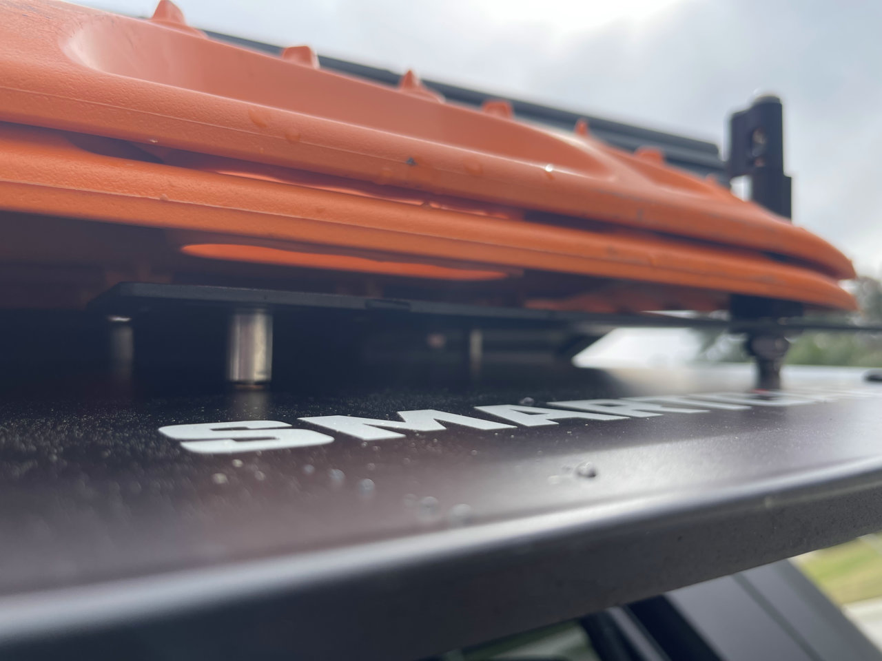

    Here are some more pics showing the stand-off and inside. I was able to slide all 4 mounts down in the mounts so the hatch opens further. I am able to remove the full sized Viking propane tank and the AE inflatable kayak through the opening with no issues.

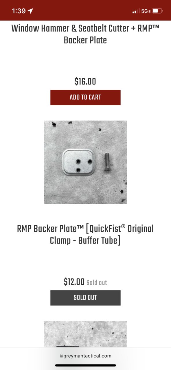

    That looks like a grey man tactical product or rip. I have one but never even checked if the rsi molle is compatible- likely not, they seem bigger on the rsi. Wish it was a standard size tbh
    Edit:
    greyman I believe will even do custom panels- kinda has me thinking how much for 2 panels sized same as the current.

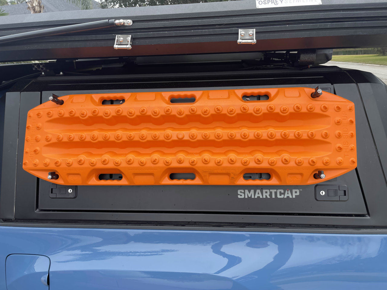

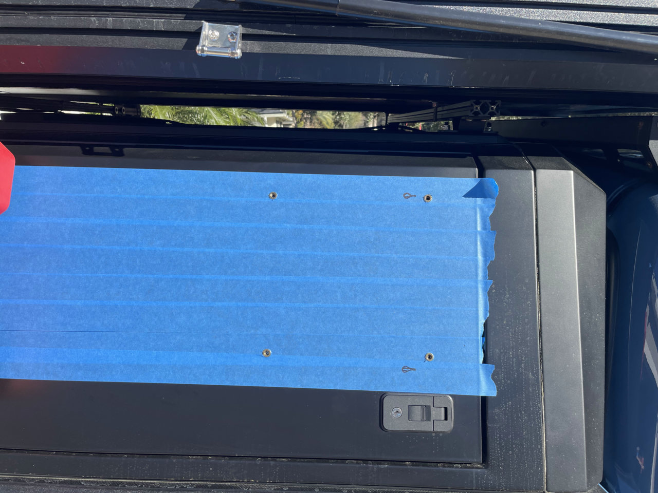

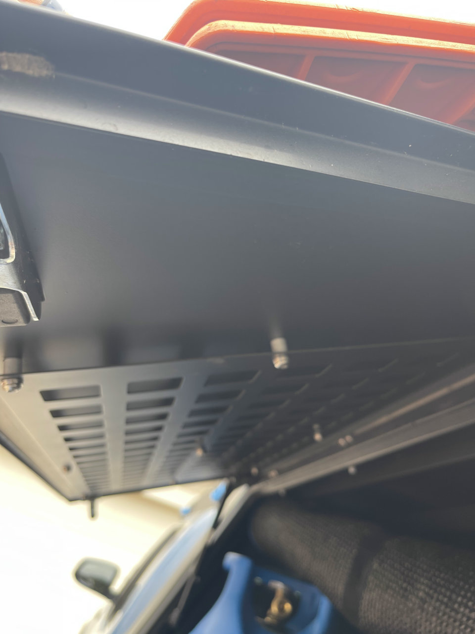

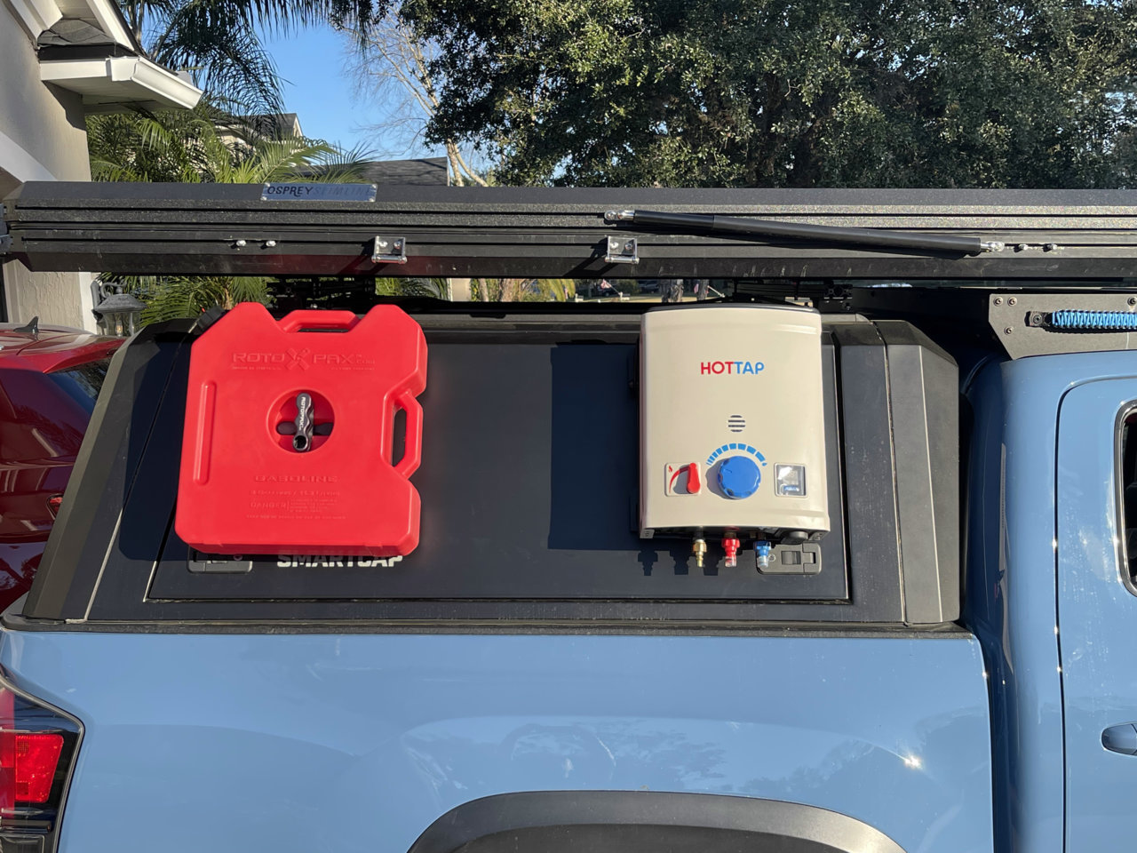

    Installed rivnuts and mounts on the passenger side of my RSI Smartcap to hold a RotoPax and water heater. The heater is of course not going to ride there while traveling.
    Topper with Rivnuts.jpg Topper door panels.jpg Topper with RotoPax and HotTap.jpg
