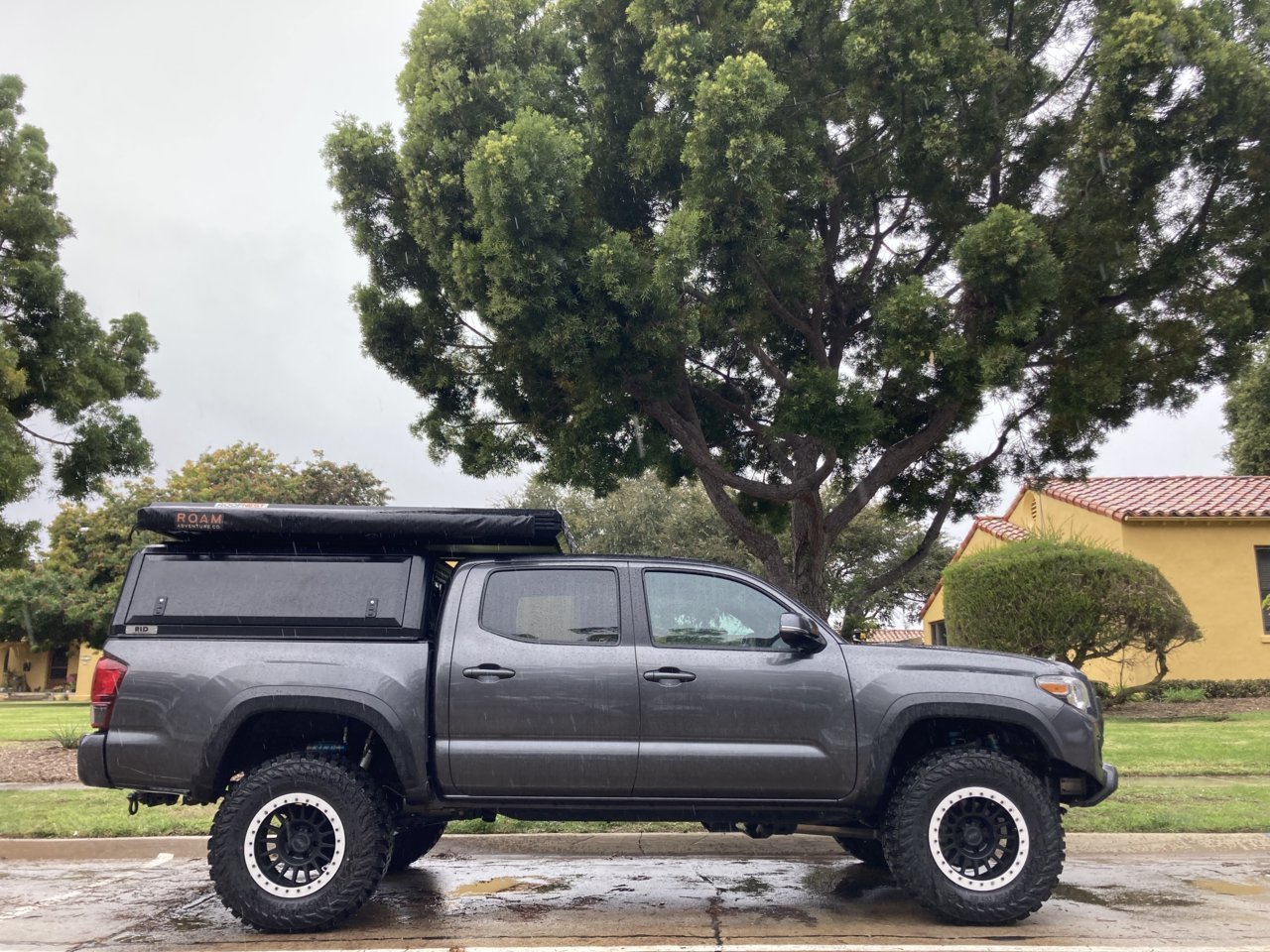

    #2486
    GOROAM
    GOROAM Where can I get Raptor lights?
    Mar 4, 2022
    #391844
    370
    19 TRDOR
    Crawling Malls
    from this angle you don’t look like you’re sitting level.
    mclslee likes this.
  7. Mar 6, 2022 at 10:22 AM
    #2487
    dingokevin
    dingokevin Well-Known Member
    Jan 5, 2021
    #351805
    50
    San Diego
    2020 TRD Off-Road
    It's sitting uphill, from ground to bottom of the flare is 35.5"
  8. Mar 6, 2022 at 10:33 AM
    #2488
    GOROAM
    Mar 4, 2022
    #391844
    370
    19 TRDOR
    Crawling Malls
    what happens in the rear when you add gear and cargo? I’m running a canopy, RTT and decked system with gear so roughly 550 lbs with stage 3 RXT Icons and i rake slightly and sit perfectly.
    i don’t think you want to sit level with just a canopy IMO; ymmv
    71tattooguy likes this.

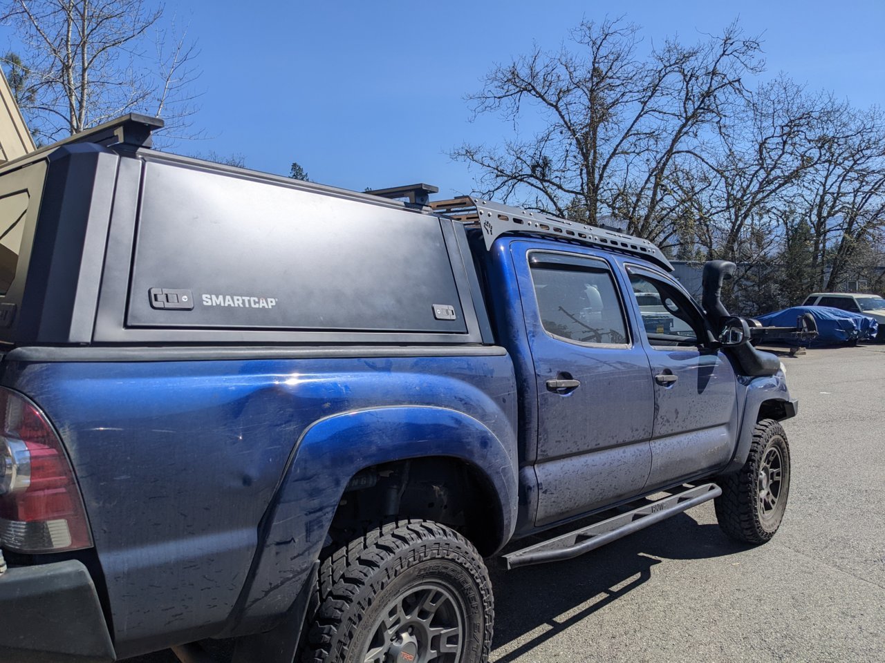

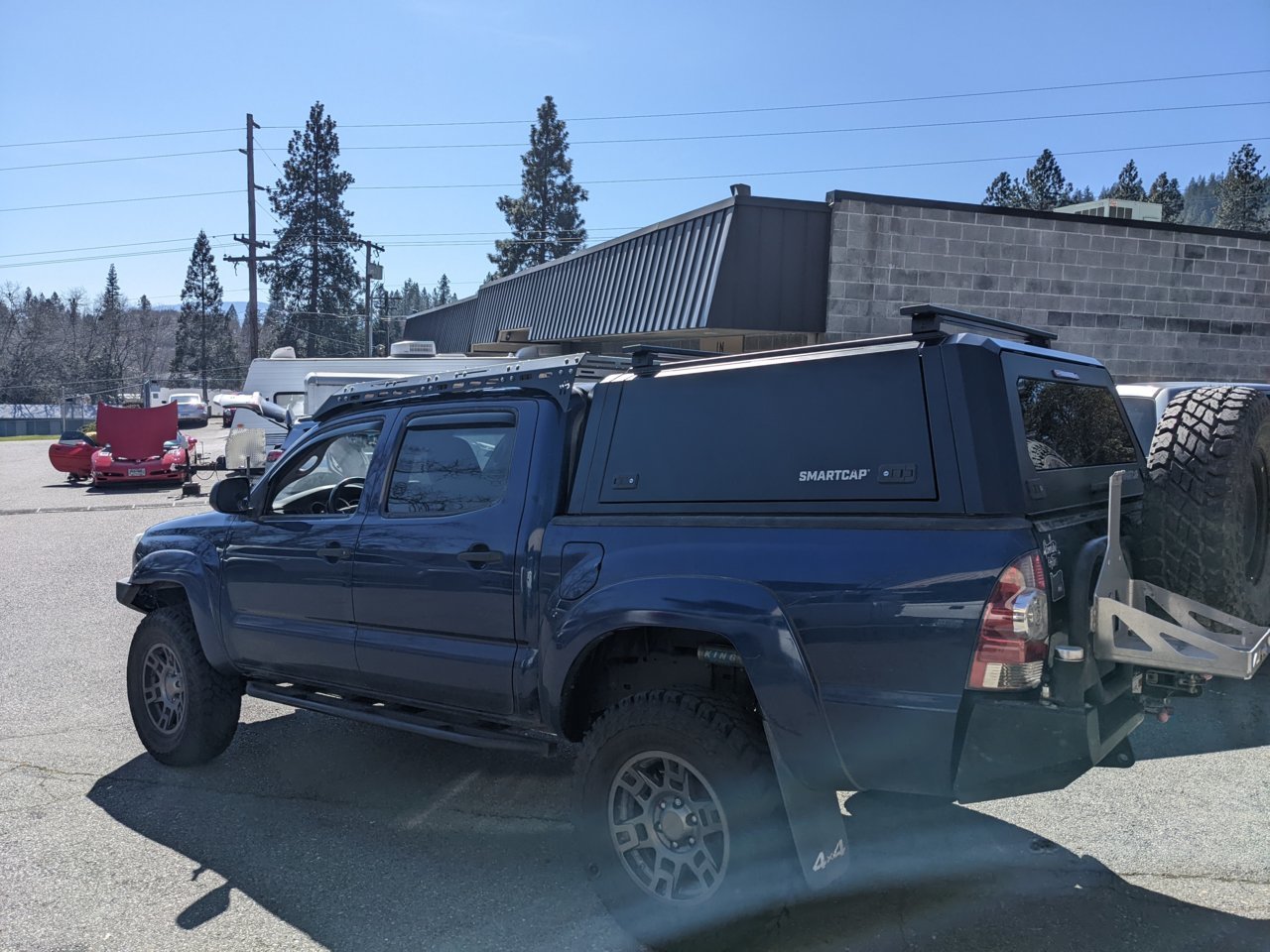

  18. Mar 7, 2022 at 5:54 PM
    #2498
    n0snl3ft
    n0snl3ft Member
    Feb 27, 2015
    #149694
    14
    Got my RSI installed today at @Mike's Custom Toys. Loving the cap so far!
    Great service and communication from everyone at the shop. They also installed a heavier leaf pack since I usually have a RTT and pack heavy for trips.
    PXL_20220307_202809563.jpg PXL_20220307_202821158.jpg PXL_20220307_203926455.NIGHT.jpg
