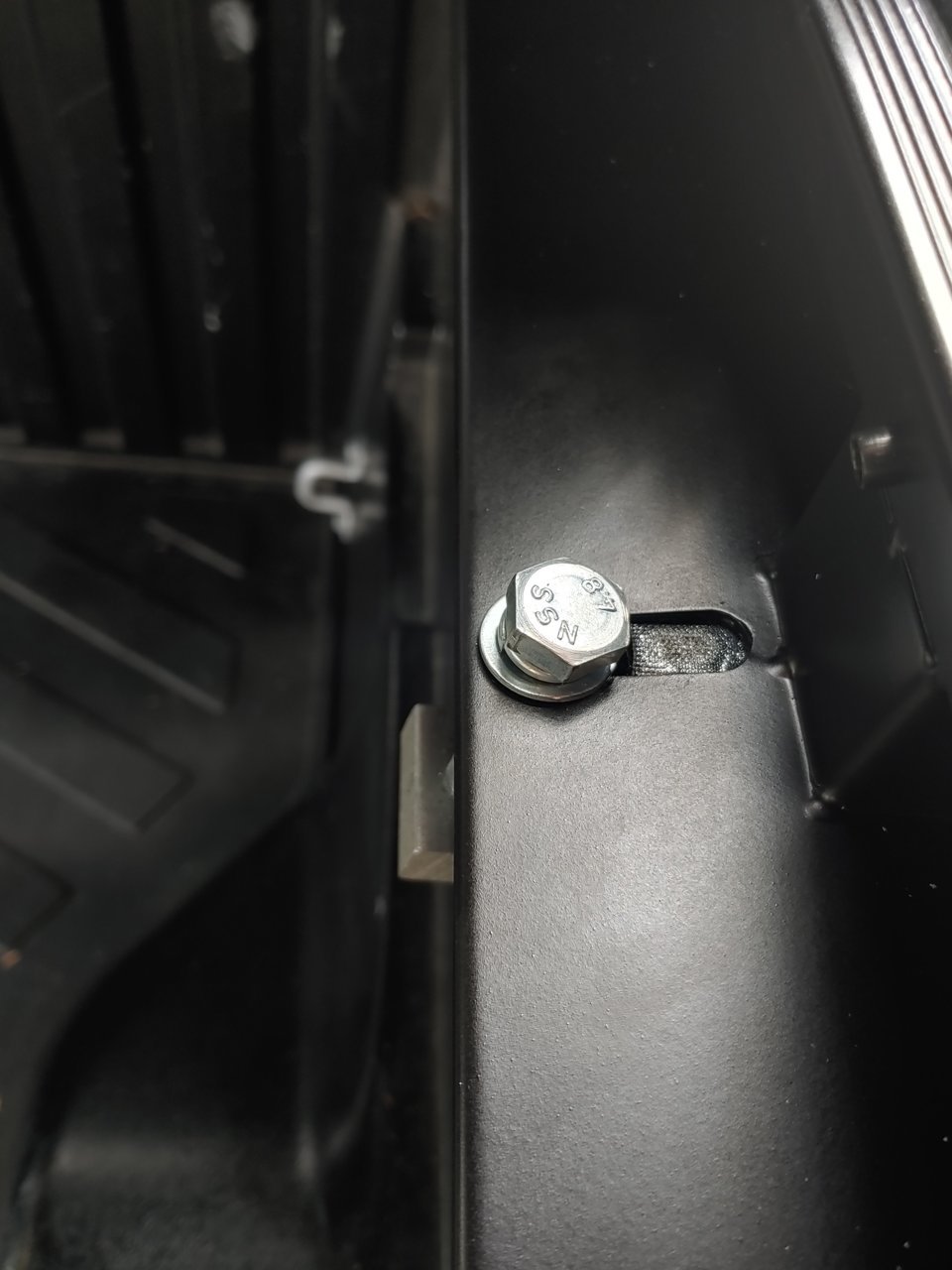

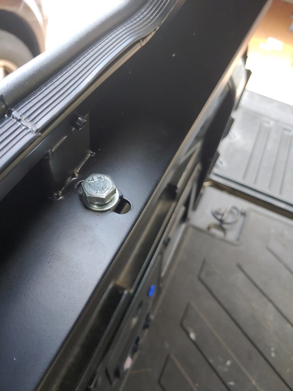

    Anyone else notice when torquing the bolts down to the bed rail, that it's bending the bolt holes of the cap? Both bolts closest to the cab are in closer to the bed than the rear bolts which are further out.
    Closest to cab:
    Closest to rear:
    long shot of rail, can see that middle and furthest (cab side) bolts are pulling lip down and are at an angle vs the bolt nearest the tailgate.

    That is fairly normal. You can back the bolts off a little. We usually torque the ends to 8ft lbs and the middle to 7. Just be sure to check them after a couple drives to make sure they are still tight.

    Yep, did all mine by feel. This is well documented in the 2 RSI threads here.

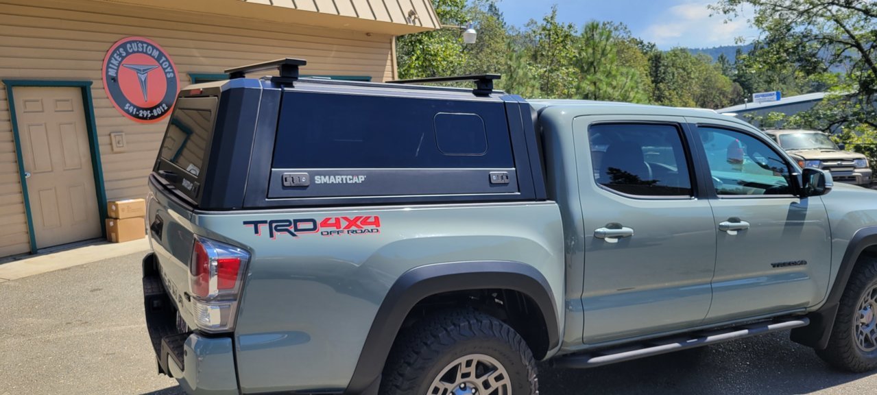

    Today's install. We still have more available

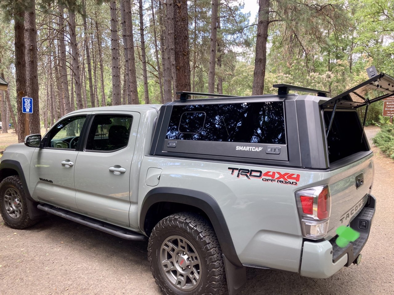

    Got my cap installed today by Mikes (Mike also posted above).
    What a great experience with Mike and his team - PURCHASE FROM MIKES WITH TOTAL CONFIDENCE. Cap fit perfectly and looks great. Very well manufactured and came all the way from South Africa without a mark - perfect fit and finish.
    Had a bit of a wait from manufacturer with all the supply chain issues but well worth it. Kind of envious of you folks out there that can get one without the wait 9BD6BB19-A3CF-4D4A-B804-C1917ED2CA21.jpg
