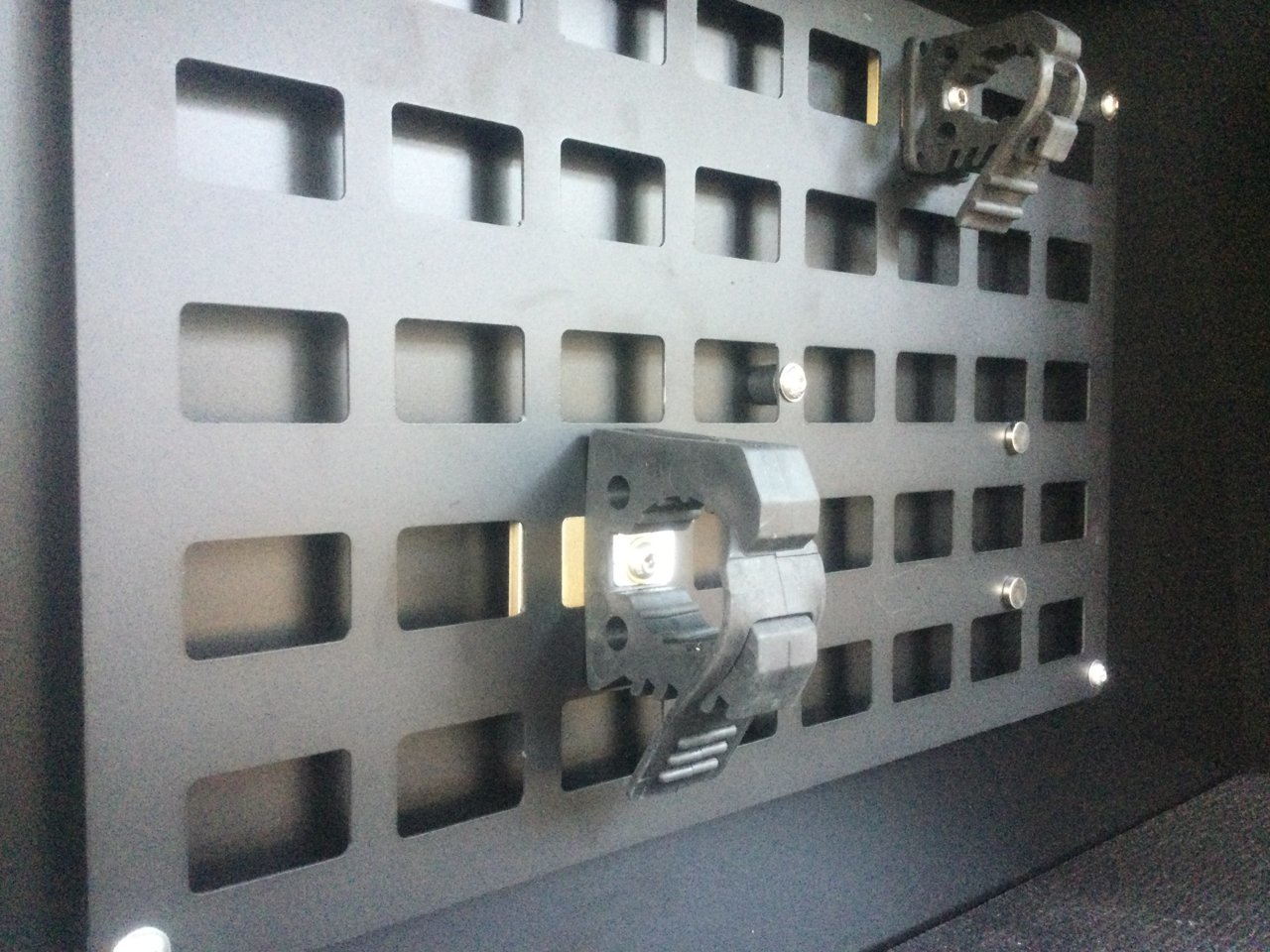

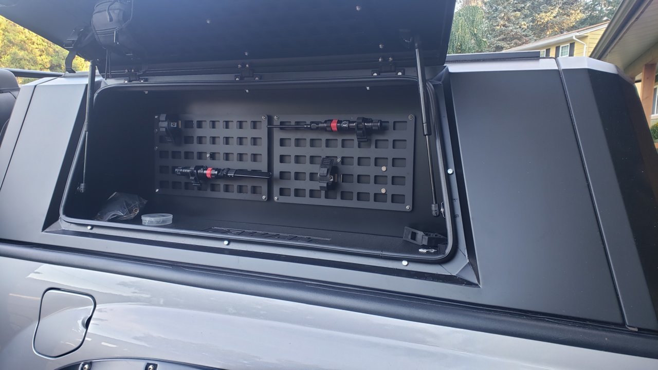

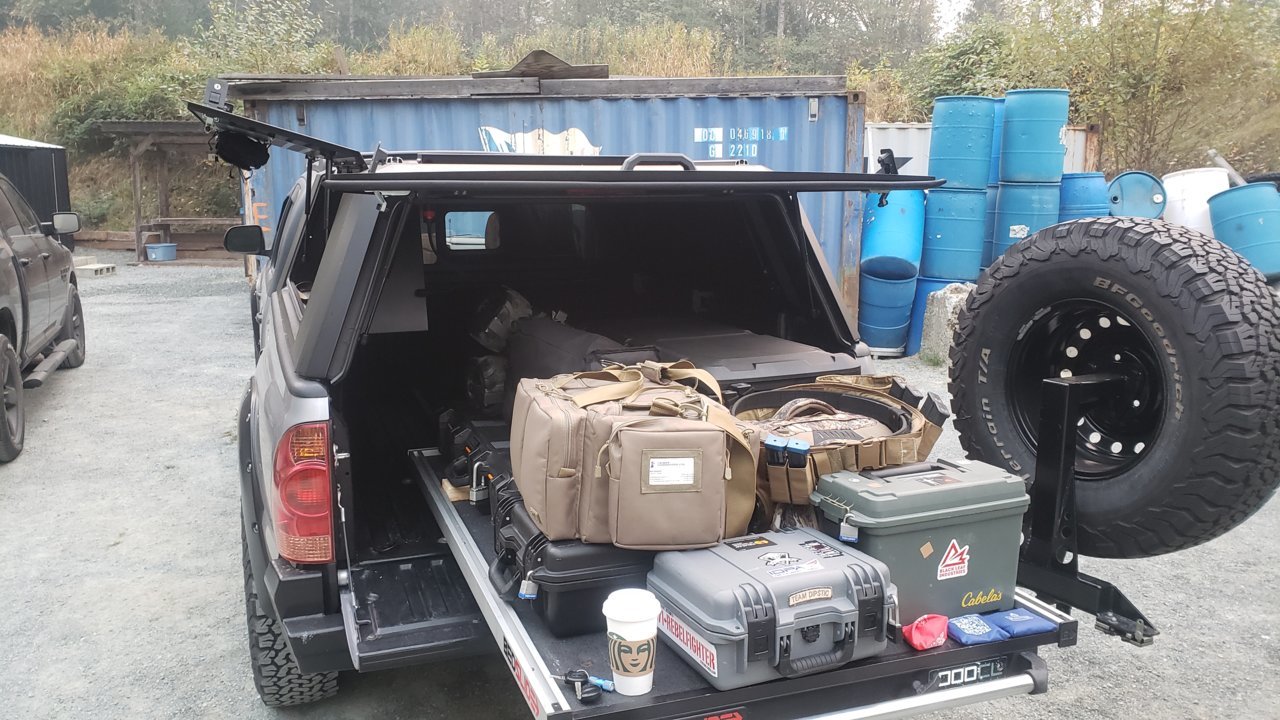

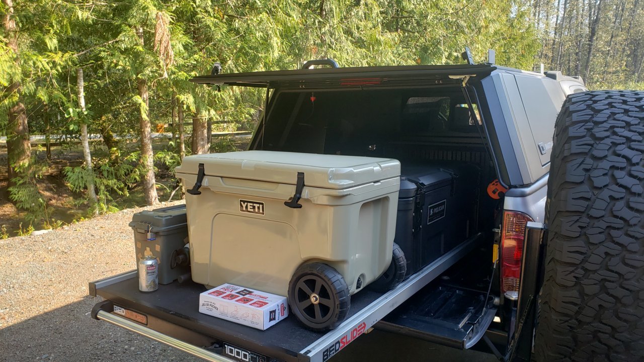

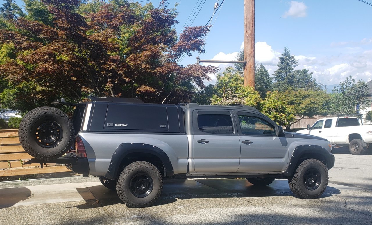

    Well my long box 2nd Gen SmartCap finally arrived and I’m pretty darn happy so far . Got the utility bin on the drivers side so F13EF037-A0A6-414C-9C79-1F51668D0B78.jpg 0799141D-DC8C-42EB-93DA-3A44F9D5CEC4.jpg 714FF66A-4245-433F-8C79-489A9BCE9EE0.jpg I had to machine up some backing plates to accommodate Quick fists . The molle panel openings are smaller on the utility bin wall than the panels on the opening doors. Can post pics of those if anyone would like to see them. Bedslide sure makes the bed area accessible. The truck rides a lot nicer with the load too. I’m on a Toytec 3 1/2” lift with an hd add-a-leaf . Building a roof rack for it that will employ the exact same crossbars the Prinsu uses. Will post up pics of now that turns out. Have a beautiful custom aluminum bed rack available now . Posted in Buy and sell Canada if you’re interested.

    I’d like to see pics of the molle backing plates please!

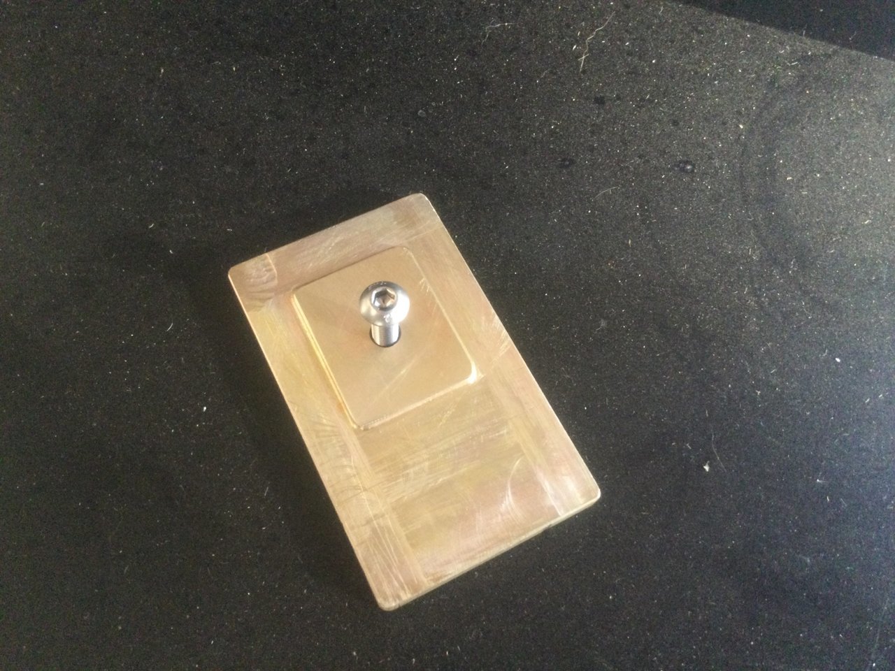

    Here’s basically what a backing plate looks like , the raised portion fits neatly into the molle panel opening. Turns out the ones on the doors are a little bit larger than the ones on the utility bin wall. The gold color is a result of “ alodining “ , a dipping process we use in Aerospace to prevent aluminum parts that don’t get some other form of coating from corroding . F6264AF6-D5CC-47E2-AFC2-D901757C4F81.jpgB980920E-5D66-45E0-BB0C-28A337841CE8.jpg5D46834F-F5FD-4008-B0D2-7A53F49FD86B.jpgFC6CFA4A-6AFF-47AD-9E2F-F7522F8D5305.jpg

    I havent even had a chance to set up my molle panels in my doors yet... been moving and all sorts of shit. I didnt even think about the backing plate to get the fists to lock in. where do I go about getting that backing plate?

    Here’s one place https://www.putco.com/product/molle-mount-plates/
    I
    ’m up in Canada so paying $30 usd plus shipping ++++ and exchange would end up costing me roughly $9,875,490,000.06 …. so I made them myself for nuttin.
