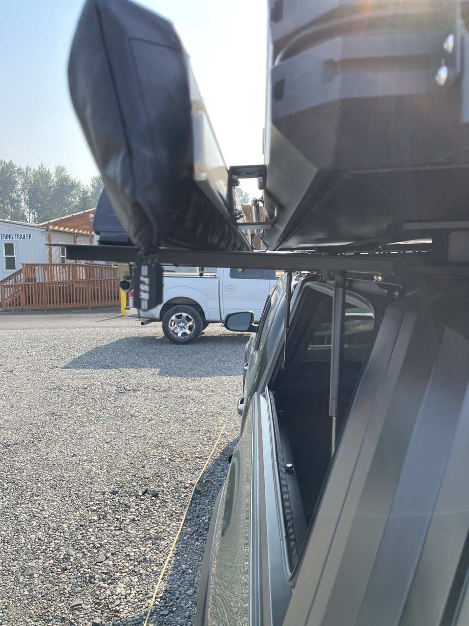

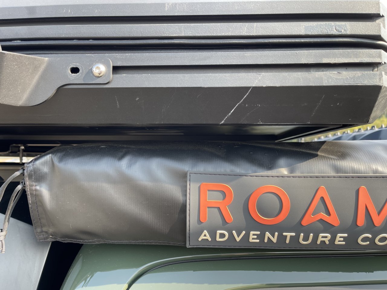

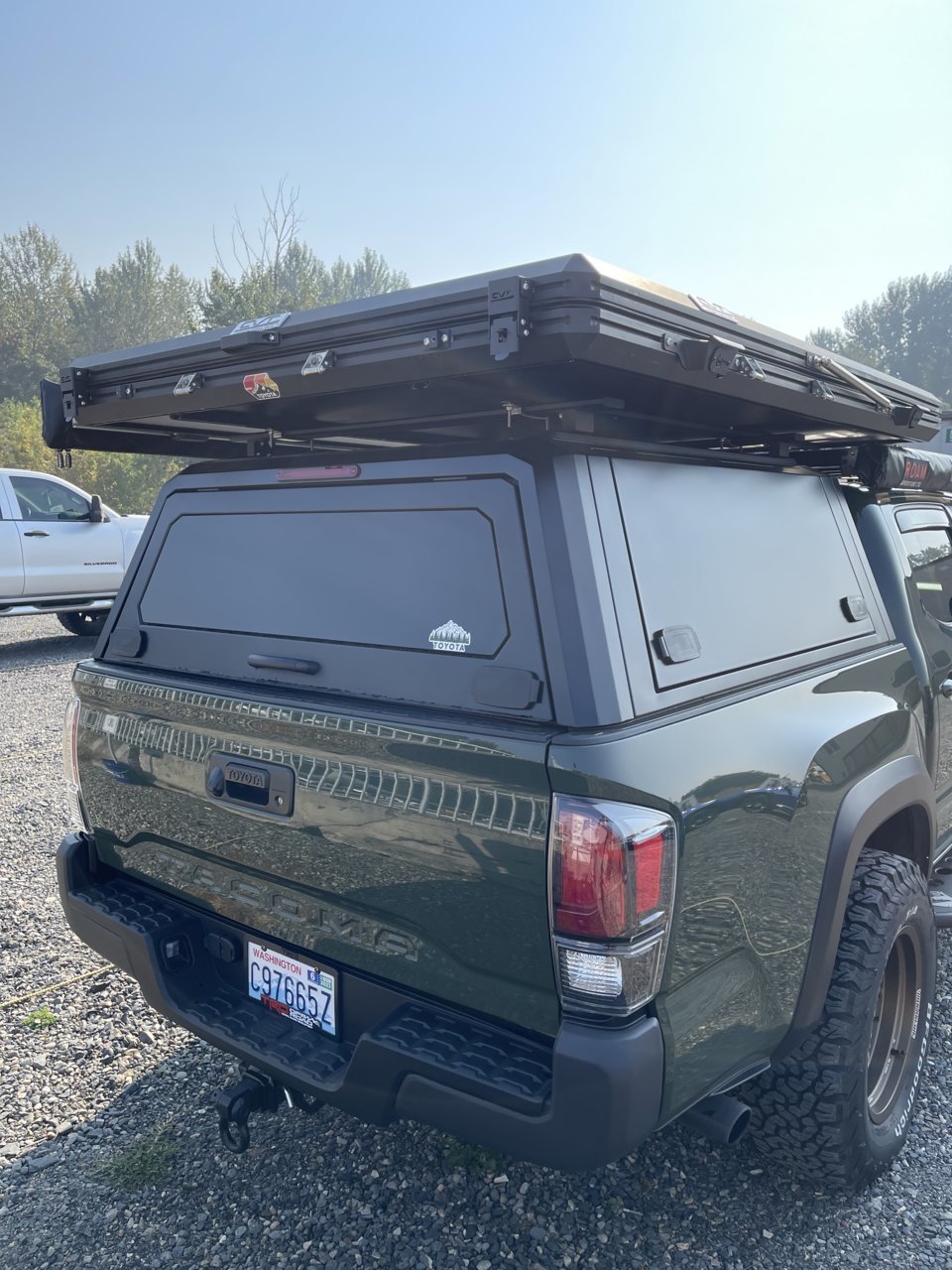

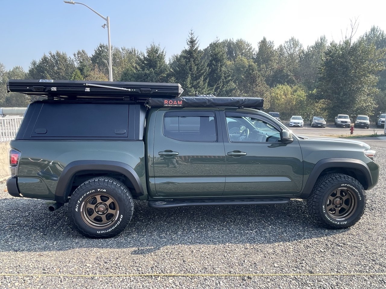

    I wanted to give a quick update on this cap for those of you that are interested. I’ve owned this cap for 1.5 years so I thought I update you all.
    To start off, this is a great cap! Aesthetic and functionality meets my expectations. The only improvements I would want to bring up are the existing seals. They somewhat deteriorate in the sun and end up leaving adhesive residue. The locks gets wet when it rains and slowly let the water inside. If it gets cold the water freeze up the locks. So far, I replaced and added these locks cover from RSI. I have not test them in the freezing temperature yet. Water seems to stay away from the locks, so that might help with the freezing portion of the locks. Water do leak in from the tailgate doors. But very minimal. Other than that this cap is solid. The load bars from RSI seems pretty solid with supporting my heavy ass tent 205lbs plus my 6.5’ awning.

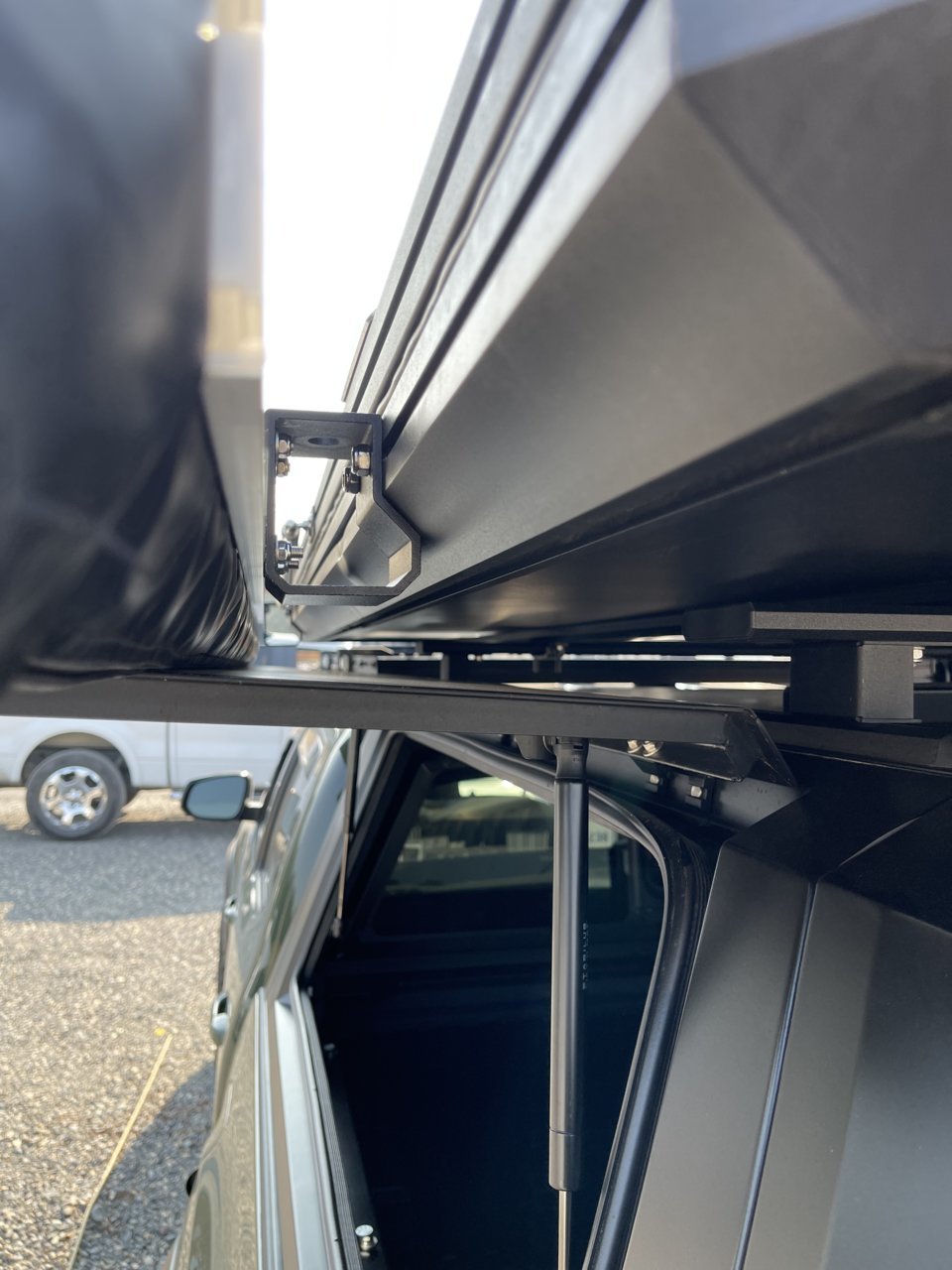

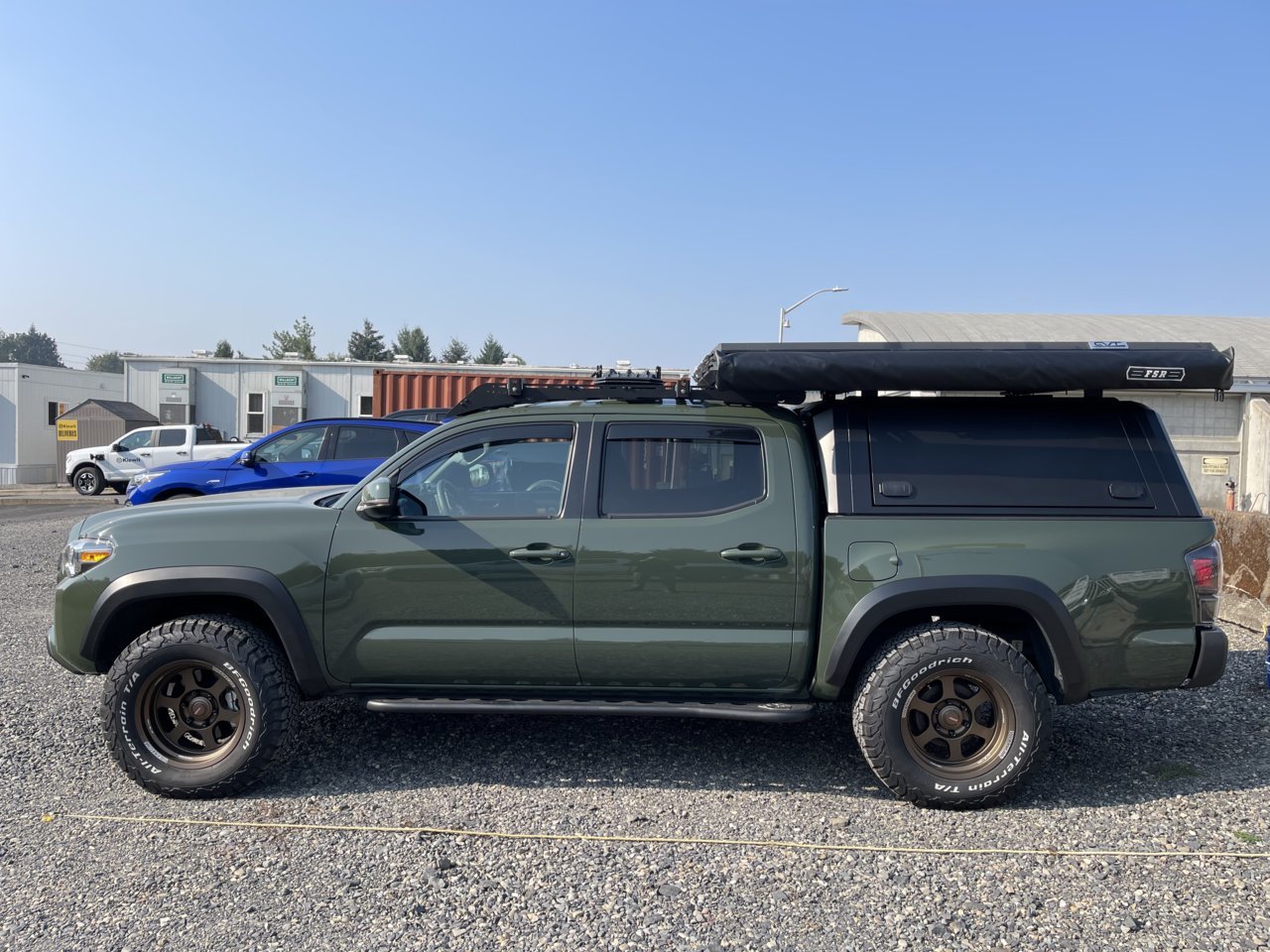

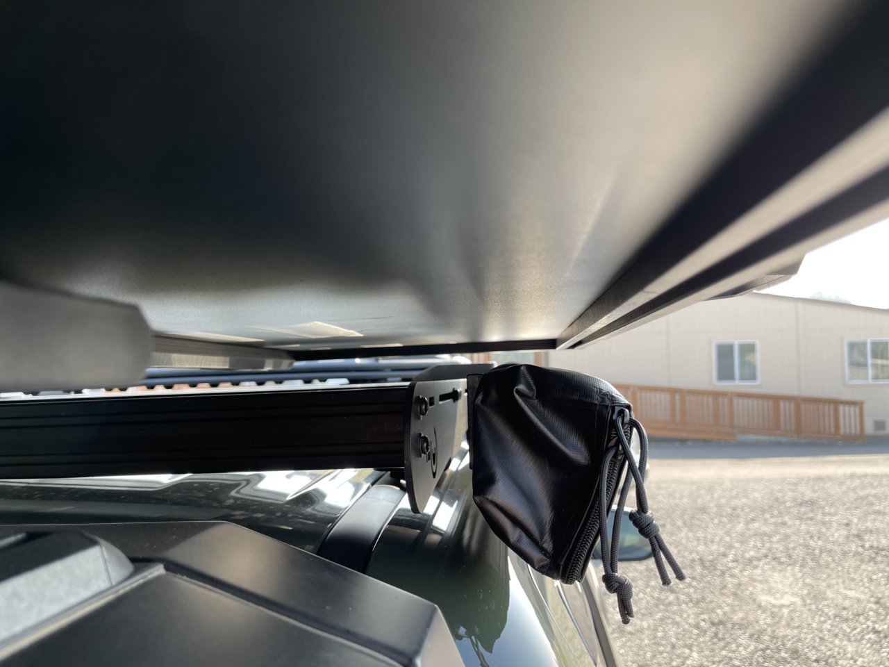

    I would be super interested to see a closer pic of your awning and awning mounts with the windoor open. I have a 270 OVS I will be mounting with my iKamper up top so it will be similar. Do your doors hit the awning or brackets at all?

    The doors currently hitting the tent and the aw
    From my previous experience with my Roofnest Condor XL. The awning I had (Freespirit), I need to offset the tent all the way to the right to clear the 6.5’ awning when the tent open. For some reason the ROAM awning sits a lot lower than other awnings I’ve owned.
    With my current setup, the doors are not hitting the bracketS. But it does hit the tent and the awning itself. The brackets I’m using goes into the CVT Tent channel so it will clear the doors. Your 270 awning need to have an extended brackets or some sort to bring it out further if you want to clear it. The awning might clear if you offset your tent to one side. Hope this helps.

    I don't have the RTT but here's my OVS270 with the stock mounts. When the awning is opened I get a little bit more door clearance but not much. I can still access the side but it would be nice if the awning was about 1-2" higher. If your awning will attach to the base or side of your RTT you may get more clearance.
