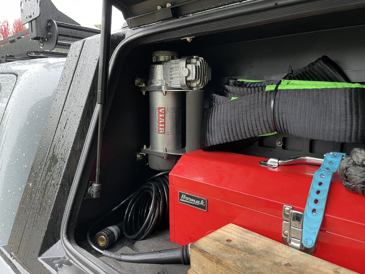

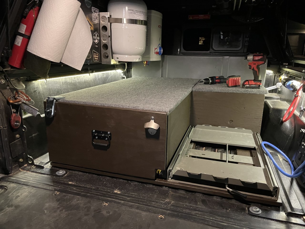

    I don’t use the compressor to pressurize the water system. Beforehand, I had a waterport that I would pressurize for water.
    The air compressor is bolted to the side of the storage bin. I ran an 8 awg cable from the battery to the bed. Drilled a hole in the composite bedside and ran the cable up to the bin. The power supply is fused closer to the battery and grounded on the truck frame. To turn on the compressor, I flick the switch on the compressor itself. No need for switches in the cab or dash. I kept it simple.
    The water supply is just an Ironman 13gal tank hooked up to an RV inline water filter and then a Joolca pump and hose kit. The pump plugs into an outlet I installed in the empty small bin on the passenger side. I waterproofed the bin to reduce water and mud infiltration on the electrical bits. It’s fused and grounded near the battery too.

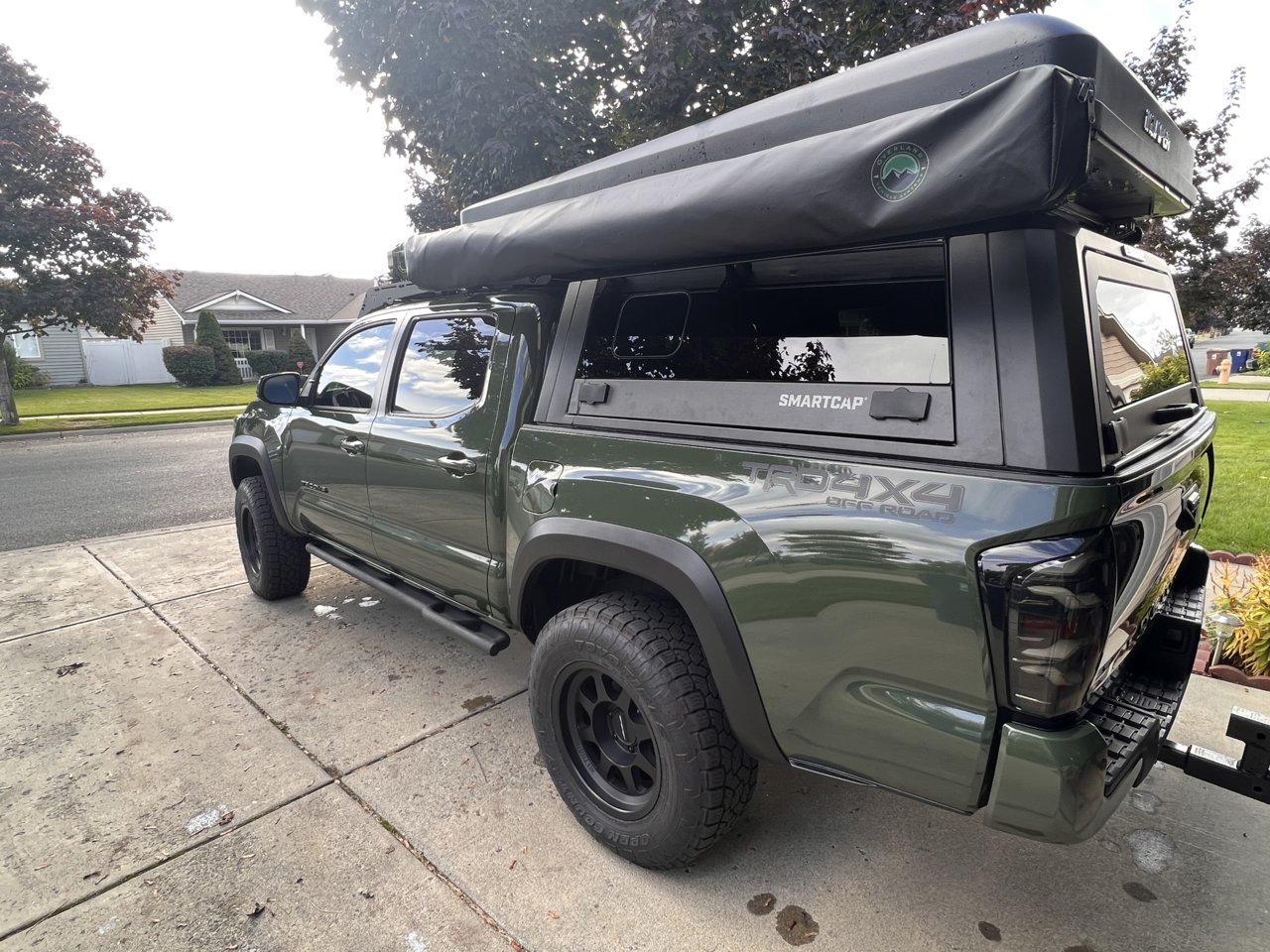

    Picked up my RSI Cap yesterday, assembled and mounted today. Thanks to Mike’s Custom Truck for the quick delivery. Unfortunately it was supposed to be an Adventure Cap. No fault of Mike’s, it looks like RSI shipped the right external box with the wrong internal windoors according to all the stickers and factory sealing. Mike’s was responsive and great to work with. They guaranteed they would make it right and ship the molle windoors as soon as they can get them. Will have to shift mounting plans til then.
    P.S. If anyone is dying to swap sport for adventure windoors in the meantime lmk :)

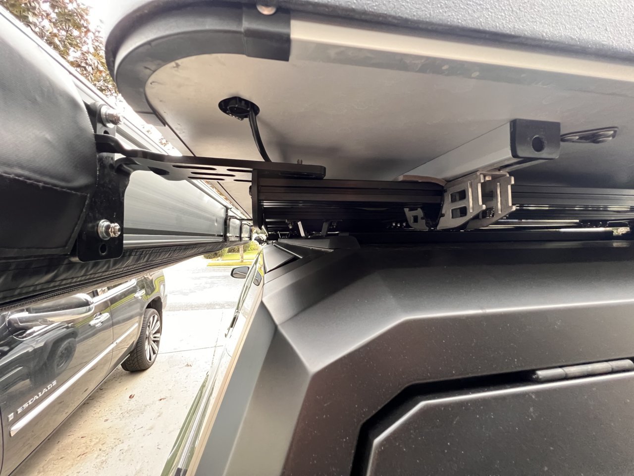

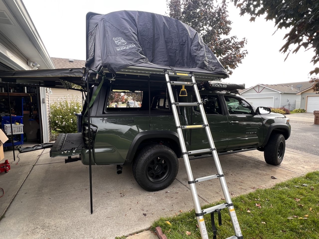

    I have a Prinsu rack on the RSI with the iKamper and OVS 270. I mounted the OVS brackets upside down which gives me just enough clearance for the iKamper to open. I am looking at ordering some of the extended OVS mounts when they are back in stock since I do not have the length onto the Prinsu I would prefer. https://runnin4tacos.com/products/r4t-extended-awning-bracket

    @Tacodog does this help? I used all of the OVS and Prinsu OEM mounts. Had to drill out the Prinsu mounts to fit the M8 hardware for the RSI.
