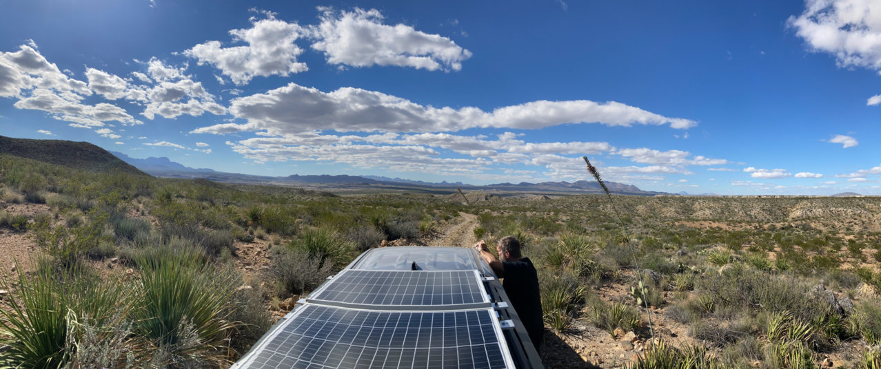

    I'm running two 100W panels up there now. A little more dust, but not bad.

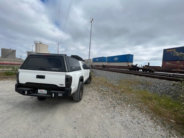

    I went this route-- simply swapped doors with another member on here. It is the best of both worlds IMO and super happy I did it. My bin on the driver side has a solid door while my dog sticks his head out the window on the passenger side.

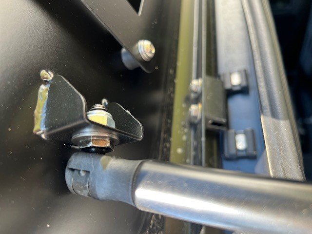

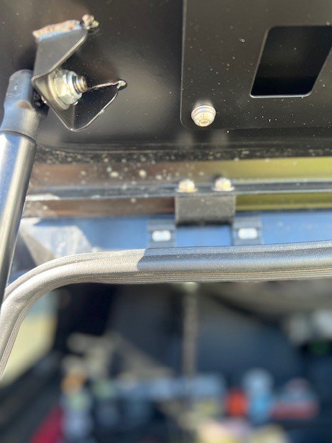

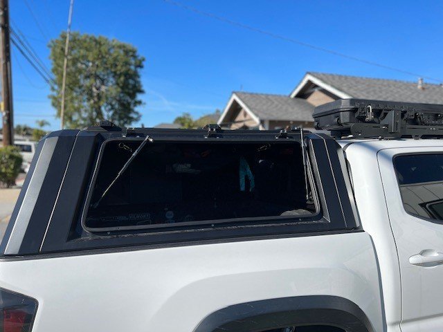

    Honestly it is easier than you would even anticipate. I removed it by myself in ~15 min or so, you just need a a 10mm and 13mm socket and a SKINNY set of plyers or box wrench for the strut connection. I found a cheap throw away box wrench that had come with a piece of furniture or something that fit perfect, but I forget the size off hand.

    Awesome, that's pretty handy, thanks for the pictures, I appreciate it!

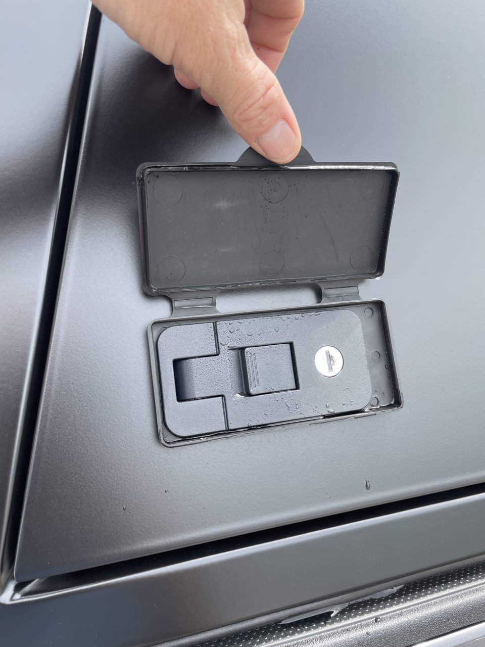

    Any reason you're not using these?

    Honestly I find the locks to be terrible even in warm temps. Always seems like a fight to get the key in all the way or pulling back out. Need yo lube but that always seems to attract dirt.

    Ever tried graphite powder? Won't attract as much dirt and it should be sealed a bit better with the covers installed. Just a suggestion - I haven't gone this route.

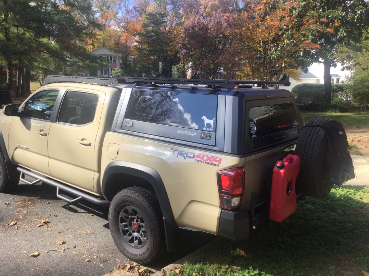

    I was honestly hoping the redesigned locks would be on the street by now. They were supposed to be out in the Spring, then the Summer… and now maybe by early 2023. My locks started getting a little gritty / sticky in September, but I hit them with graphite and it seemed a little better. I went to lock my cap the other day and the key won’t even turn in either of them. I hit them with some heavy duty lube and let them sit overnight… nada.
    Both latches on the side doors function beautifully, so I may swap one off one side and onto the back so I can at least lock one of the latches on the back hatch. This cap is amazing, but the latches are a serious flaw.
    (pic for a little appreciation of my hunting / camping truck)
