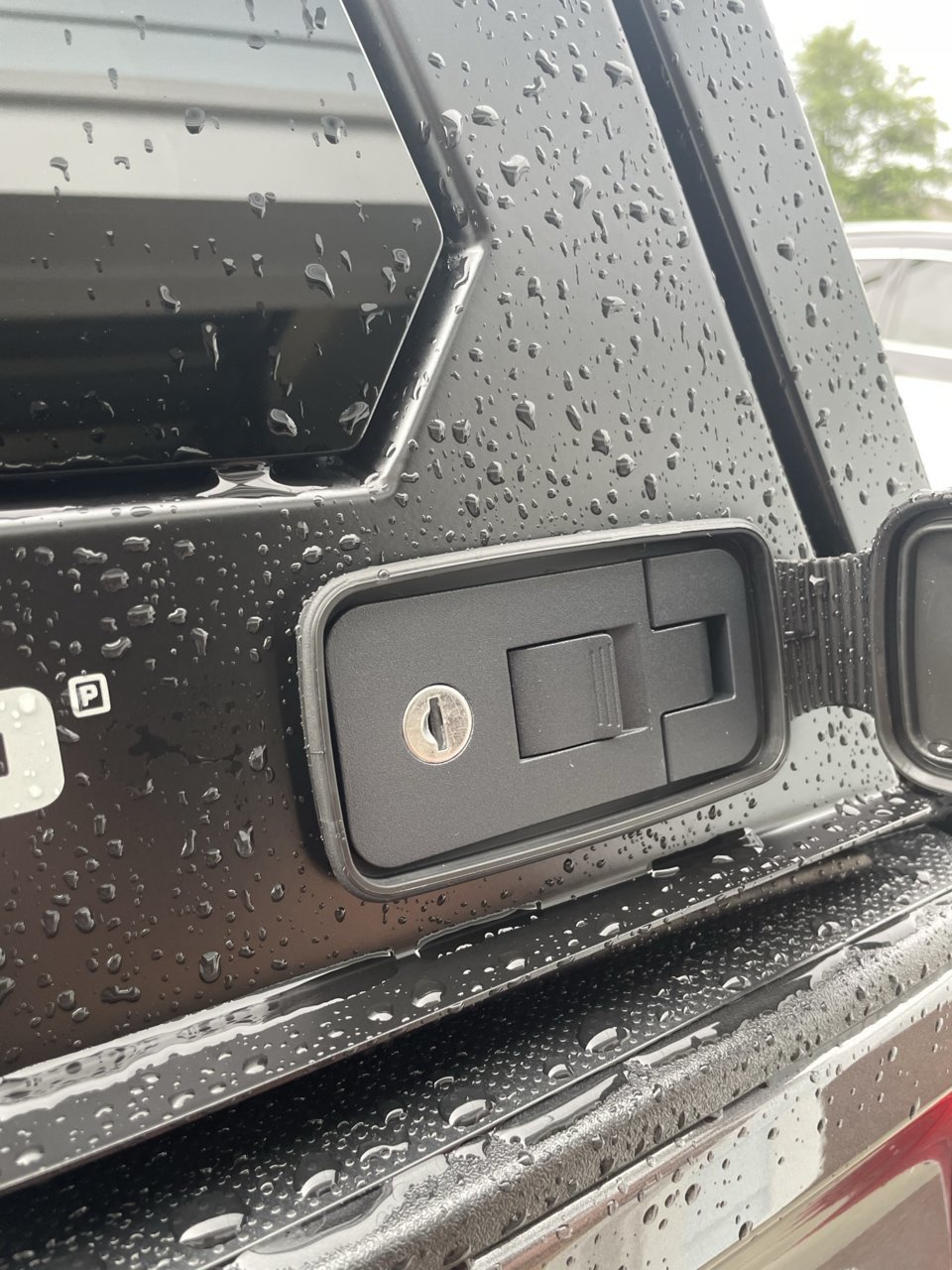

    FWIW - Put myself on the “list” / warranty claim for frozen locks / open from the inside etc. Coco (RSI) gave a detailed reply but did not give an eta besides soon. However I did get a package with 6 lock covers in the mail :thumbsup:

    Can I ask why haven’t you requested/ordered the ‘made for these locks’ covers? I didn’t have to get them directly from the lock manufacturer (but you could, I have a contact that could set you up I’m sure), I told Lionel about them and that they finally finished them - they gave up on them because it took so long and found those repurposed covers you currently have. he got approval to send me out the proper set. It’s night and day difference in every way
    edit: I didn’t know the revised latches would also be weathproof plus the internal latch function. I was under the impression that this whole time it was 2 separate parts. The correct cover would seal the lock/help from freezing and the revised lock would allow internal functions.
    either way I’m not interested in the internal functions so I’m set with just the covers.

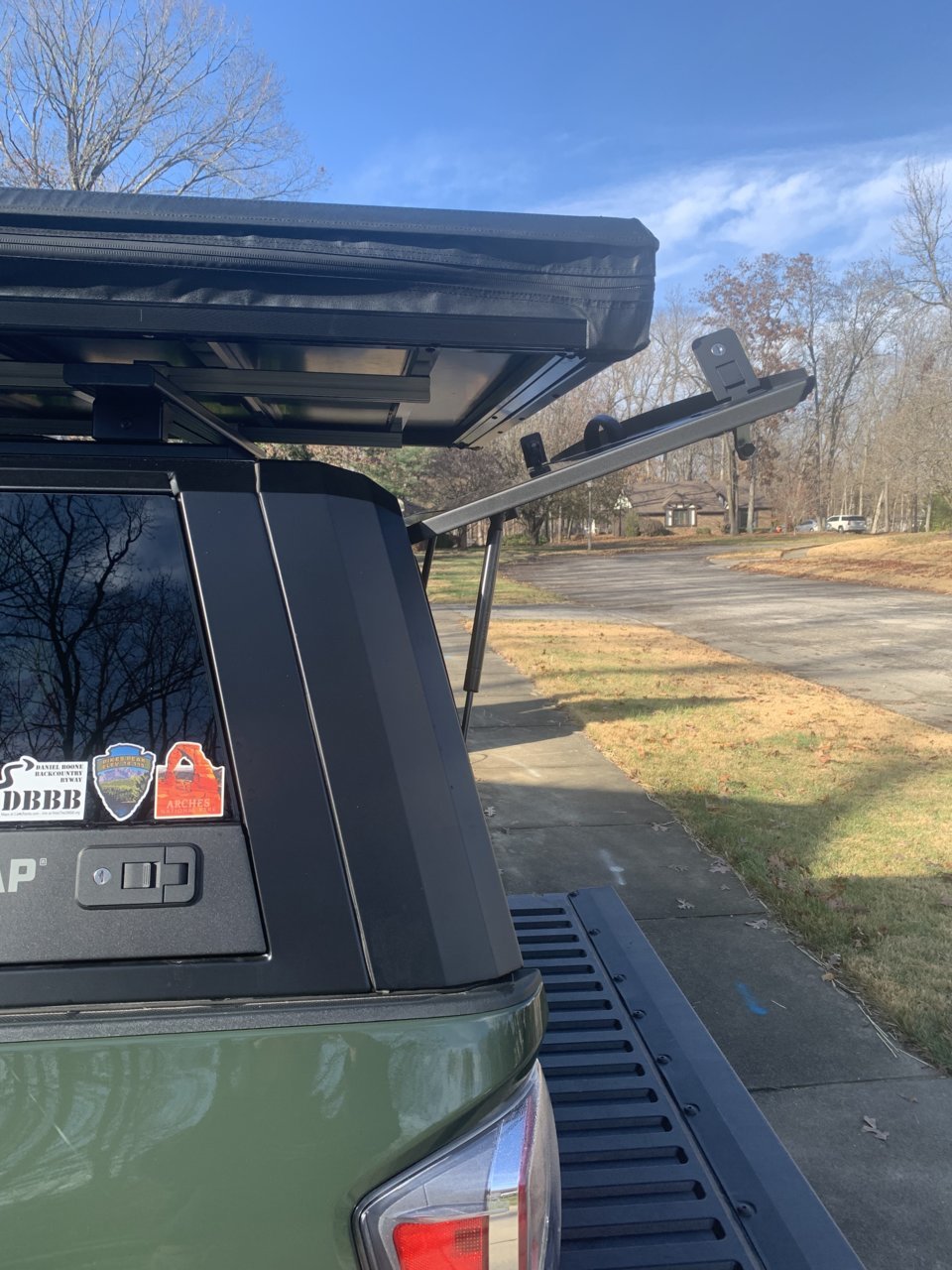

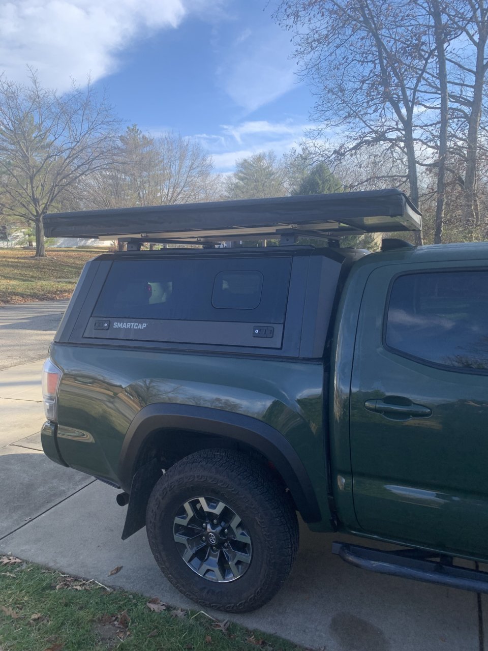

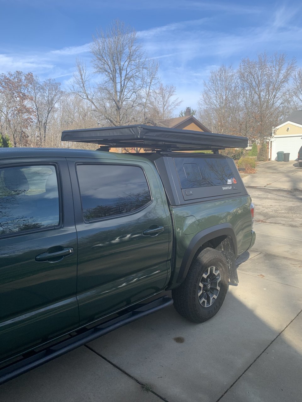

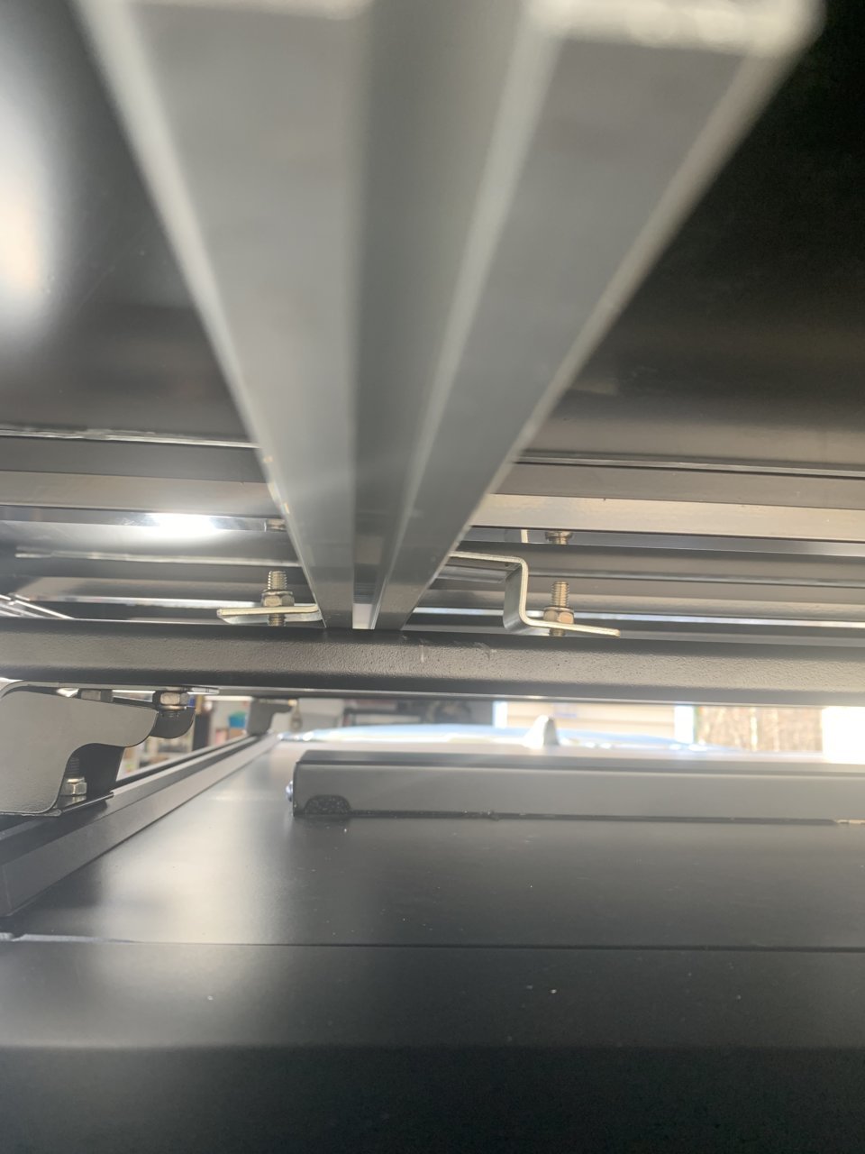

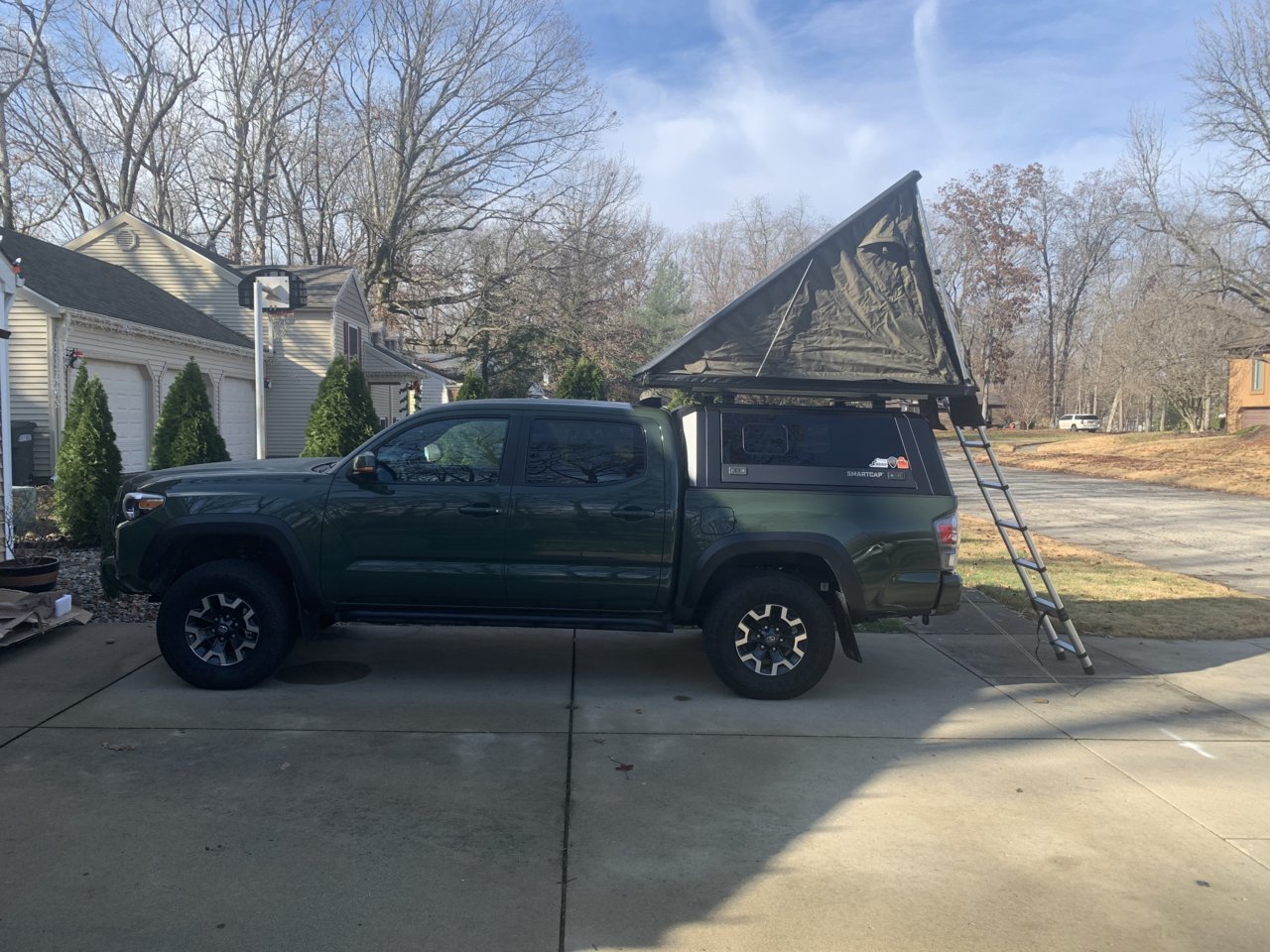

    Mounted my Front Runner load bars and the Inspired Overland RTT yesterday. This is the first time I have messed with either product and I am not sure that what I did is correct.
    First I removed the RSI nuts in the channels on the roof of my RSI. Next I put in the FR tabs with bolts and installed the load bars following the directions.
    The RTT did not come with instructions so that is where we started to wing it. The supplied brackets had a channel that was narrower than the FR bars. So we installed the bolt heads into the FR bars and sandwiched the rails to the RTT. It feels secure. Sitting in the RTT feels secure however it’s still new to me. I’m not afraid of heights but I’m up there.
    Regardless of me doing the install correctly my next project is suspension. I ordered a front bumper over Black Friday and that will help get the front end down a bit but I still need an upgrade.

    I’m not familiar with that tent but I know for sure that most if not all tents brackets like that go UNDER the load bars and the bolts go in the channels of the tent bars. This will clamp the load bar to the tent bar and will not move.
    Also note the front runner load bar weight capacity. I don’t believe it’s enough for a tent and people inside. Max load in the bars is about 220 lbs or so.

    He is right about the tent mounting brackets. The FR load bars are rated for 220 lbs dynamic ie driving around. So as long as your tent is about that you are fine. We have been using 2 bar setups for years on lighter tents and have been fine. That being said my bush company tent with gear in it is 220 lbs and the awning bolted to it weighs another 80 lbs. In those instances we use 3 bars. He will be fine with 2.

    The tent weight is 87 pounds. I don’t currently have anything else in it and no awning. I’ll look more at the mounting hardware.

    Looks great though, congrats

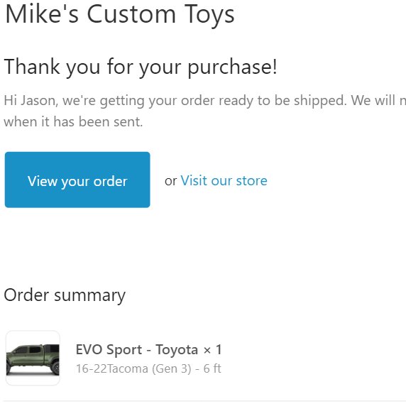

    Thanks MCT! Now I'll be re-reading this thread for tid bits of info. Looking forward to the order and new latches!

    I have different mounting brackets inbound. Ones that will go under my FR load bars and attach to the extruded aluminum on the bottom of the tent.

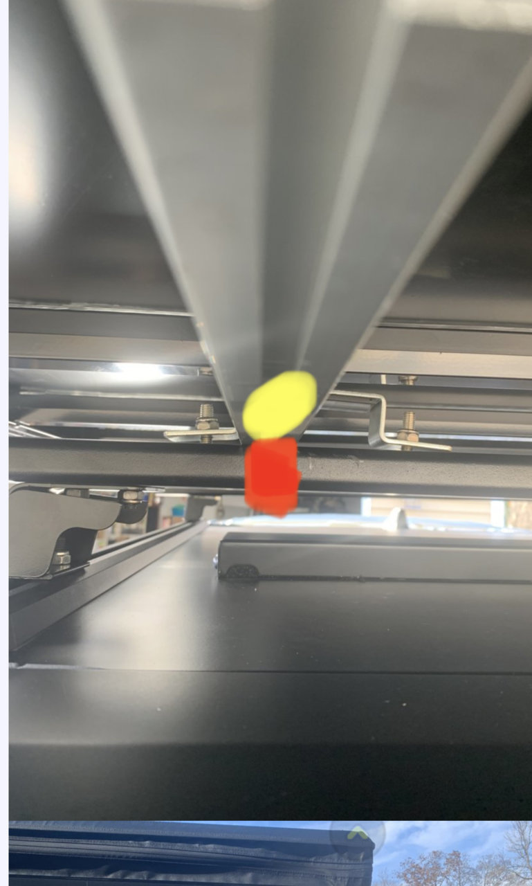

    you don’t need different brackets you just need to flip them under the bar and move the bolts onto the other rail. Put the bolts on the rail with the yellow and run the bracket under the rail marked with red. 1B82404C-C290-4833-94DE-08B326BE0AF7.jpg

    They won’t fit flush around the FR load bars the ones that are inbound will fit around the FR load bars.

    That’s exactly what I explained too but I think the front runner load bar might be too wide for the bracket.
