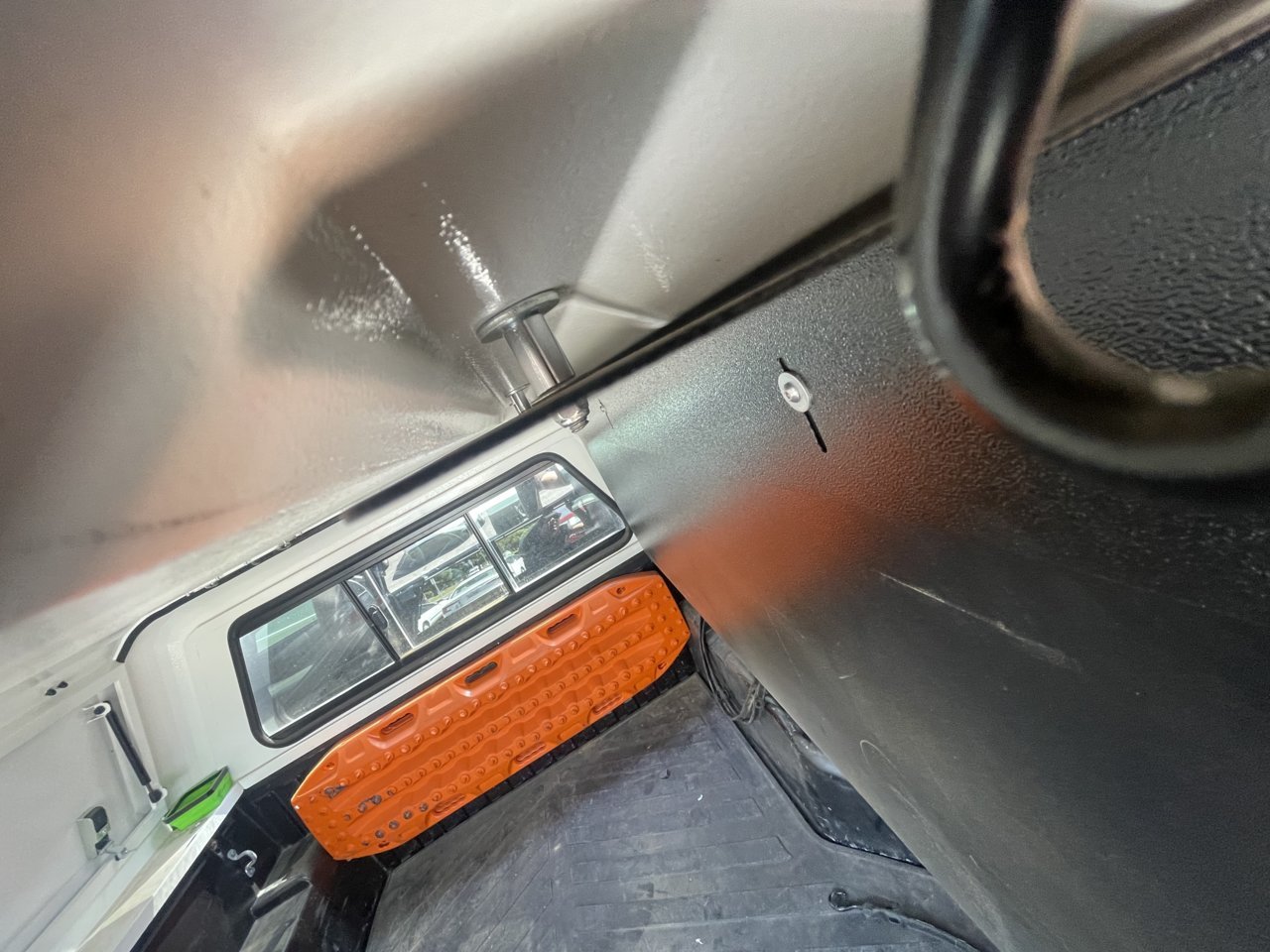

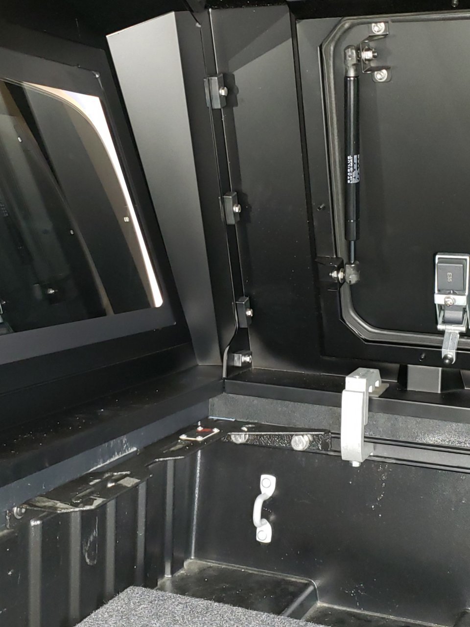

    Here are the pics. Also, note the location of the clamps in the front. For those interested in front tie downs, stiffeners, etc., you have 8 inches from the (inside) front of the bed to the clamp. Just FYI, and note sure if this is a change from prior versions.

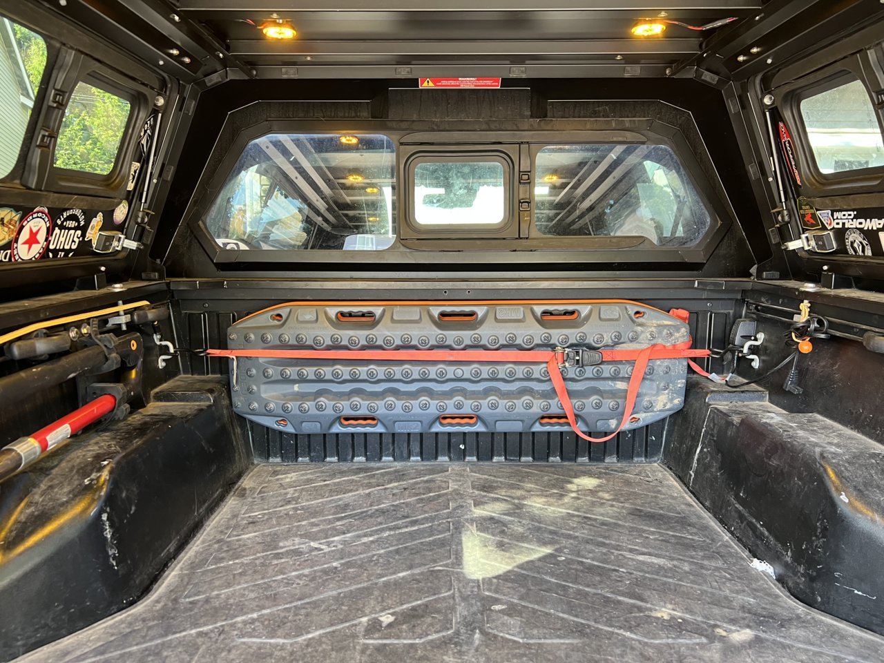

    Several pages ago someone posted about a solution to attach traction boards to the inside top of the Smartcap. I remember seeing it, but cant find it now that I'm looking for it.

    Why not just mount them at the back of the bed? Nice and out of the way.

    Currently I have a set of Bam Beds in the bed. Don't know if I am going to keep those, but with them in attaching to the rear isn't an option. Just putting them in the bed now works, but isn't optimal.

    Yeap, best spot for em. I have 4x mounted here via a 3d printed mount from a member here i bought some years ago.

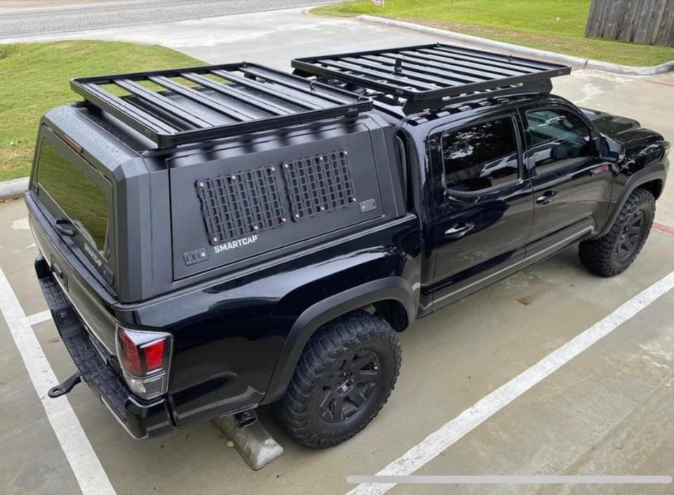

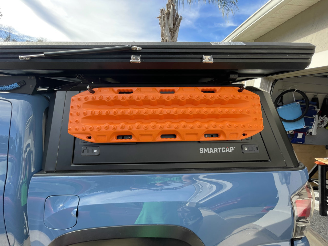

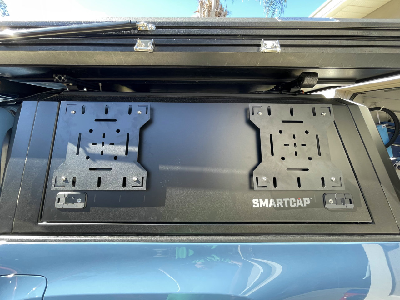

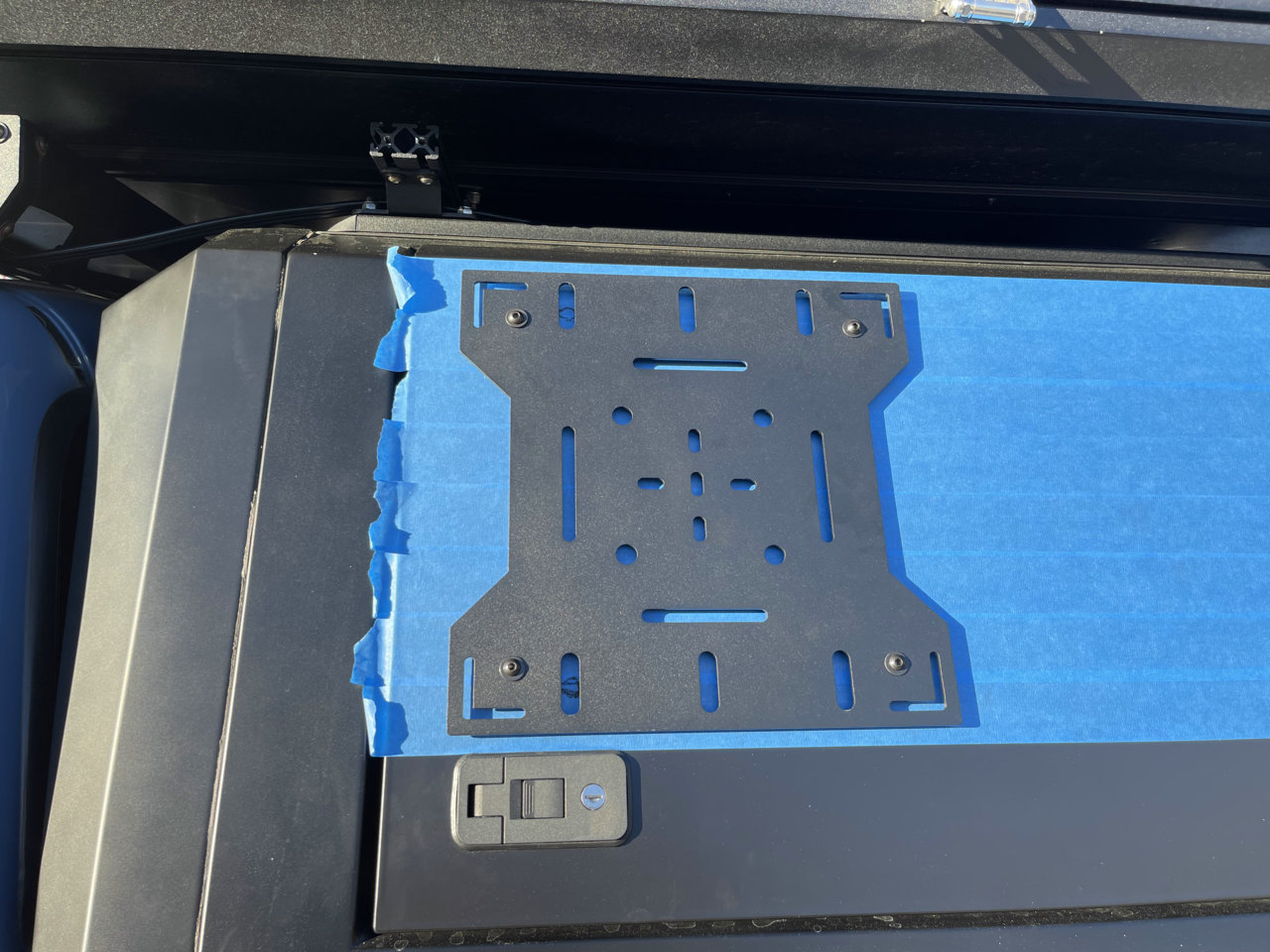

    Want to do the same to mine. I noticed the gull wing doors feel like two layers of thin steel and hollow in the middle. How did you mount the hardware? Did you drill through both layers?

    No, I just drilled through one and put in rivnuts but I wish I had gone through both. I will be taking the rivnuts out and replacing.

    I saw another pic like that:
    Not sure if I got it from here or FB… :anonymous::facepalm:

    That's a picture we have on our website that was taken at our old shop in Houston. Those are the BuiltRight universal molle panels. For installation, the mounting holes were drilled through and bolted with 1/2" nylon spacers to avoid rubbing and corrosion.
