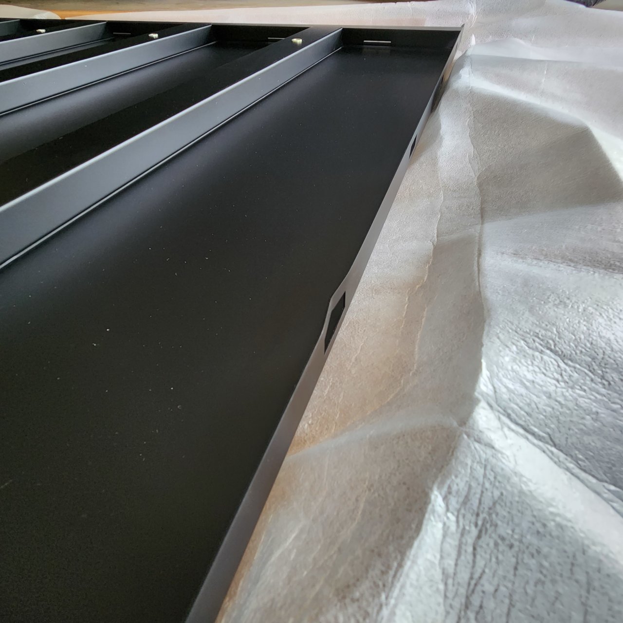

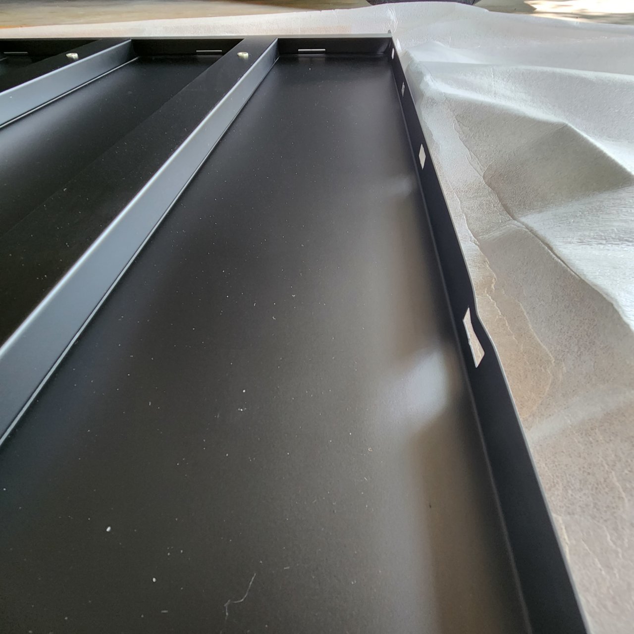

    Question...so i am inspecting my SmartCap...this one panel slot seems to be bent or perfectly made bent for the front window panel. RSI says inspect but doesnt offer a QC reference while inspecting. Thoughts? To me...this is bent

    Yes, that's bent, contact customer service and send them the same photo.
    Not sure if it'll affect the integrity of the shell, though.

    Im tempted to 1. Proceed with install. 2. Attempt to flatten and install.
    Frustrating when you spend 4k on this and find minimal damage after waiting 6 months for delivery. Dont want to wait for a new roof.

    I had two areas like that. Once you get the clips in and tightened to spec, it seals up. I have no leaks in those areas.

    Good to know, that thought briefly crossed my mind. The metal in this area im concerned is "weak" so a silly attempt by me to flatten it would make it worse. I think ill go ahead with install and see if it becomes flush.

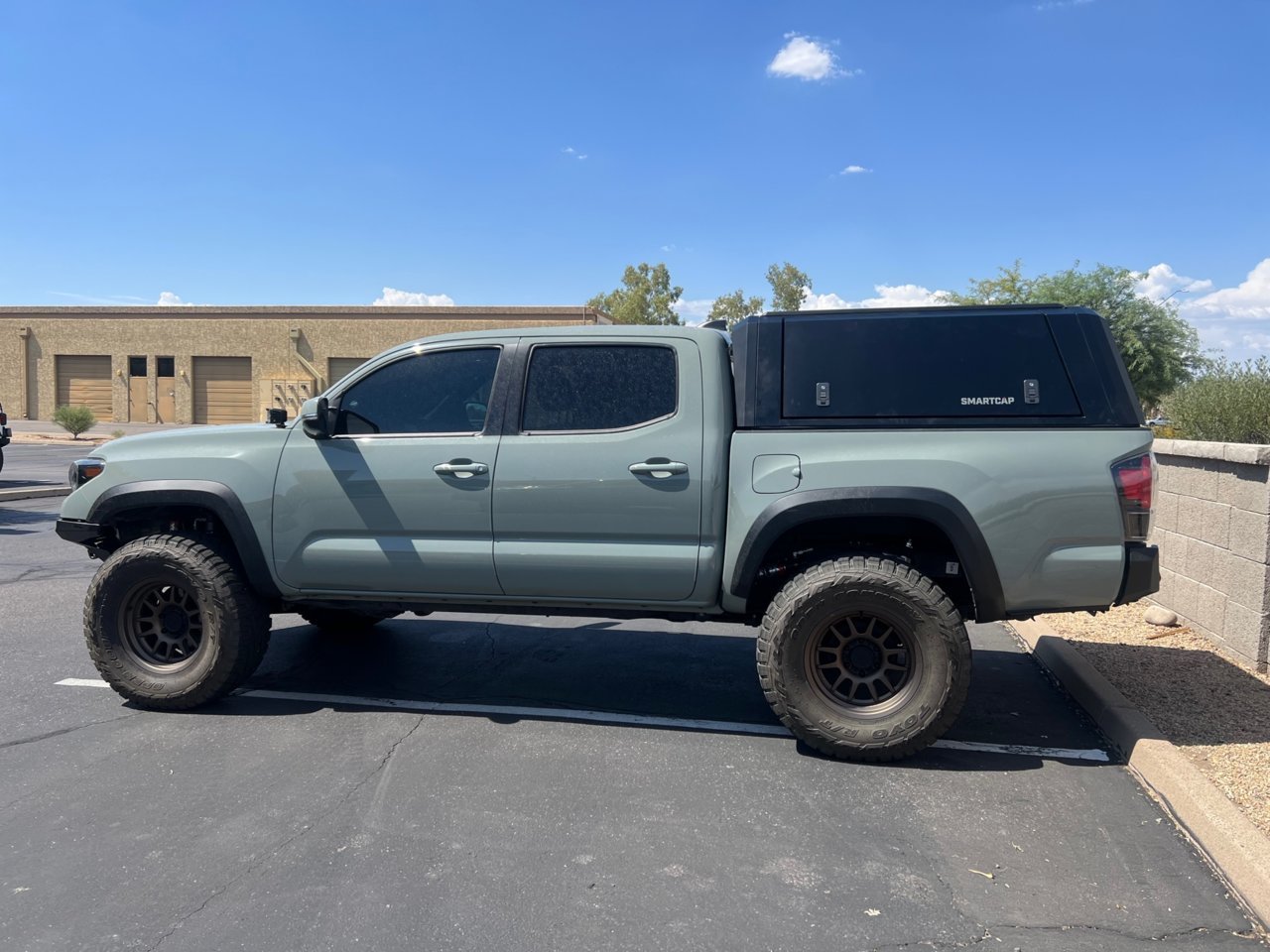

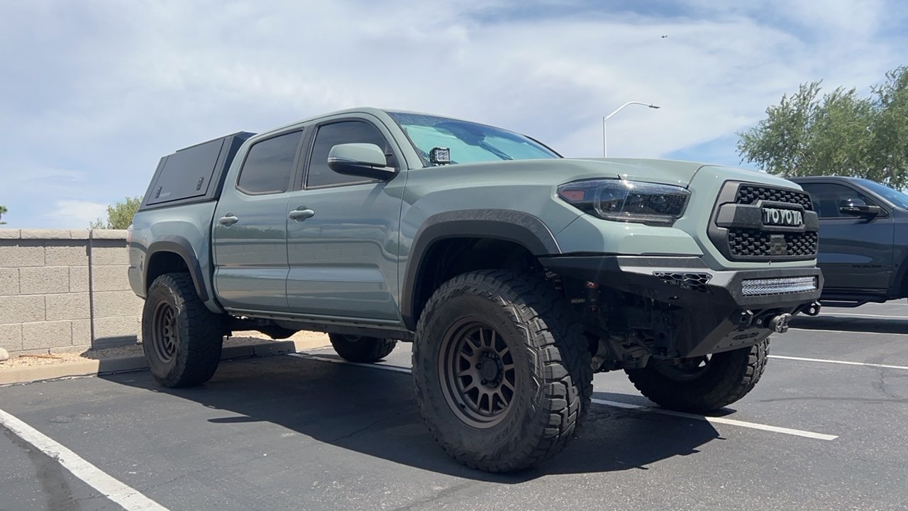

    Finally got the smartcap on just in time for monsoon season. The latches definitely get scorching hot in the Arizona sun

    Mine was bent in the exact same way. My assumption is that the powder coater hung the panel by that hole, bending it. It will completely flatten to shape when you assemble it. I'd just bolt it all together and enjoy your canopy.
    @Mike's Custom Toys has assembled a ton of these... I'm sure they could weigh in on this.

    Yeah almost every roof panel has one of those, straighten it and assemble it will be fine.
