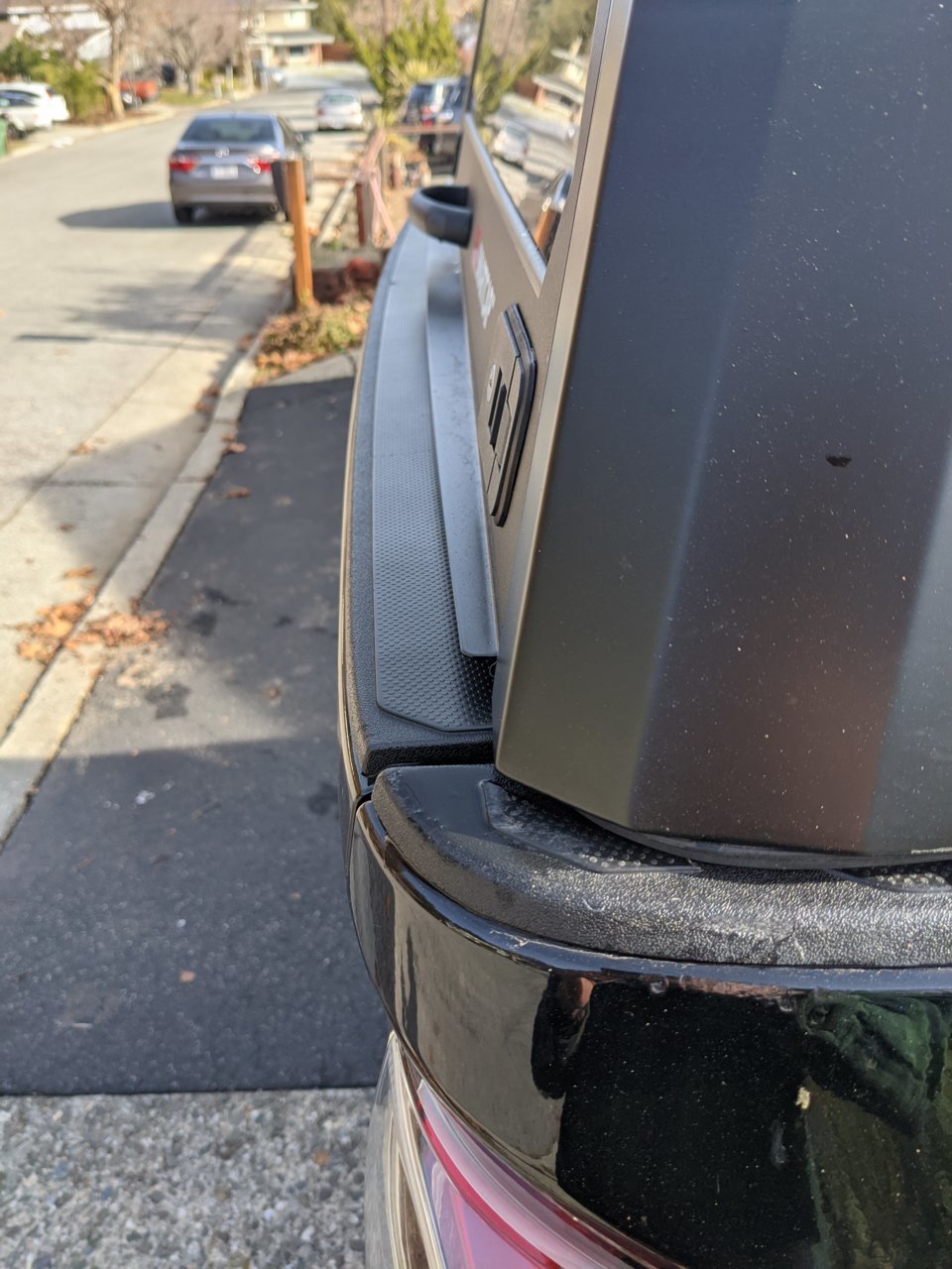

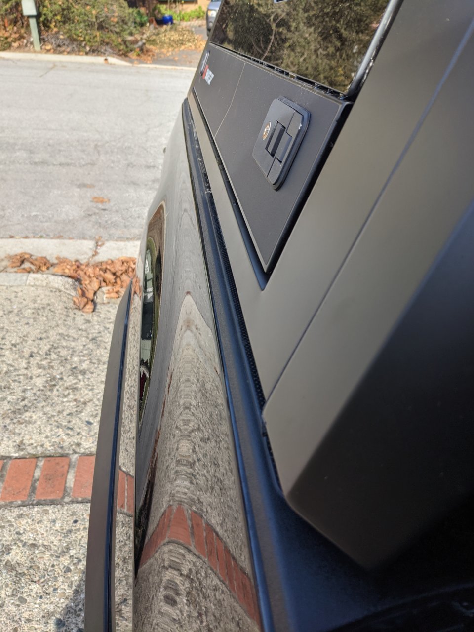

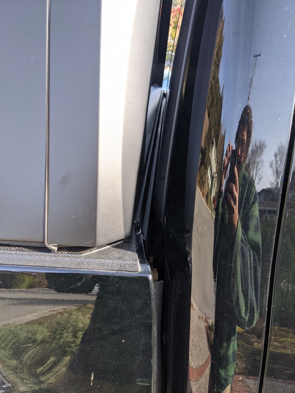

  11. Dec 23, 2020 at 12:18 PM
    #351
    Relyk711
    Relyk711 Well-Known Member
    Apr 11, 2019
    #289848
    258
    Kyler
    Santa Cruz
    2018 TRD Pro Black - 1999 Pre-Runner Black
    Alucab Canopy Camper BAMF HC Dual Swingout Rear bumper BAMF Sliders Westcott 1.5" TRD pro lift Icon RXT option3 leaf pack Rago HD Shackles & Hangars BFG KO2 285/75/16 CBI T3 Aluminum front bumper Warn EVO 10S Total Chaos Bed stiffeners Home built Aluminum HDPE bed platform.
    Front rail about 1/4" exposed
    Sides sit almost flush with a small gap between the bed rail edges and the bulb seal. RSI recommended putting the seal 1/4" from the edge and I think mine ended up being more like 1/2"PXL_20201223_200709049.jpg
    Rear profile, there is about 1.25 inches exposed on the tailgate but it doesn't feel out of place and isn't even really visible unless you are standing over the tailgate.
    I originally had it flush with the front rail but since moving it back it sits better. The seal on the rear window sits perfectly in the low notch on top of the tailgate and seals it nicely. It probably also helps the seal wrapping around the sides not wear out from rubbing as much when opening the tailgate.
