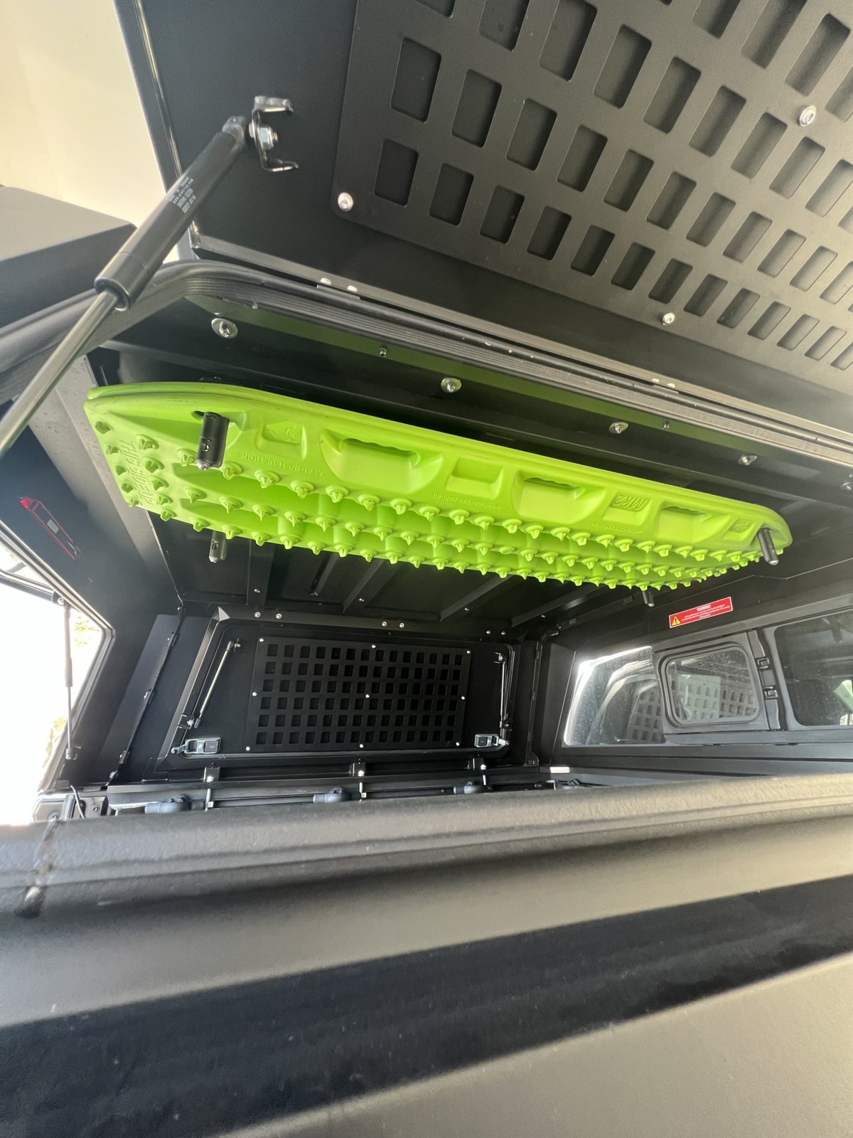

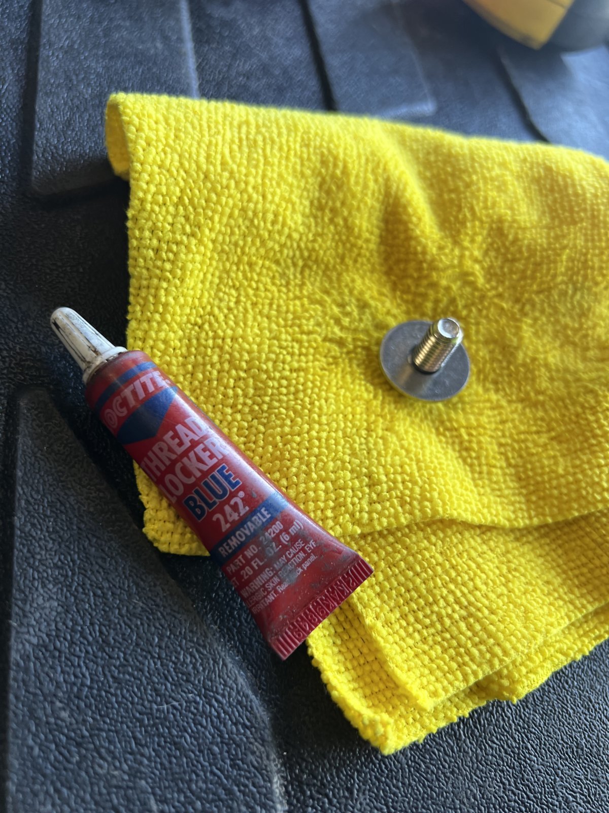

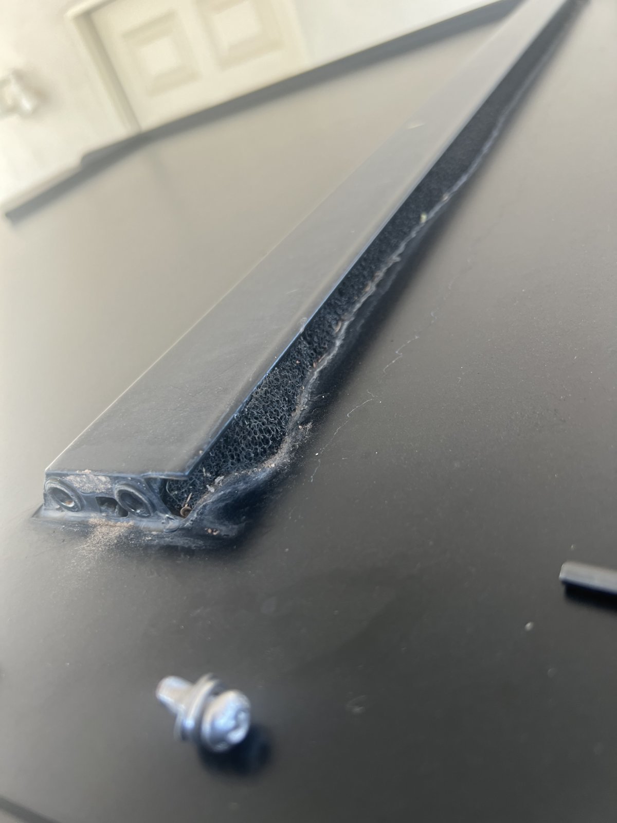

    I went through the entire topper today, touched every bolt. I adjusted my latches and got them all feeling nice and tight again.
    I took apart the positive pressure vent and washed the filter with soap and water. There was a decent amount of debris trapped in there, so I’ll probably service the filter more often. The inside of the topper still gets a bit dusty but the vent does seem to help.

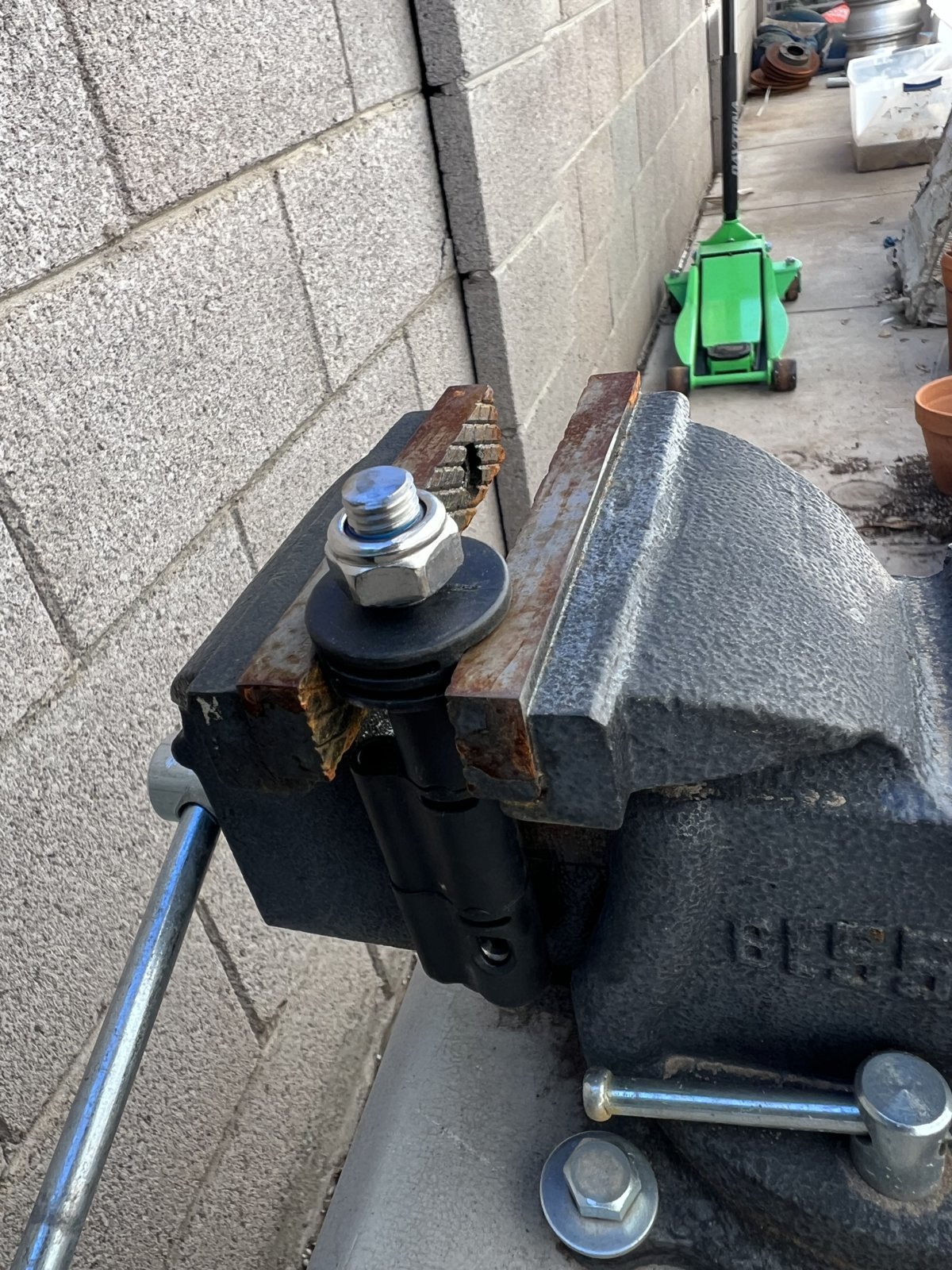

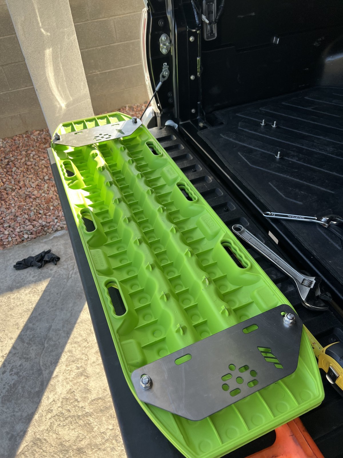

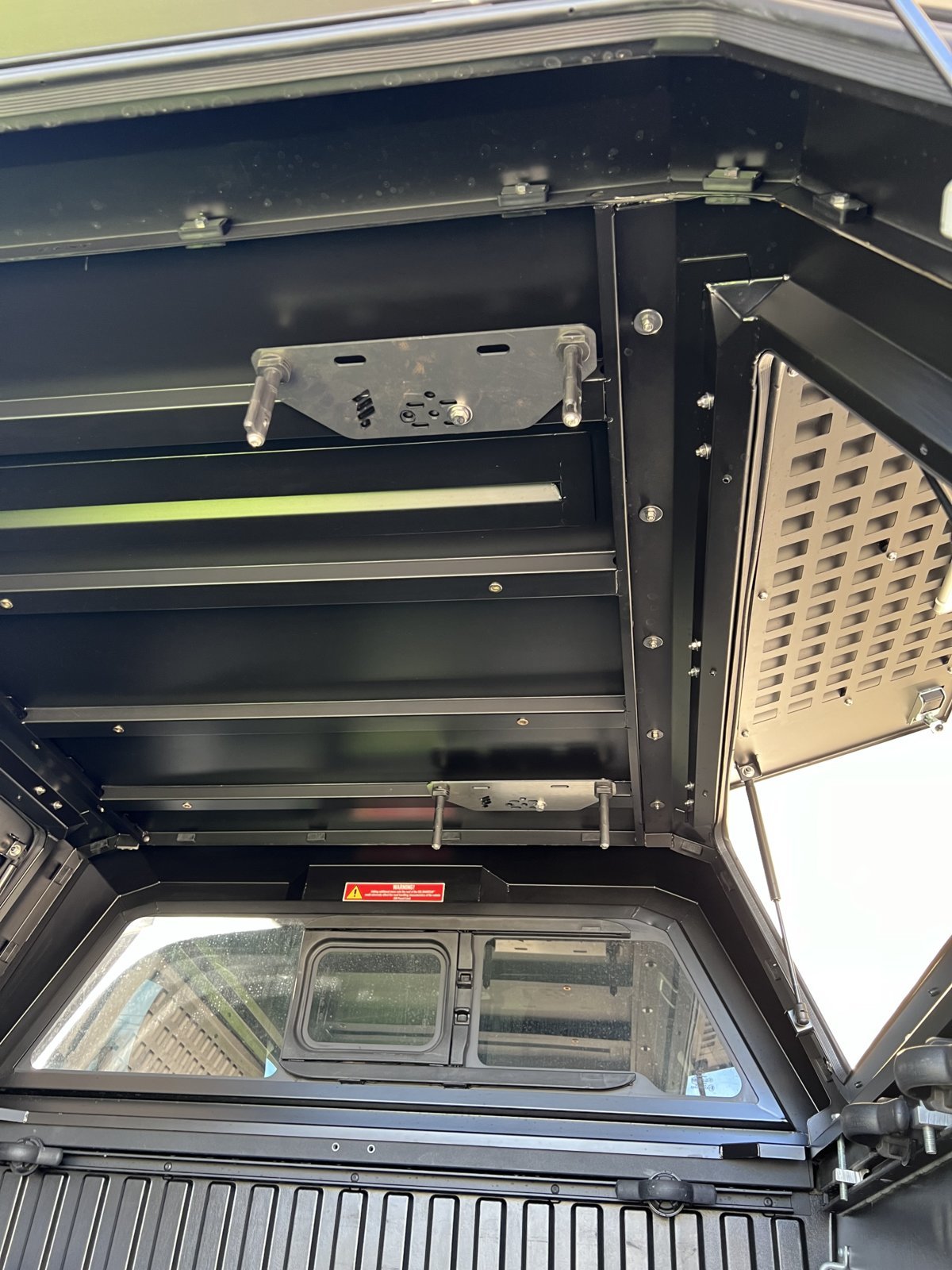

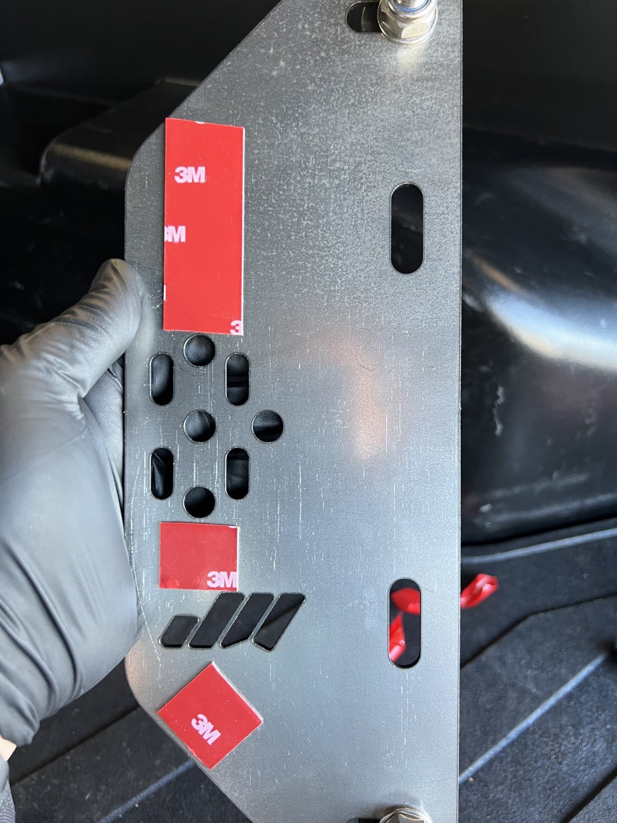

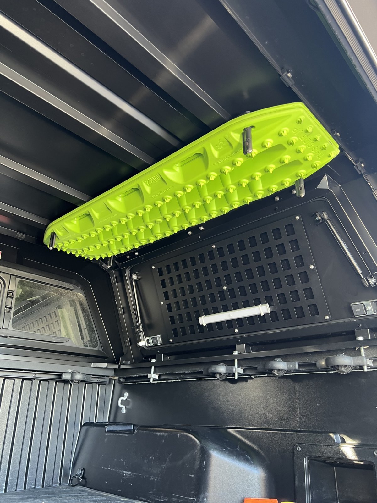

    I finally got around to installing my MaxTrax mounts on the inside roof. I opted to not paint them and just let them patina since I will never see them under the boards anyways. I trimmed the threads on the pins to clear the topper roof. Used 3M 2-sided tape to help support and isolate the bracket from the topper. It also helps with preventing the bracket from rotating since there is only 1 bolt on each of them. It turned out pretty good and gets the boards up and out of the way in a space that was otherwise not utilized before. The boards and mount feel pretty solid but time will tell if it holds up.
