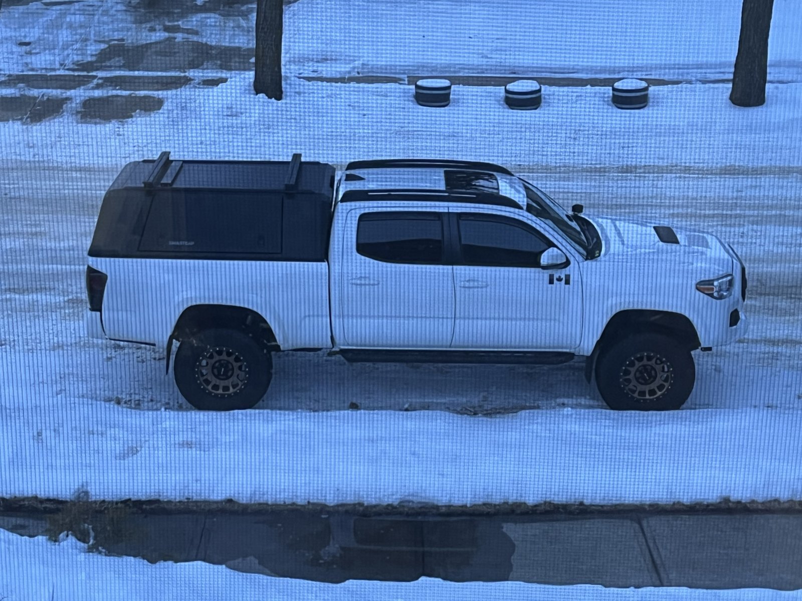

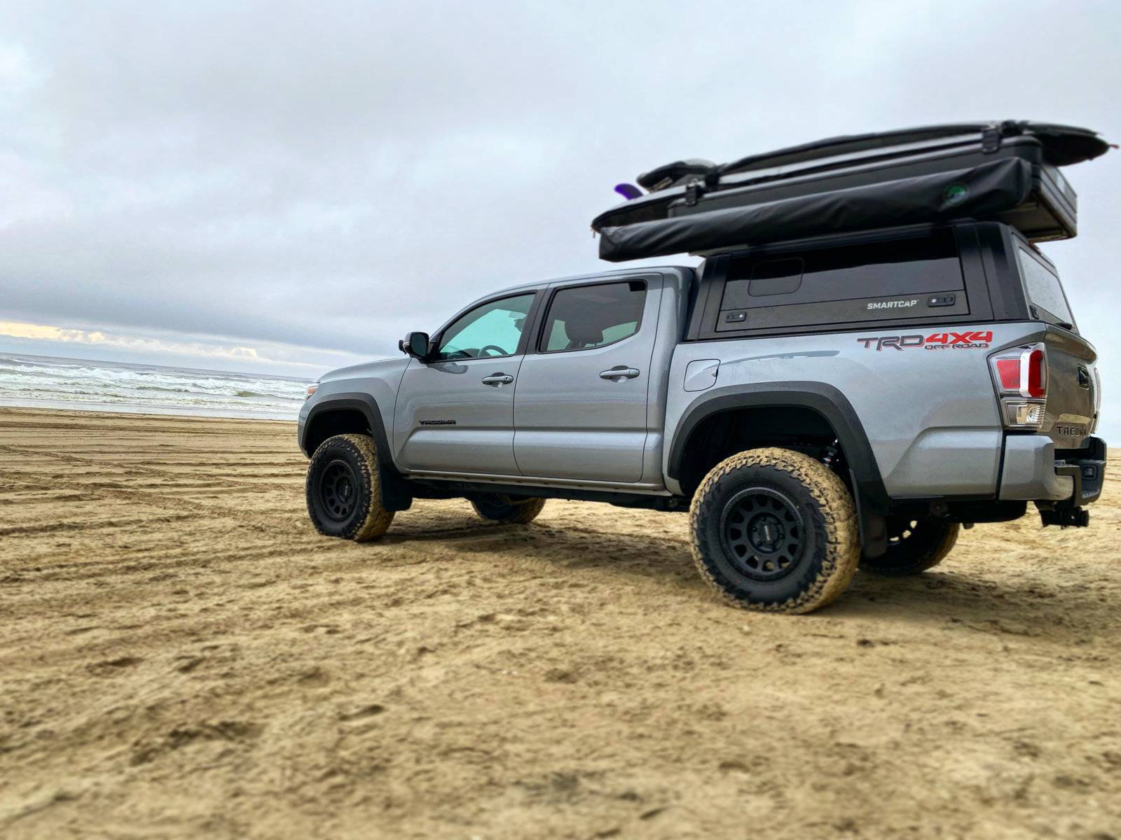

    This is my setup. The gull wing stops within a mm of the tent on one side. I run an awning on the other.

    How’s your awning mounted?

    My 6’ is a perfect length. Flush up front with that header bar and about 2” of coverage on tailgate. No water is getting in around that.

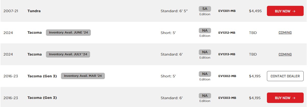

    The RSI website now has the option to buy the Gen 3 Smartcap Sport 6 footer directly from them (i.e. there is inventory or will be inventory shortly).

    Yes, the 6ft caps have been built and there will be an excess. Backorders are shipping out every day. 5fts will be coming shortly.
