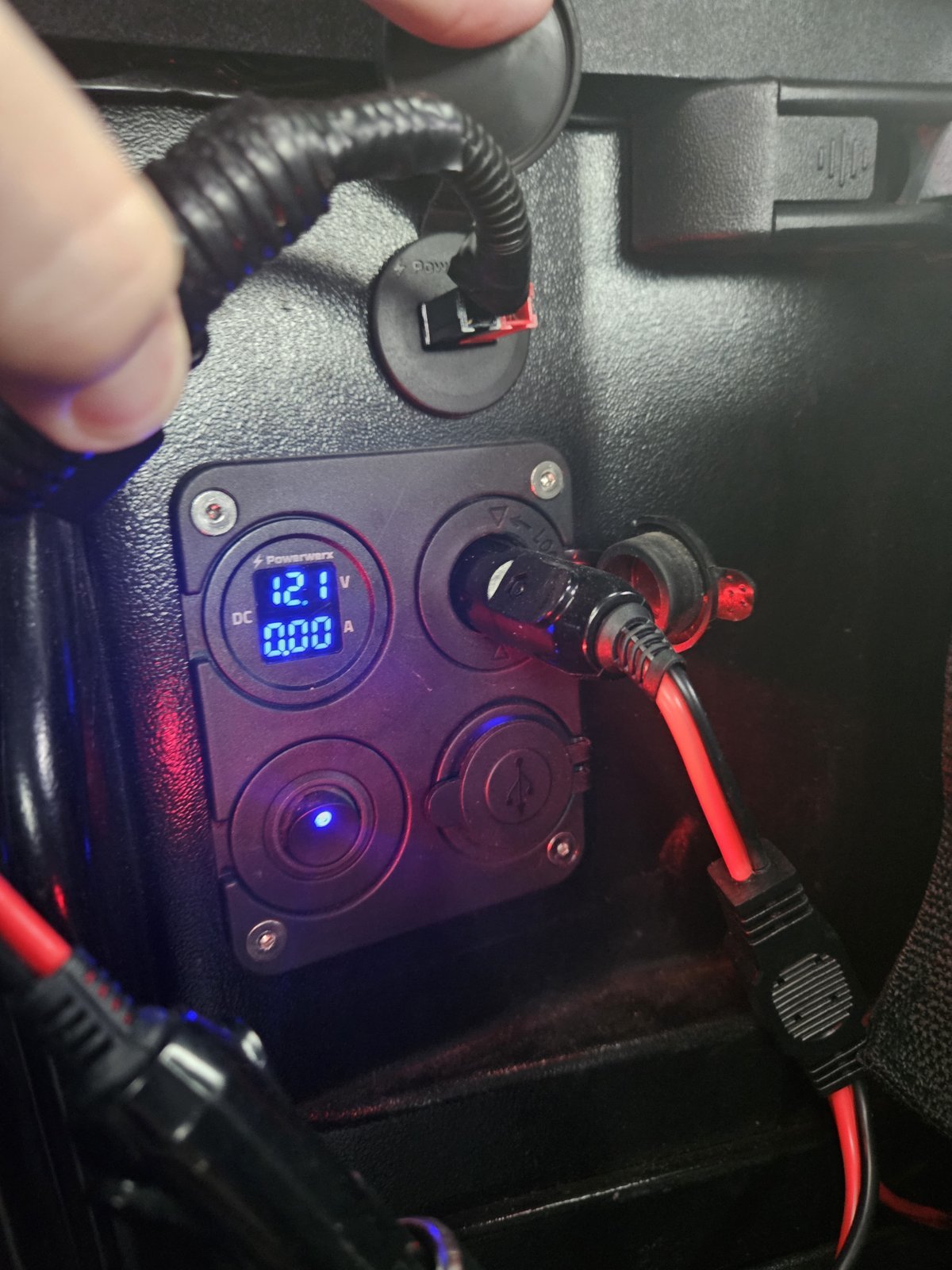

    I plan on using an Anderson plug to transition from the bed to outside the bed, like I did for the brake light. I'll replace the current single port Anderson plug with a dual port.
    I get all my DC stuff from Powerwerx
    https://powerwerx.com/dc-power-products
    Edit: the ground isn't hooked up for that Amp meter... hence the 0's.

    I love the flush sockets. I have a blue sea surface mount I haven’t installed yet. Might look that one up though, I have an ARB socket that does direct connect to the fridge. But have yet to run power to the back so all useless for now.
    No dome on the RSI?
    The Anderson connector looks like a good whack with a cinder block would do some damage but hard to tell. The Deutsch plastic feels like it might survive an impact with something heavy. But of course always can be replaced / repaired.

    Yeah, the Anderson might not be the most robust for real truck use, but I'm a pretty gentle dude, so I've had no issue.
    I have (4) KC cyclones installed for domes. That's what is plugged into that cigarette port. I have them installed with magnet bases, so I can pull them out for camp lighting. I have a few revisions to make to them, but generally I really like the function.

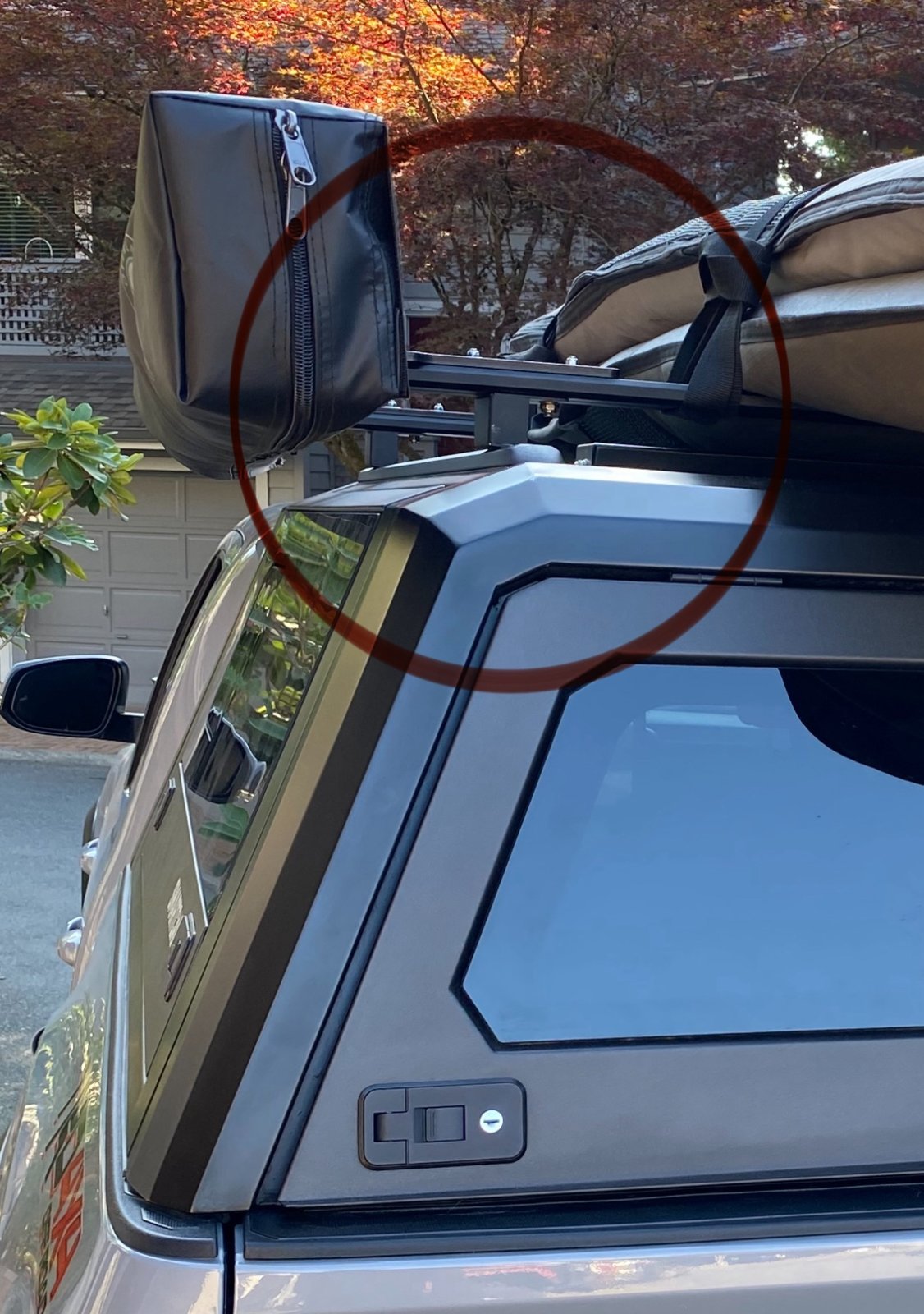

    fair enough. I sort of figured. Ok; I dug a bit for a photo. As you can see the awning has a 90 degree heavy duty bracket. It mounts first to the back of the awning. Then it sets on top of the rails of the smart cap.
    prior to putting the brackets on the rail, you drop in and slide a couple of M8 bolts. Or as many as you want and need for your setup.

    Th
    thanks. Now that I see how it’s mounted I can do some awning bracket research
