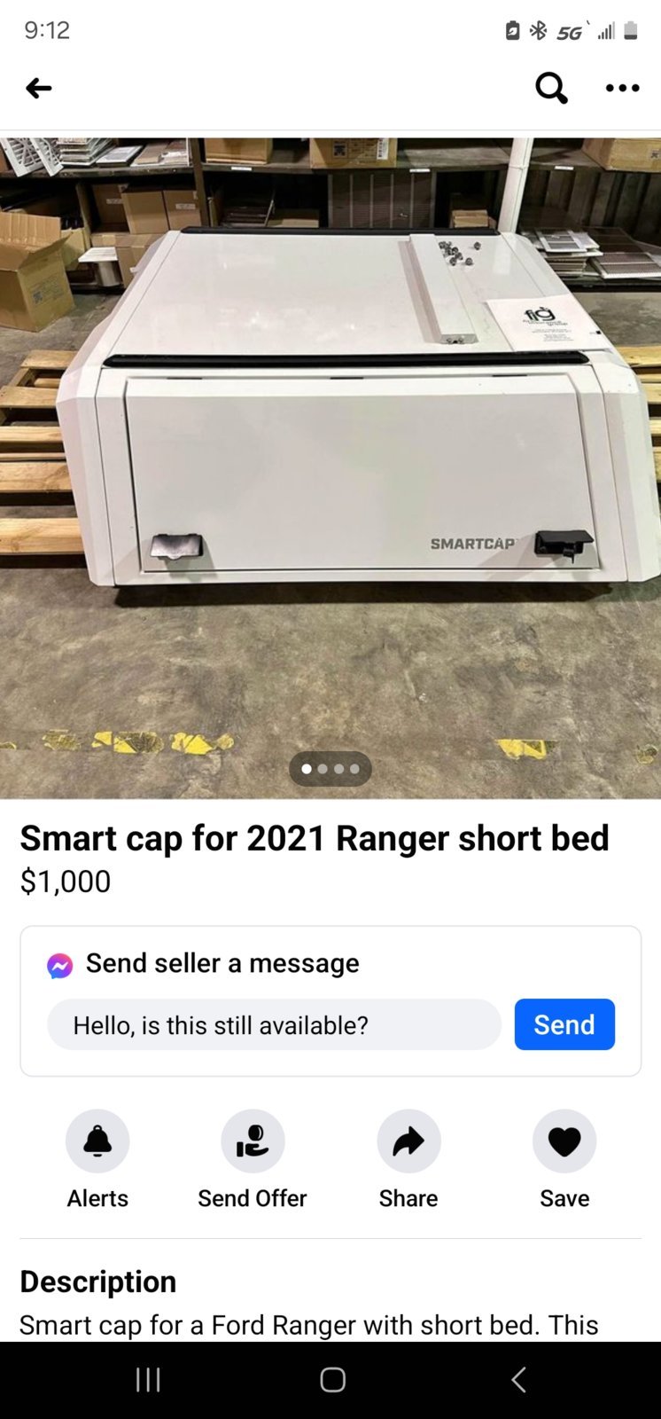

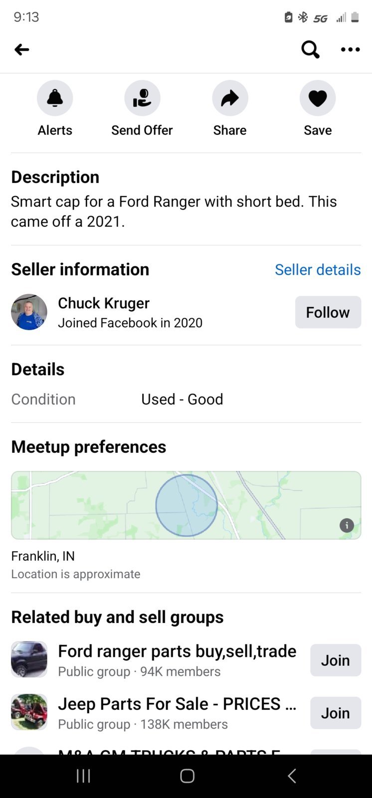

    Should be close enough to the tacoma bed for 1000 hard to beat

    No the ranger is too narrow and uses a bed specific mounting system

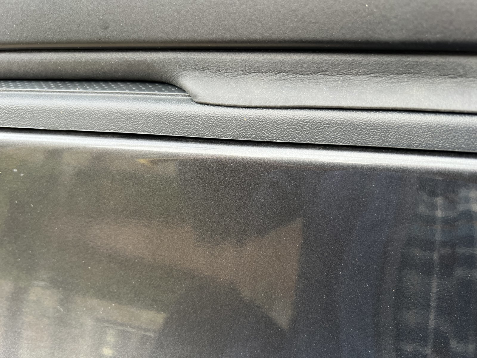

    No Sir, according to the instructions on pg. 19 Step 33 the rubber lip is supposed to be tucked underneath the cap.

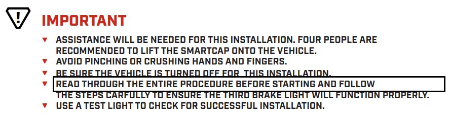

    Yes Sir. Cannot deny that. It was a double whammy for me.
    I failed to read the entire procedure before starting, and I missed the comment about the lip.
    On a positive note: It's been raining for 2 days now, and no leaks through any of the flanges...yet. I get a little bit of water through the infamous gap at the tailgate (both sides). Will work on that later.

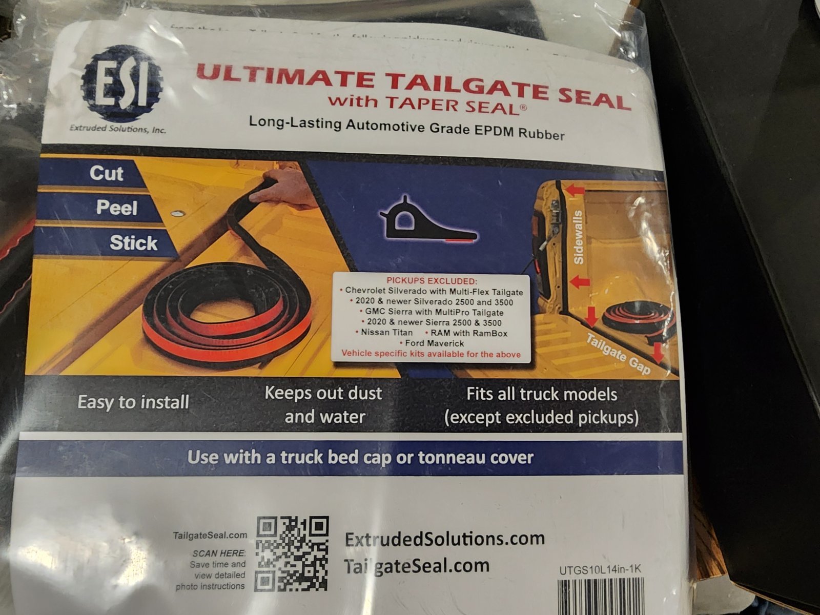

    I'll probably be driving in some dusty areas this weekend and hope the positive pressure vent will do a good job. Then hoping to install this around the tailgate later.

    Please share what you've done (with pictures).
    I have some D-rubber left from the installation that I can experiment with. As others have previously pointed out, there is a gap in weather stripping where the D-rubber ends on the Smartcap and where the weather stripping on the rear windoor begins, which is where rain is entering.
    If I could do it again, I wouldn't have done a straight cut of the D-rubber per the instructions, but rather cut only the "D" part of the gasket and leave some amount of the lip overhanging. It wouldn't have made it weather proof, but I think it would help a little.

    I used the same thing it was pretty effective everywhere but the gap where the truck bed and tailgate meet. I'm going to use some tailgate gap seal for that.
